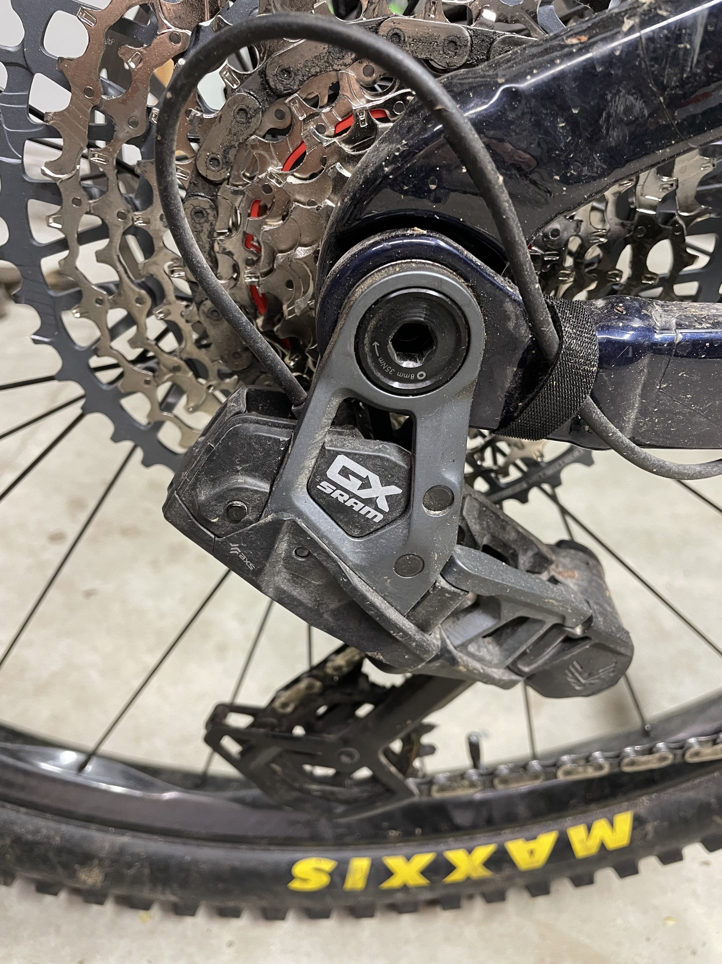

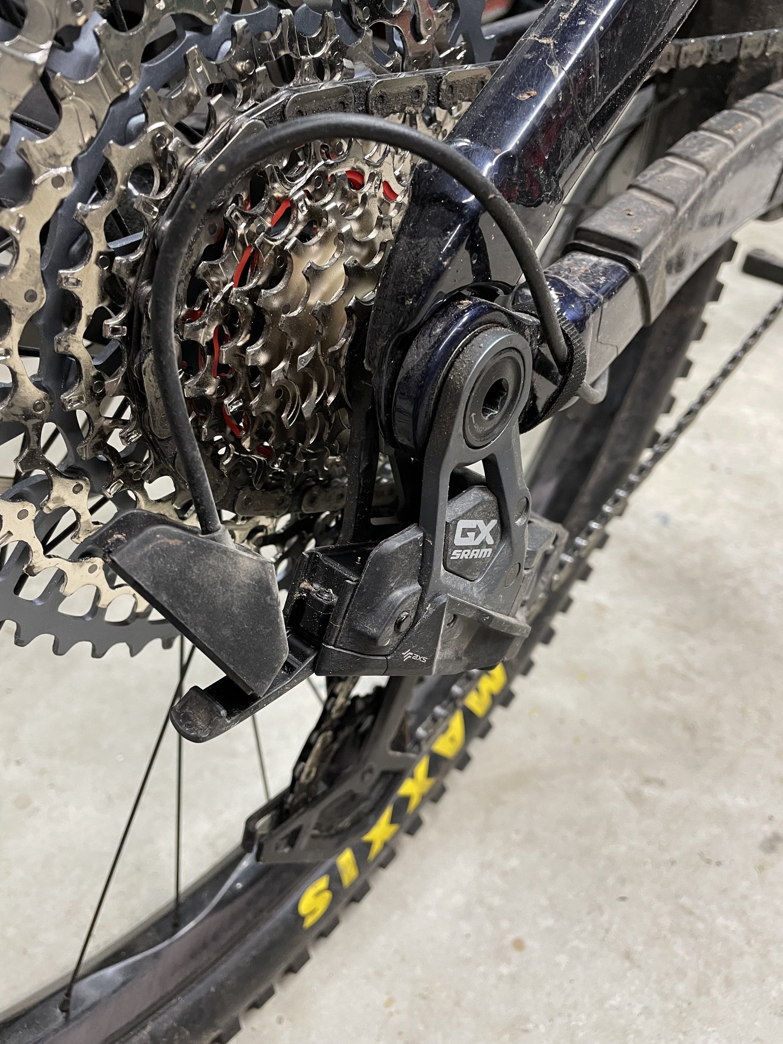

This is a common issue with the GX derailleur, the battery sits flat on the pogo pins so any water that gets in there doesn’t drain away and eventually corrodes the pogo pins. SRAM has been replacing them under warranty for original owners for a while now. My mate has been buying up “broken” GX derailleurs, replacing the pogo pins then reselling them.

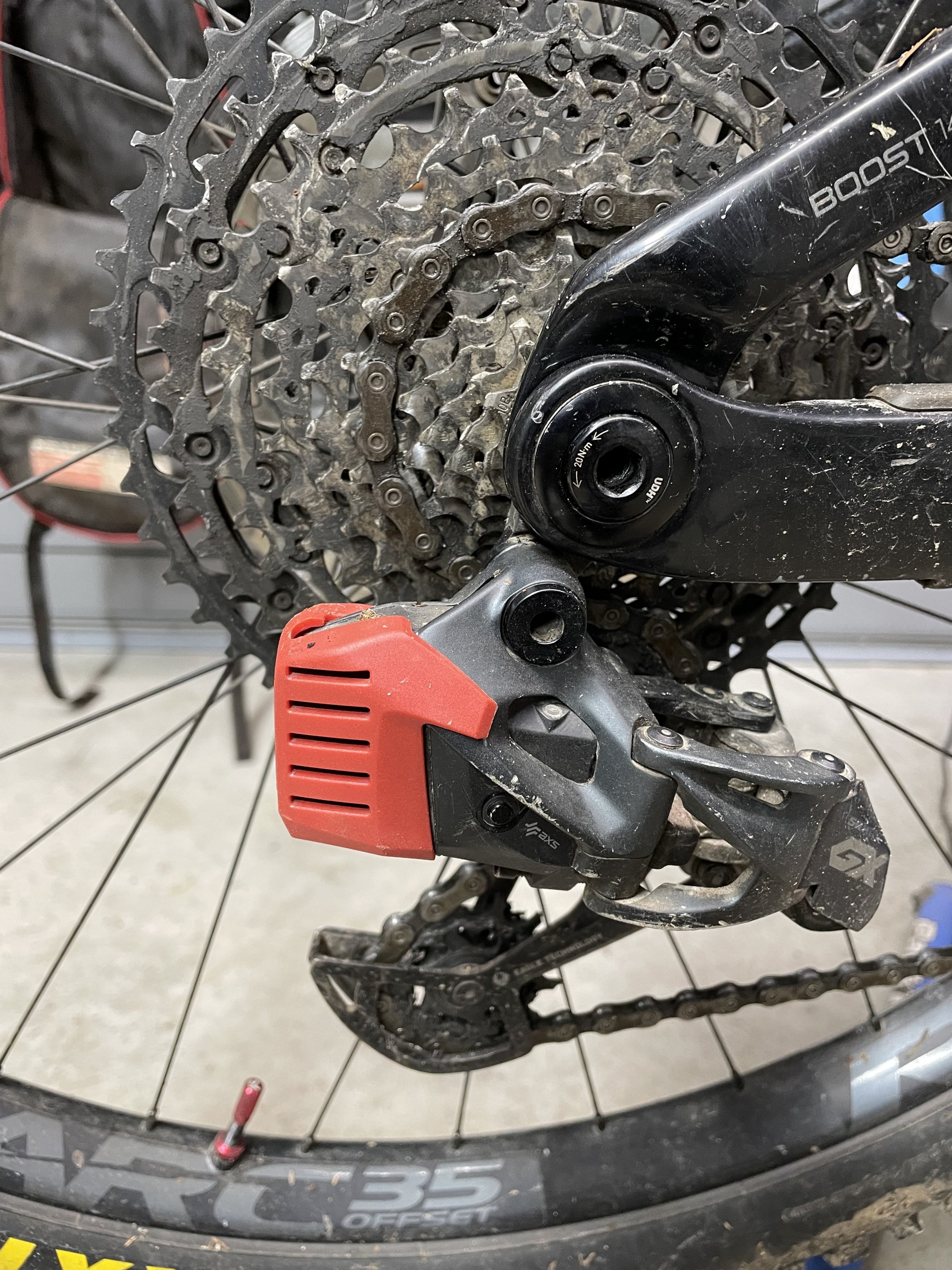

This is the position or orientation that my AXS GX battery lives all the time. Vertical. Whether it’s in 1st gear or 12th gear. When I charge the battery I always brush or clean the battery holder. I don’t recall if I’ve ever seen water in this area which could affect the pogo pins.
I’ve never lost a battery on the derailer or reverb dropper …but I did lose the original battery cage during a crash once. I replaced that with a tighter fitting red one for about $10.
This sounds like something I could do quite easily …
That GX derailluer is fine, there’s no issues with that one. The battery is horizontal on the GX transmission stuff, water can’t escape and it corrodes the pins. The video that was posted was about the transmission, not the older AXS eagle stuff. Honestly I prefer the AXS eagle stuff, it shifts a good bit faster and worked better on my levo.
Maybe I don’t understand, or haven’t seen, a horizontal sitting AXS battery. I can certainly see how this could become a problem with the pogo pins.
Could it be the type of derailer hanger?
My T-Type AXS battery (location ) sits vertical also.
Edit; wait…it’s not. It’s almost horizontal. The pogo pins are still a factor but there is a slight slope to the battery holder. My power comes directly from the main battery so I don’t remove the power very often …or ever. I recognize this as a potential problem but a small amount of dielectric grease ( or something similar)in this area may reduce failure.
This area is still dry and clean even though I ride in all weather conditions.

The battery sits vertical on the XO and XX derailleurs but is horizontal on the GX. It’s a different design so it could be made cheaper to meet a certain price point.
Well, that’s not good. I had to have a Quick Look at my Fuel EXE which has the AXS GX T-Type derailer. I would consider the position to be horizontal with a slight slope down towards the front of the bike.
After seeing this I might consider some dielectric grease in this area. The pogo pins seem good though …so far.
My mate uses dielectric grease on his GX derailleur and it’s survived the weather up here in Scotland so far. It’s just a poor design that traps water around the pins, still can’t believe SRAM didn’t discover it during testing.
This is good stuff for these type of contacts
I use it on my AXS dropper and mech, contacts, Pogo Pins
