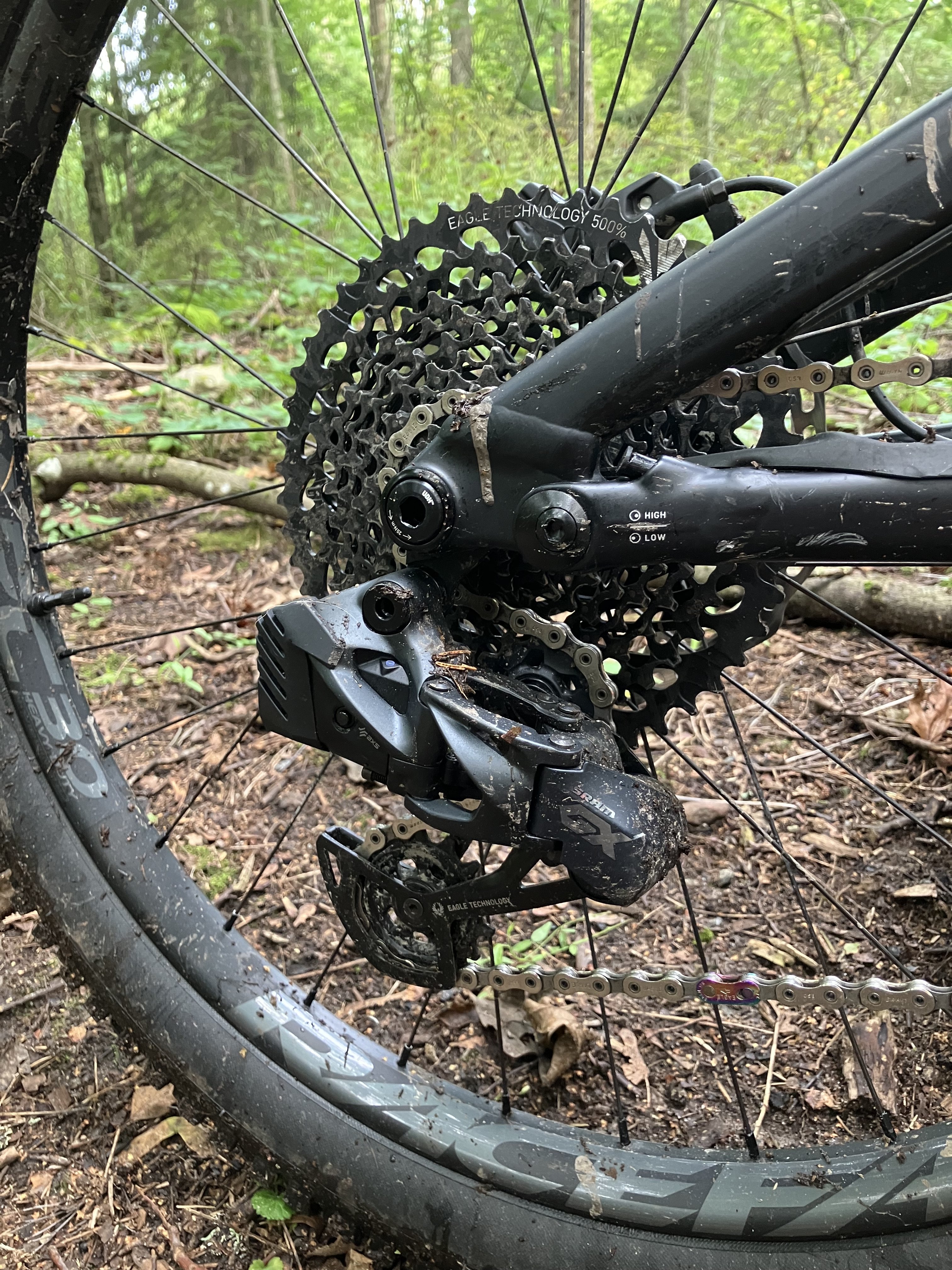

The benefit of either system is that once adjusted there is no reason to have to do any further adjustments. I have not touched my AXS for 2.5 years! Possibly ( not yet had time to prove this) but T Type AXS should require even less given there is no high/low or B tension adjustment.
Now that I think of it, I haven’t touched either of my AXS derailer systems. On the fuel EXE T-Type derailer, the LBS set it up in January …haven’t touched it since.

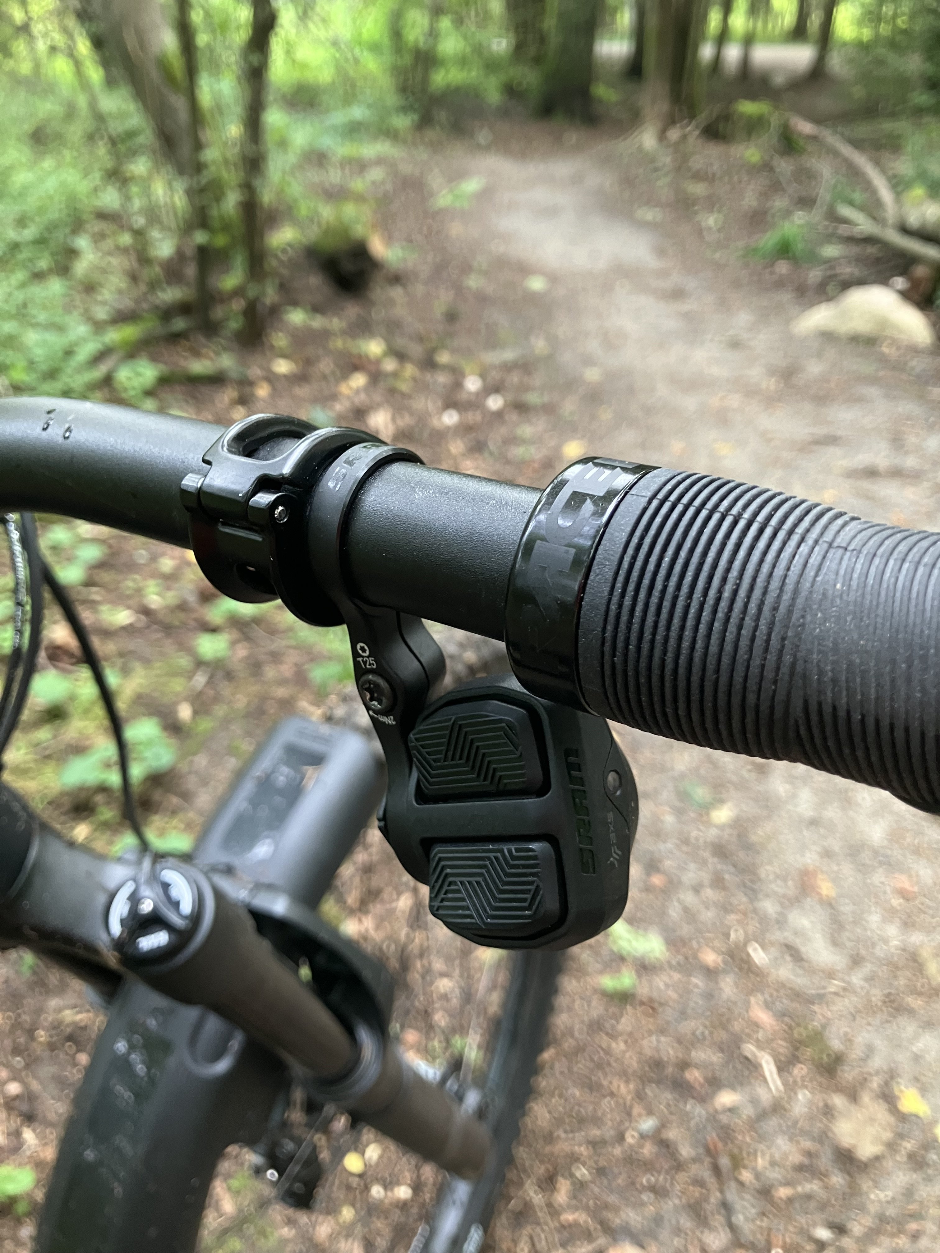

I have done four rides and around 100km's on AXS upgrade kit. I toasted few derailleurs and hangers in short time and purchased this only because it maybe could stand hits better 😀 . Haven't crashed or hit it anywhere so don't know if it was good purchase in that sense but I'm suprised how much better the shifting is ❤️Now I know why people are using these. Don't know how I get along with this in long run, didn't really want more batteries to charge but this first impression is really good. Derailleur is big and bulky but I don't see it while riding..and that pod style shifter is amazing, great ergonomics. Cleaner cockpit is always a bonus...

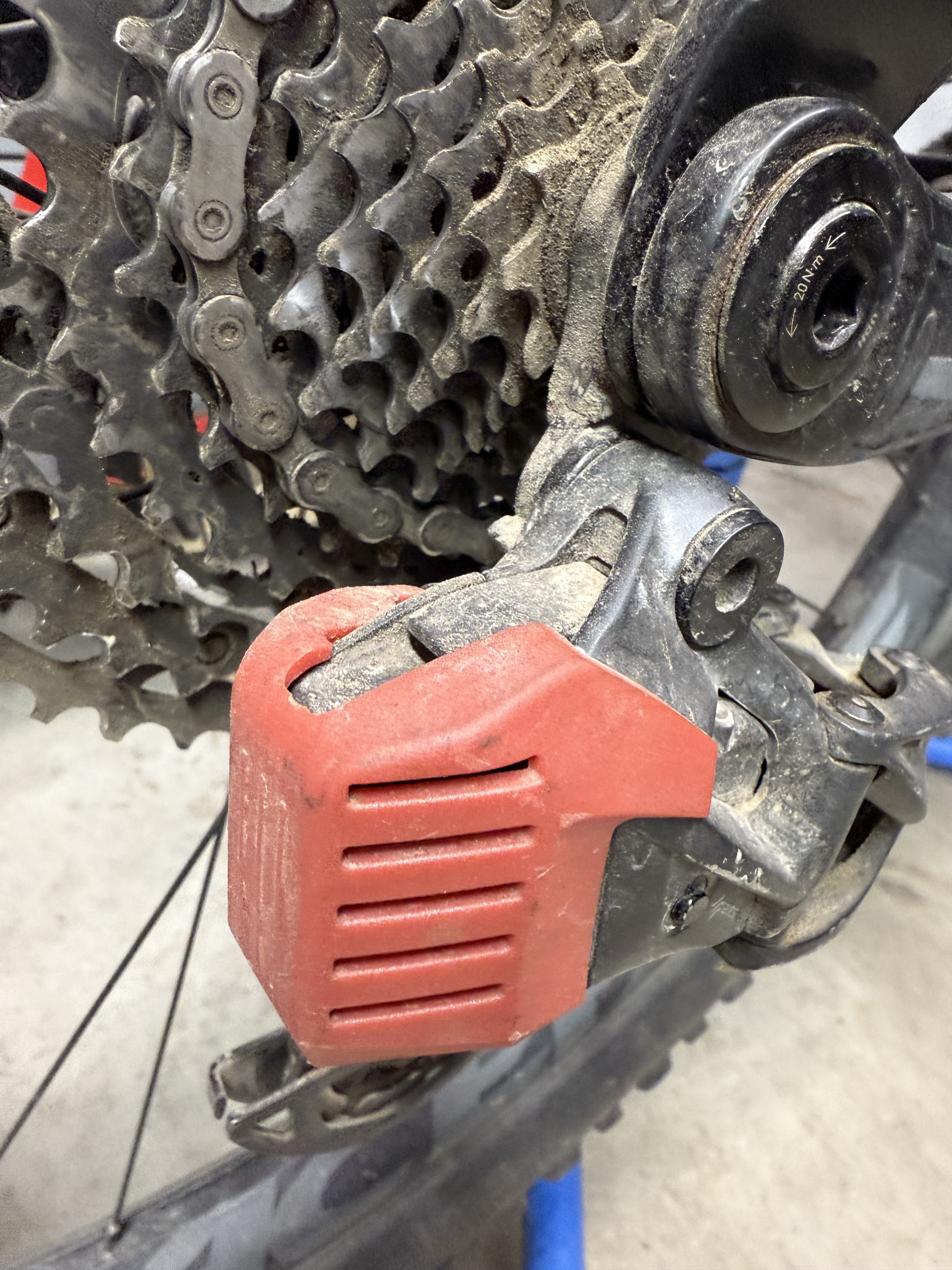

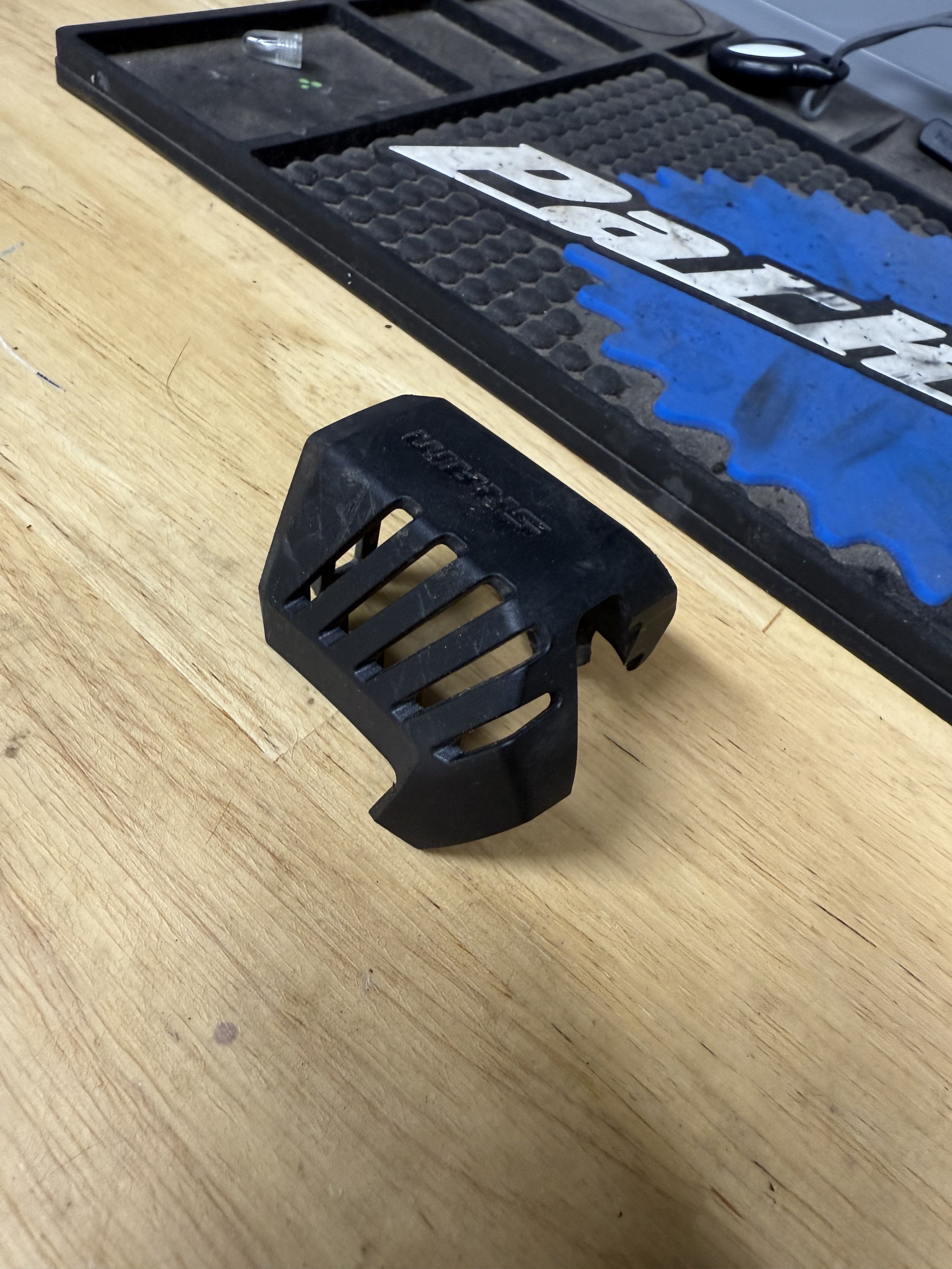

The battery cage, on the AXS GX derailer, seems to fit rather loosely. Mine fell off after a crash on a trail and I couldn’t find it. (I assumed once I noticed it was missing).
So I ordered a replacement red one from Amazon. It was a tighter fit and was likely 3D printed.
Ironically, my buddy found one on a trail, in the area where I crashed a year + before.
Is it mine? Who knows? But now I have a spare.
Edit; hmmm? 🤔 it seems I posted about this last year. But the black cage was found last week.
