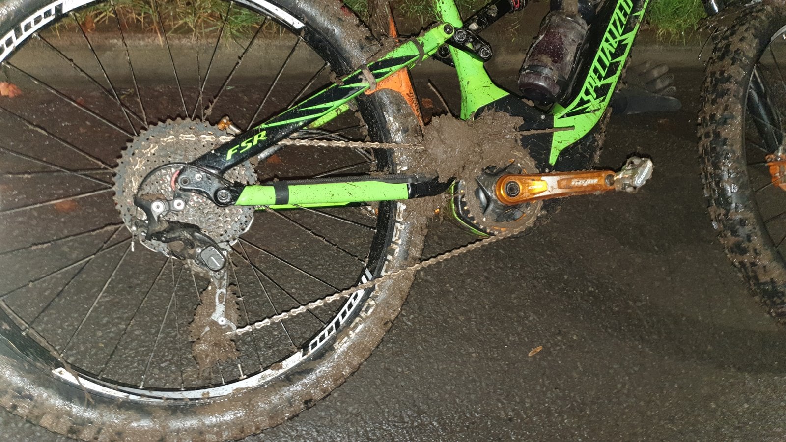

Levo Gen 2 Anyone know how to stop muddy stuff collecting here
Taffyteg
Feb 13, 2018
200
129
United Kingdom
Greetings, I have decided to give Schwalbe 2.8 tyres a try, I have gone for a Eddy current on the rear and a Magic Mary on the front. First impressions is wow with the Mary, amazing amounts of grip, the Eddy current likes to run with lower air pressure than I normally use, this is getting better the lower I go. However the wider 2.8s are dragging a lot of mud onto where the rear triangle meets the BB / motor and then the chain starts running through it and then the jockey wheels get blocked up. The lower part of the triangle is narrower than the upper part, if it was the other way around it might be ok. Does anyone have any recommendations like a rear hugger / mud guard or deflector to help stop the mud and other nasty stuff accumulating here please? Cheers in advance.

Just clear it out with a stick every now and then. Do not bother with sicomtb. Waste of time as just pushes even more crap on the chain.
I bought one and sold it soon after.
There were regular stops with using sticks and fingers to get it out. Problem being once it clogs up the jockey wheels with mud / twigs and leaves its a right pain to get out.

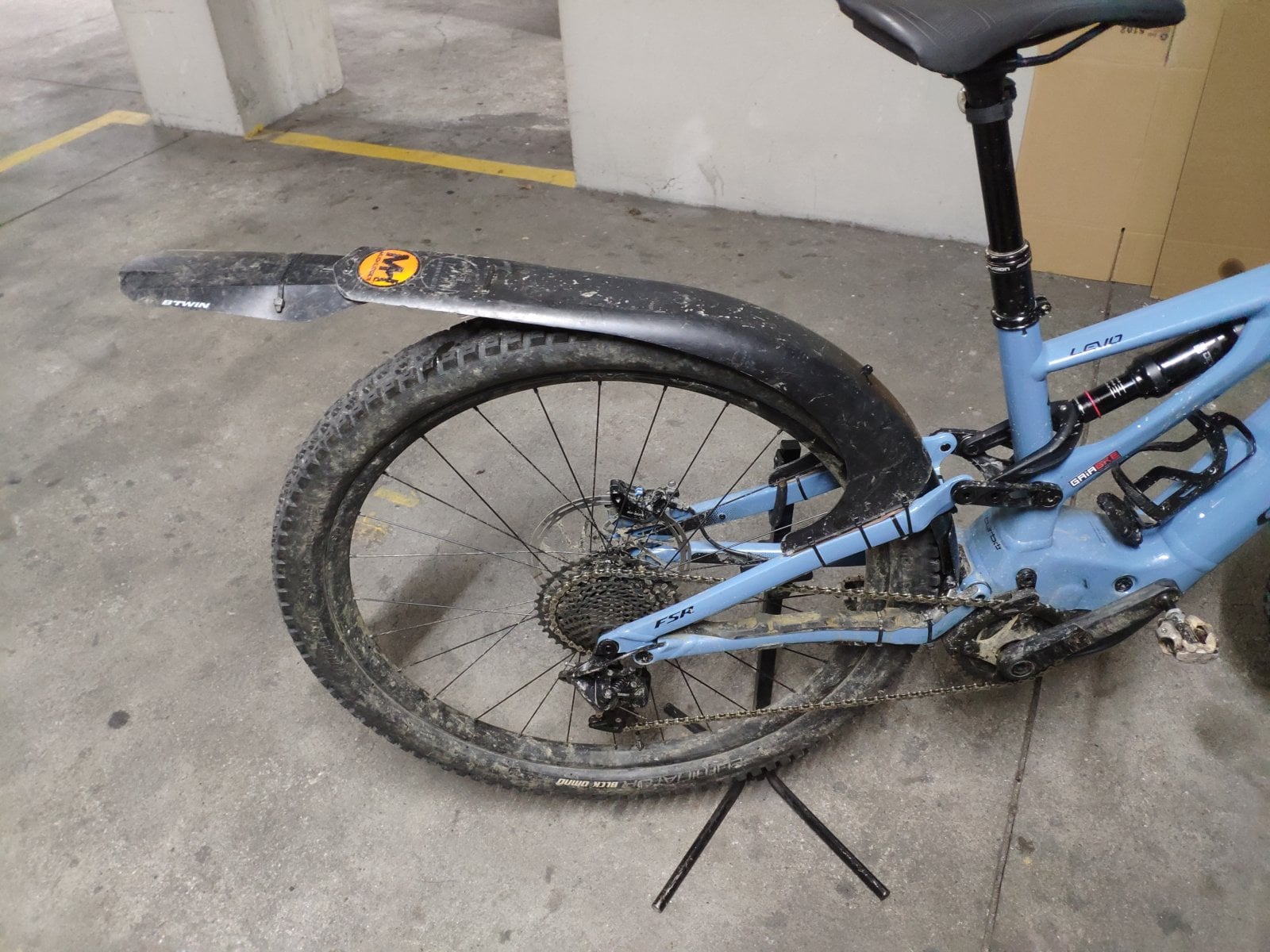

That mudguard isn't helping, it's just filling the space with mud, then pushes it all out to the side as it hits the chainstay.
I'd just get rid and embrace the muddy backside :poop:

Thanks for the info. The mudguard is too short to stop any mud getting on your back, however it does help to stop mud getting onto the "shelf" where the chainstay bolts onto the frame.

That picture looks downright menacing. Is that how it normally looks after riding in the UK or Northern Europe?

You should try removing the mudguard: the mudguard collect the mud and 'redistributes' it on the sides.

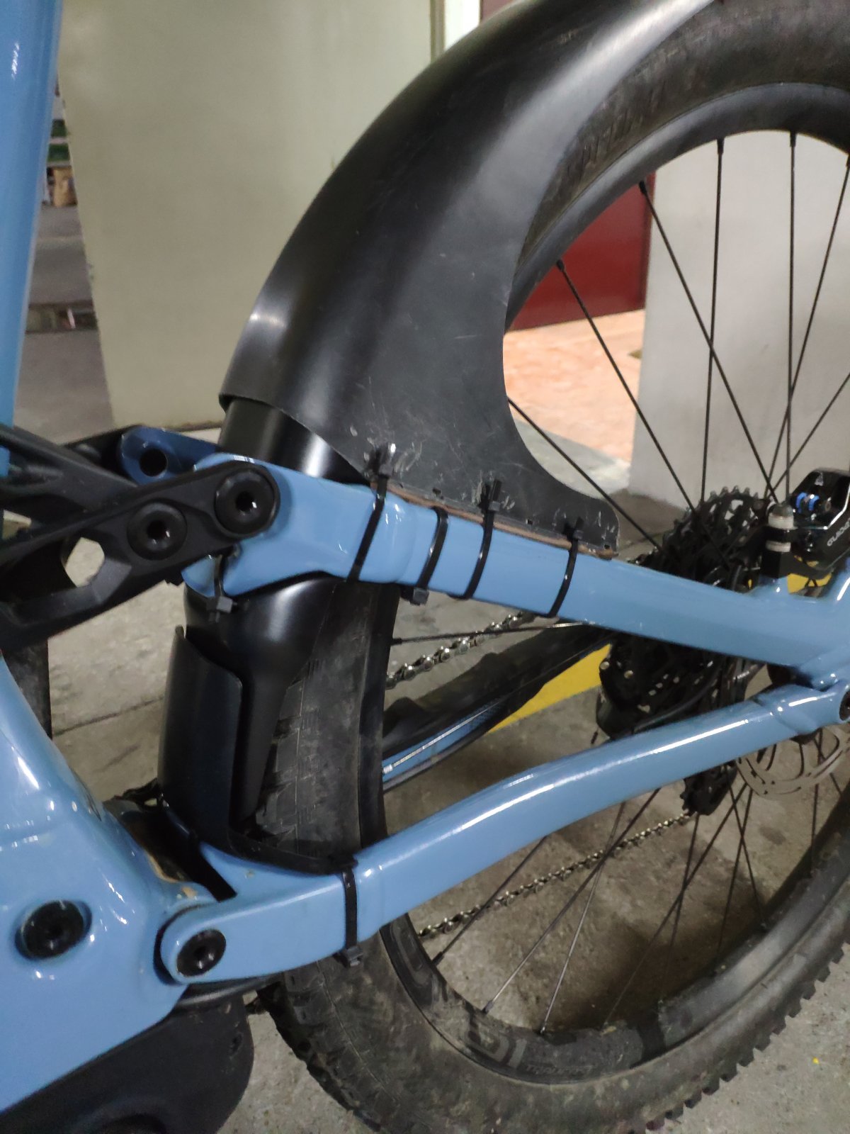

From my side now - add additional mud guard on the lower triangle. I experiment myself to make the most reliable one (Ver. 1 below).

Whatever you do, you can’t stop mud and leaves jamming the rear triangle at the moment. Stop and poke it all out with a stick.
the topeak defender mudguard works as it fits on the seat post , doesn’t jam the wheel ,with mud and stops your arse getting wet.
im having to stop multiple times each ride at the moment unless it’s a dedicated trail centre. Cannock is fine but you get lots of baths ☔️?

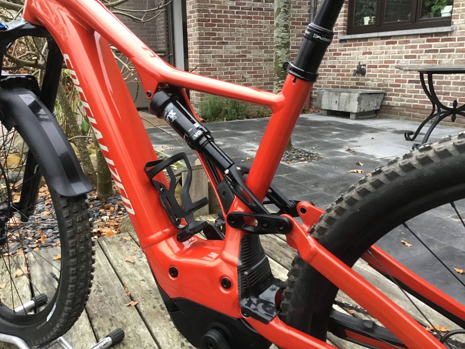

Have a look at Engine protection Mud Cap 2.0 Levo 2019-2021 for alloy – carbon : Levo Range Extender

The mud will still pile up, but can't do any harm with this linkage protector: Specialized Turbo Levo
I'm using it since a few weeks in very muddy conditions and it works great.
Easy to install (special velcro patch), easy to remove, weighs close to nothing and the bottom part is a bit flexible.

That front mudguard placed on your seatstays looks to be actually funneling mud straight onto your rear pivot and chainring
Try a smaller mud specific tyre and a mudguard that actually goes all the way down to the chainstay yoke. like @Gordon's recommendation above

The Levo can run up to 3". I used to run 2.6" and the mudguard worked well with them, the gap across the seatstay is larger than the chainstay, so it looks like the chainstay is scraping the mud off the tyre and on to the chain.
