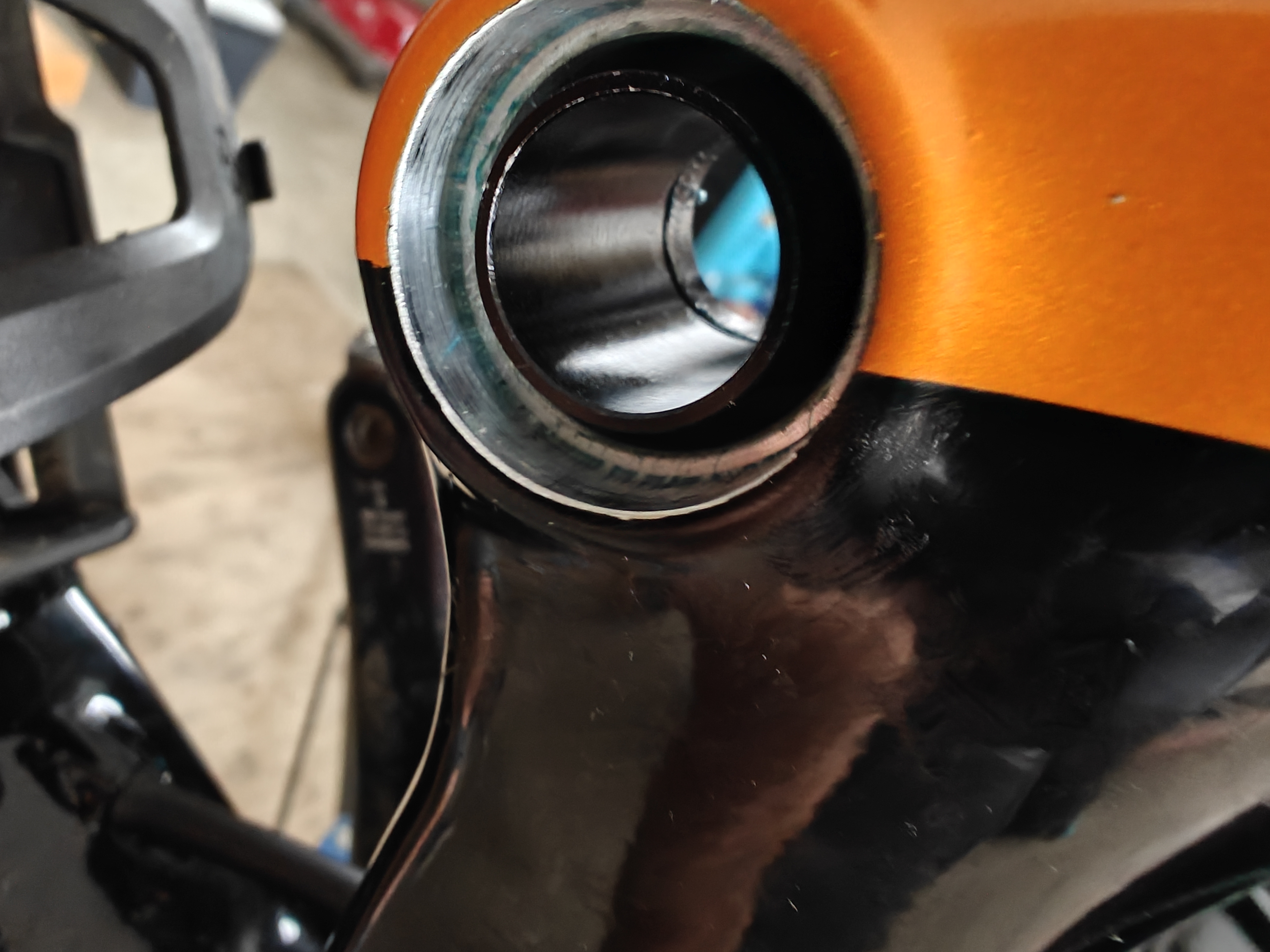

Hey has anybody problems fitting the preload kit with a 2022 Rise H?
The spacer seems to be too big for me.
I've done some measurements.
The main pivot point on the frame is about 41mm wide, the spacer is 30mm wide, each bearing 7mm. So the spacer is 3mm too big?!
Am I missing something here or is it the wrong part?

Just for closing the topic:
I've got in contact with customer support. They actually shipped the wrong spacer. I got a new spacer for free. Now everything fits perfectly.
