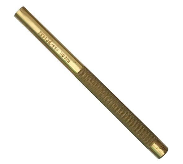

You shouldn't have any problems with removing the bearings. Keep in mind, the bearings are not going to fall out, you'll have to strike them with some considerable force, using a ball peen hammer with some weight. I've always used a drift punch inserted from the opposite side of the frame to drive the bearing out. I've tried using a slide hammer puller, but I've found the brass drift punch to be more effective. I like using a brass drift punch simply because it's less likely to grenade the hardened bearing race and send the pieces shooting into your hand. Using a hardened punch against a hardened bearing can cause pieces of the bearing to shear off.
With all that said, you are obviously encountering a different situation than the rest of us. Remote Juggernaut's suggestion of some penetrating oil is very good. Give the bearings a shot of the oil and let it soak in for an hour or so. Occasionally tap the bearing. The idea is to get the oil to work into the gap between the bearing race and the frame.
I would suggest one other idea that may help loosen up the bearing. Lay the bike on it's side. Take some dry ice or ice cubes and place the pieces in a plastic bag. Lay the plastic bag on the pivot bearing itself. Let the bag sit there on the bearing for about 30 minutes. This will slightly cool the metal and shrink it. Once the bearing is very cold to the touch, quickly pick the bike up and strike the bearing, it should come out.
I used a punch and finally got it out. I ordered some new bearings anyways. but I had to hit it pretty hard before it started to finally budge

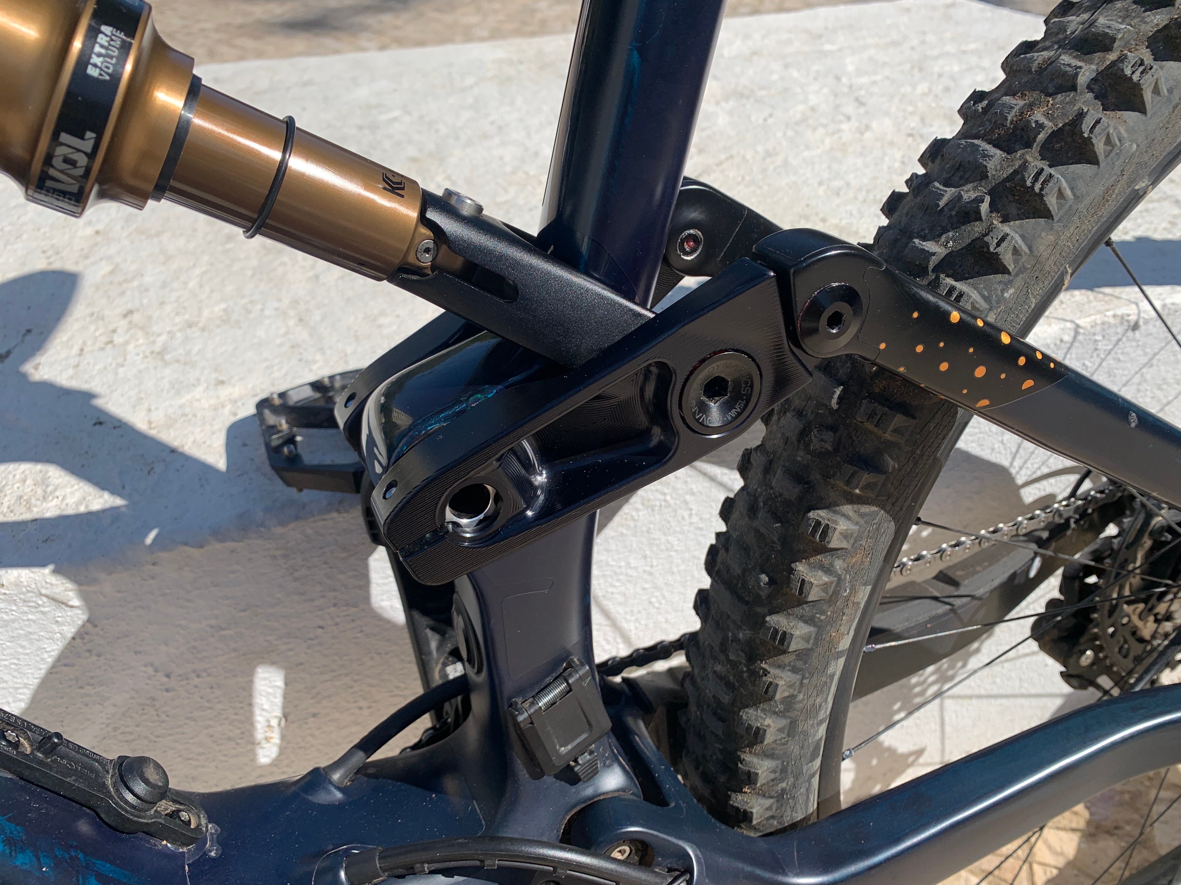

do you mind sharing a picture of the gap between the cascade link and the upper pivot bearing? when i test fitted mine, there seemed to be quite a bit of gap compared to the stock linkage.
I thought the same with mine, however, there is zero lateral play when it is all torqued up.

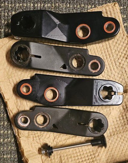

Im still at a bit of a lose as to what it does and how. Is the link thicker / different materials / diff geometry etc?? Read the cascade blurb but not yet fully enlightened.
I changed the rekon the a scoprion with a DH casing and even that seems to provide a tad more stability so maybe this link is my next go to.
EDIT ; found pic above..OK seems quite a bit more 'meat'
The difference in distance between the mounting holes is obvious, so it changes the geometry, leverage, throw etc. I replaced a similar linkage on a motorbike rear suspension and the difference was like night and day.

Removal of old link was pretty straight forward.
Installation of new link was good until I had bolt in the seat stays. I got one side installed but it was quite hard to align - stripped first thread of the bolt. The second side was even harder.
Solution is to loosen the rear axle, and if you have SRAM, put on the chain slack lock on the rear mech. For any other drivetrains, disconnecting the chain would help by reducing seatstay tension.
This made both sides installation much easier.
As for 29" clearance with long stroking and double offset - we are good for a size large. I will probably reduce an offset like BiGJZ74 did. Unfortunately I do have a slight rub on my hydro h10 2021 model.
Tip for seat stays, (after doing same myself) is to do it on the floor with the bike wheels on the ground. I found they align almost instantly and it was a breeze. I ended up having to buy an M10 tap and running it through the thread on the orange one as i wasn't sure if it was just the bolt, but the thread was spot-on on the chainstay.
