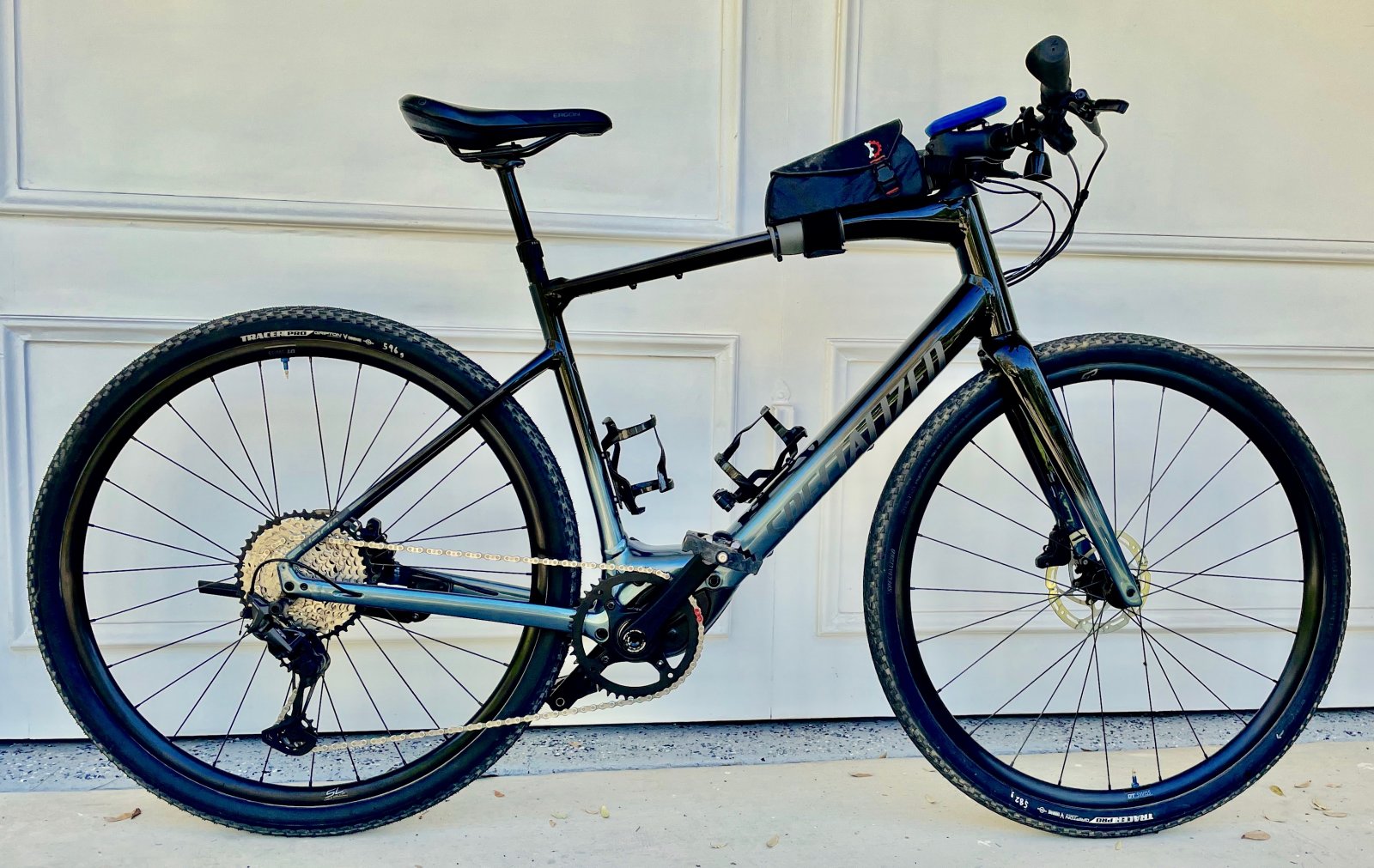

Mrs levity and I both have Levo SL trail bikes and had Creo Comp Carbon road bikes for about a year and a half. The Creos were great fun, fast and efficient on the road and fun on dirt/gravel roads and easy XC trails. Early this year we decided to try the Vado SL, same motor and batteries as the Creo in a hybrid-type alloy frame. We set them up with 100mm dropper posts and Pro Taper 20/20 carbon bars. I went with the same 700x47 Tracer Pro tires I used on the Creo, while mrs levity switched to 650b wheels so she could run fatter (up to 2.1” wide) tires. The bikes are a hoot! As fun on the road as the Creos but with a more comfortable riding position. On dirt and gravel there is more control with the 720mm mtb bars on the Vados than with the 440mm drop bars on the Creos. I think someone more used to a road bike would lean toward the Creo, but since you’re primarily a mountain biker you may prefer the Vado as we do.
here’s a garage pic of my Vado SL
here’s an outdoor pic of mrs levity in Death Valley Natl Park
If interested you can see more info on mrs levity’s bike build here
Vado SL 5.1 GQ, a 27.5/650b “Gravel-Queen”
Have fun deciding! It’s a good time for bike and build choices.
