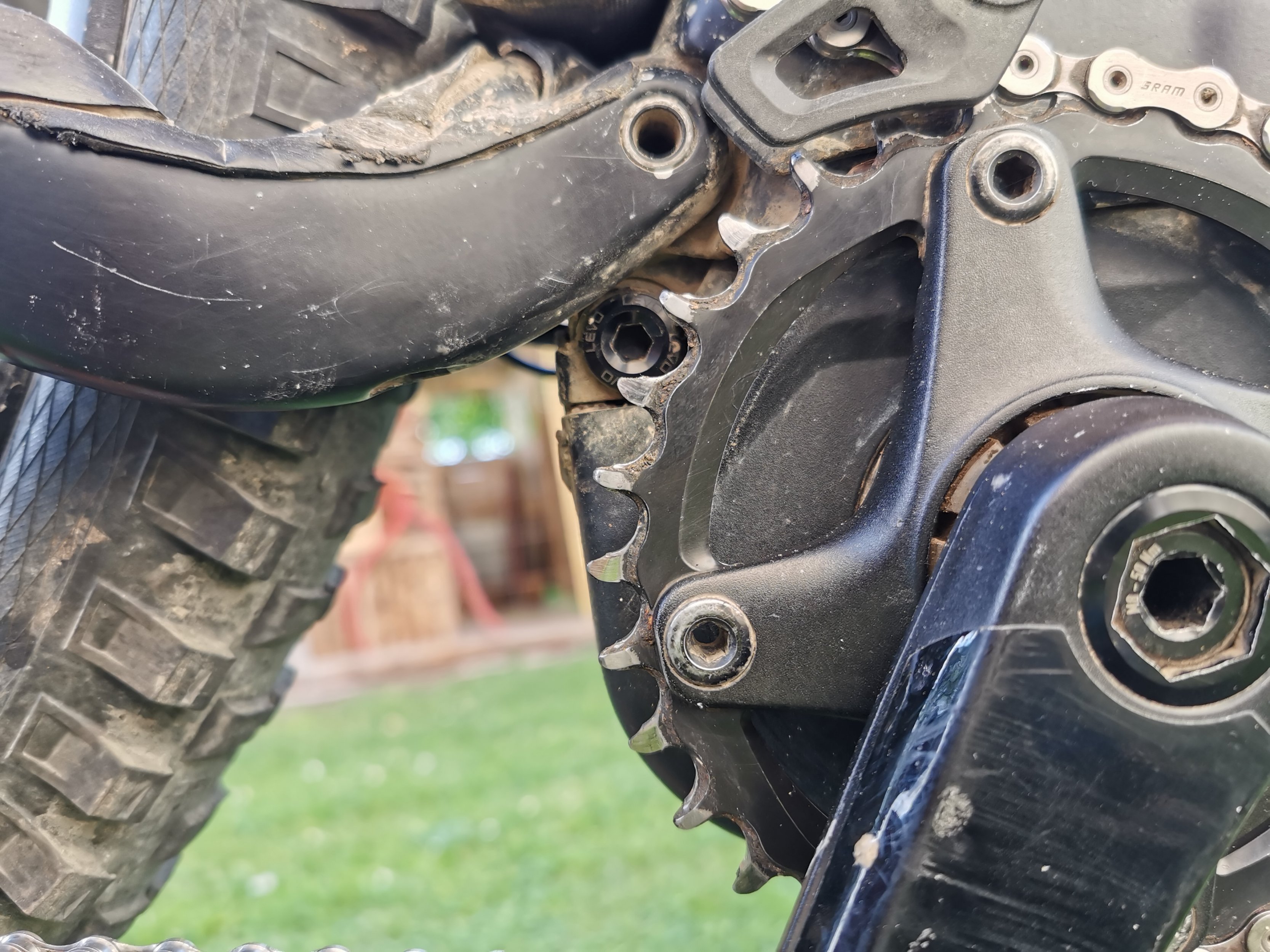

My Gen2 Levo developed severe creaking when pedaling, I tightened all motor bolts except the one on the right lower part of the motor which is inaccessible due to chainstay being in front of the bolt. If I let air out of the shock and compress the rear wheel to the bottom, will this make motor bolt accessible? Or will I have to remove the chainstay?
The service manual says some frames require chainstay removal, while others don't. My choice was to remove it because it's easy to do and it makes the rest of the job easier. You can clean and inspect the bearings while you're in there.
Like it says, watch for those thin washers! They'll stick to one surface or the other, then fall to the floor when you're not looking.
Today I removed the shock to be able to lift the rear end to the max travel to access remaining motor bolt and I can confirm, Gen2 Levo frame size L with 32T chainring the lower right motor bolt is then accessible, but just barely ... With 34-38T chainring it might be needed to also remove the chainring to access this bolt ....
Chainring looks abit worn !
