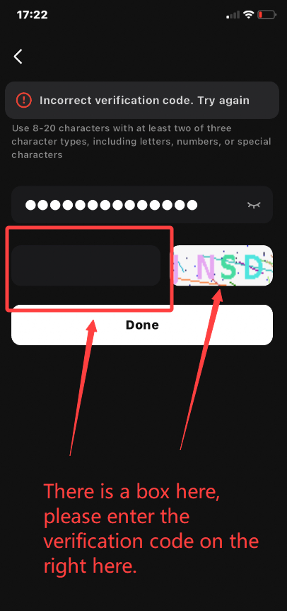

I am having difficulty registering/activitating the Amflow-Ride App on my Iphone 14. In attempting to register, I am prompted to enter my email, then taken to a screen to enter a password. Upon creating /entering a Password, I get a done tab, which upon pressing, I get an "incorrect verification code- try again" error message. Meawhile, the page displays a secondary window with a colored 4 digit/letter code, which I am unable to access by pressing within the displayed code window? Please provide the correct steps to register the App. (assuming the Avinox-Ride is the proper App to begin with). Is it possible this has somthing to do with the Apple phone account settings?
Check your screen resolution. Very often when you have large fonts or things zoomed in, certain apps won't work correctly.
Hi there! We are very sorry that you experienced difficulties while registering, and we appreciate your patience.
Here are the correct steps to create an account in the Avinox Ride App:
  1. Enter your email address
    • Input the email address you wish to use for your account.
  2. Set your password
    • Please avoid using special characters.
    • Use a simple combination of letters and numbers, e.g. abc123 or 123abc.
  3. Enter the verification code
    • You will see a coloured verification code displayed inside the white box.
    • Please type this code into the black box in front of it.
We hope this information is helpful. If you encounter any further issues or need additional assistance, please contact us at [email protected] .
Thank you for your understanding and support.
