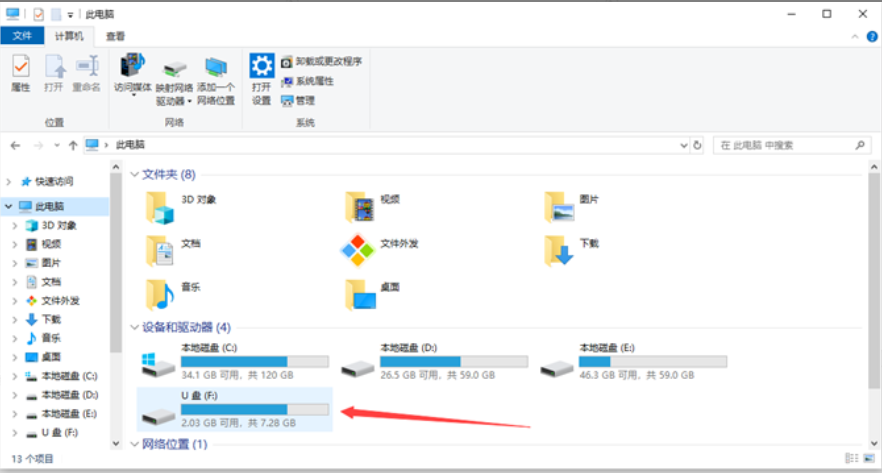

@Amflow_Support - I finished my last ride (1.12.24) with 44% battery reserve, since then the bike has been in a heated room in switched off condition (no SIM card, no theft detection active) Today, 12 days later, the battery indicator shows only 39%. Is such a heavy discharge when the bike is switched off normal?
Hello carlito bandito! It seems like there might be an issue with your battery. Could you please send the following information to [email protected]? Our senior engineers will take a closer look:
  1. Serial Number of the bike
  2. Where you bought the bike
  3. Photos or videos of the error (if you have any)
  4. When the issue occurred or can be repeated (from 1.12.24 to 13.12.24)
  5. All log files from your bike
  6. Your location
To export the log files, just follow these simple steps:
  1. Turn on the bike by pressing and holding the power button on the control display for 2 seconds.
  2. Connect the USB-C port on the control display to your computer with a USB-C to USB-A cable.
  3. Your computer will show a USB drive notification.
  4. Open the USB drive folder, gather all files, and export them.
A few notes:
  1. You can tell if the log files are the latest by their sequence numbers. Higher numbers mean newer files.
  2. Make sure the control display is on to export log files; you don't need to unlock it.
  3. Use a USB-C to USB-A cable for exporting. USB-C to USB-C cables won't work.
  4. Mac users should use a docking station to switch from C to A port, then connect with an A-C cable.
  5. Data usually exports at 20 Mb/s. If it's slow, try another cable or computer.
  6. Valid data is typically over 1 GB. If it's only a few hundred KB, please double-check.
