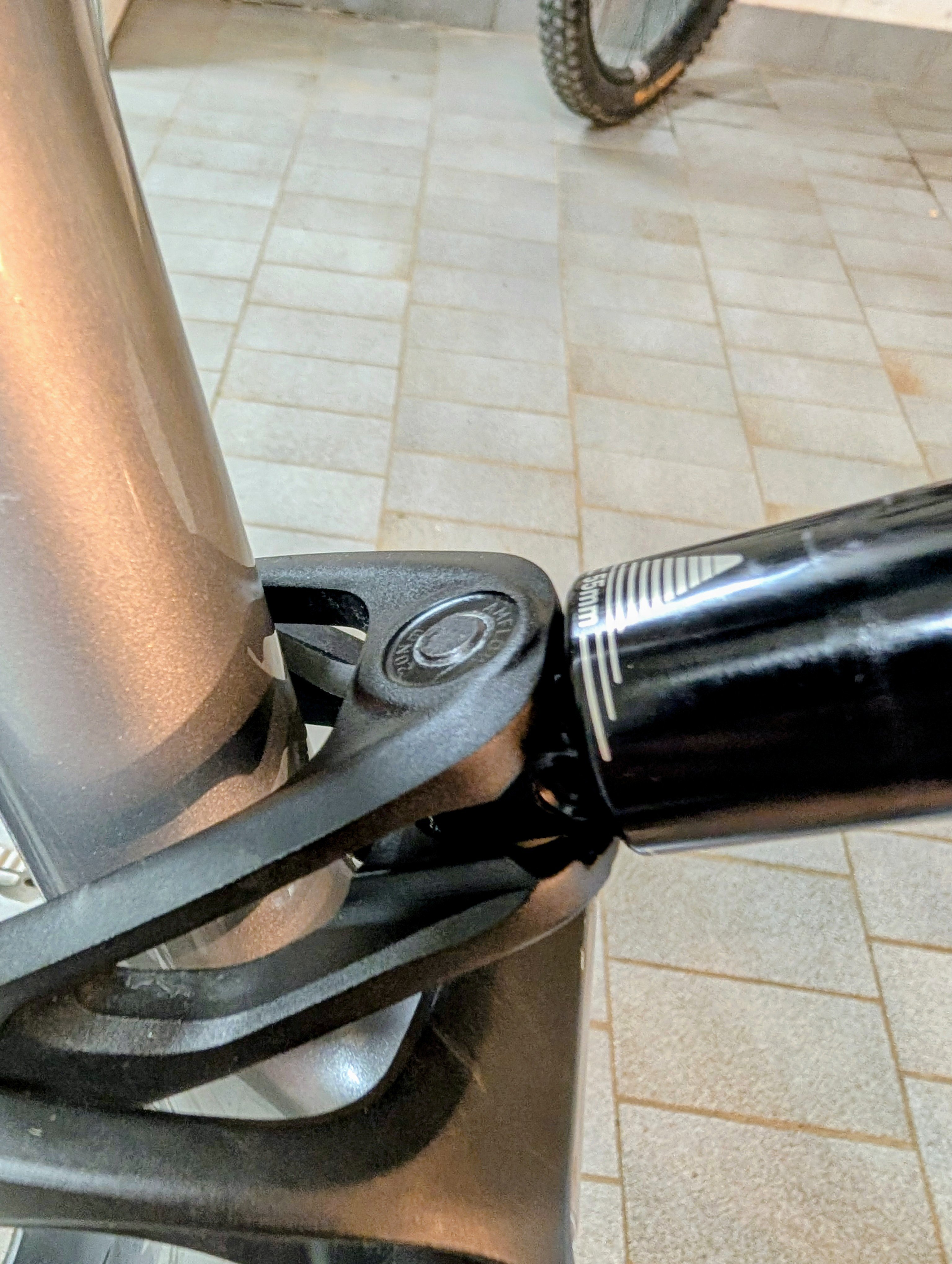

Hi Amflow Support,
i have my Amflow since april (about 2500km) bike starts creaking in the rear shock area. So i Checked the bearings and bushings, regreased all parts (not for the first time) and noticed that the rear shock mount (Yoke) threads are stripped. I allways used a torque wrench (20nm). I think the internal threads of the yoke are not are not thick enough to hold the load over time. I need the Yoke as a sparepart to be able to ride the bike again.
thx for helping

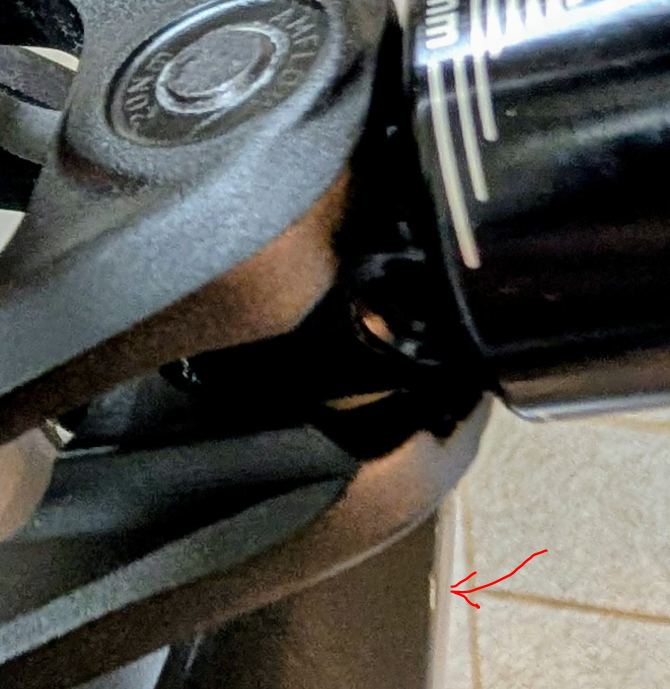

If there is a yoke design issue, with so many Amflows sold, it will be interesting to see if more yoke threads fail. In the mean time. Check the calibration of your Torque Wrench. Make sure it is delivering 20Nm.

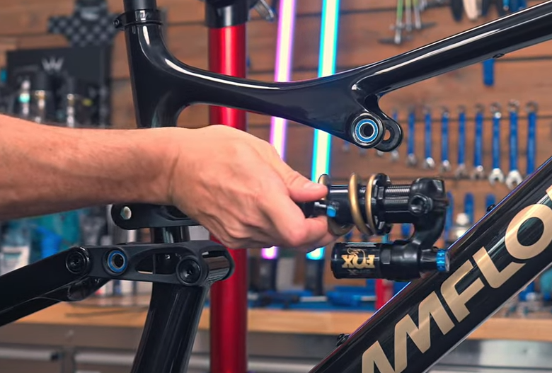

And can I ask. Did you tighten the yoke bolt with the yoke and shock installed on the bike ? The scratches I have pointed to, seem to indicate you did. Access to that bolt is extremely difficult, and that bolt is best Torqued with the Yoke and shock removed. Just a heads up for future adjustment, and others reading, when torqueing the yoke bolt.
If you watch Rob's build video. You can clearly see he fits the yoke and shock, pre-bolted together. There is perfect access to all the suspension linkage bolts if you do it this way. And it dramatically reduces the chances of damaging a thread.

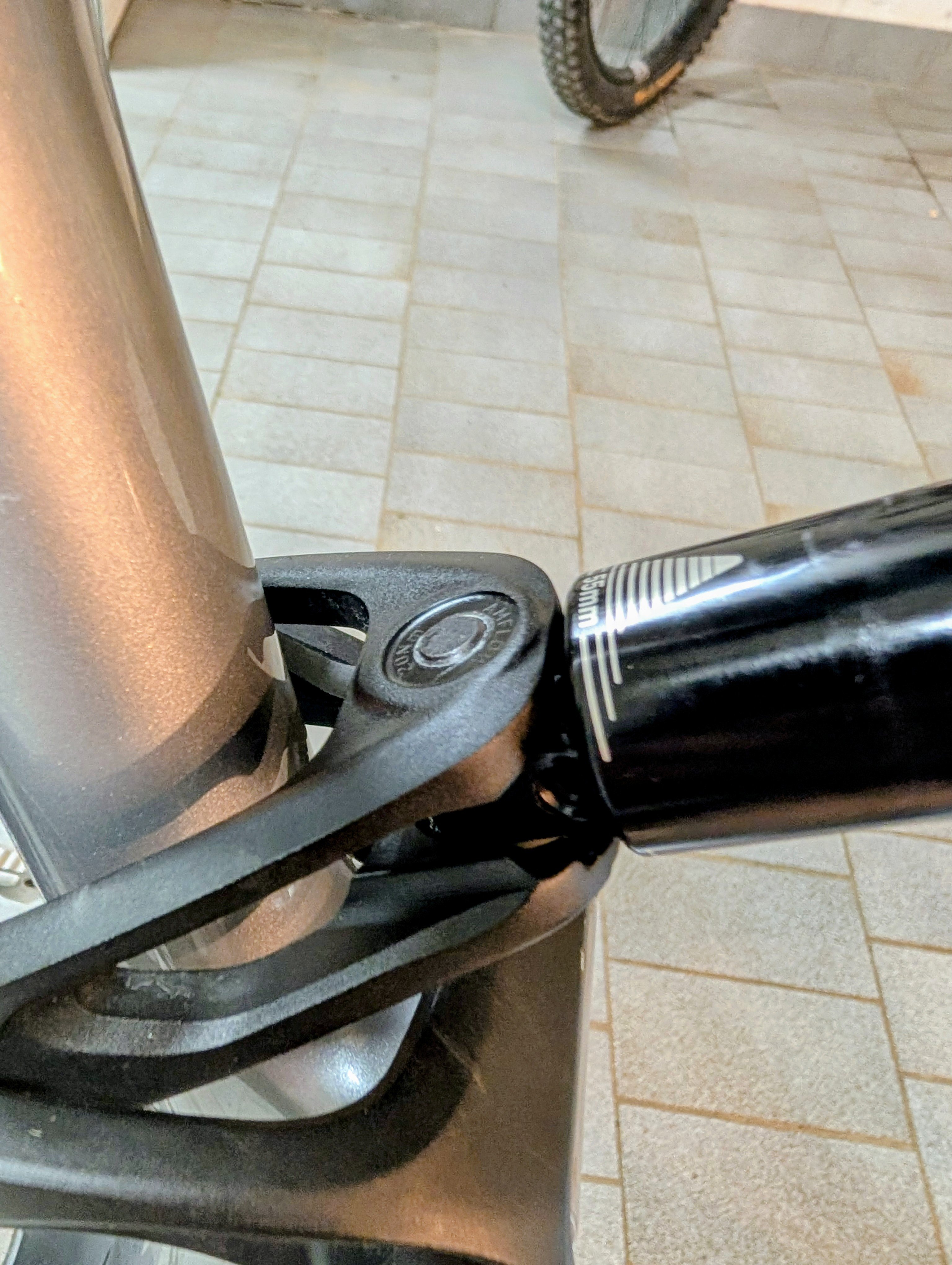

Hi Amflow Support,
thx for helping

Based on your description and our confirmation, we have determined that the issue pertains to a third-party component. Unfortunately, we are not authorized to sell the Yoke spare parts. We suggest that you contact the relevant third-party staff for assistance in obtaining the Yoke replacement.
Thank you for your understanding and cooperation.
Have a good day and safe ride.
What kind of response is this? The shock mount or yoke is part of the Amflow frame.
Who makes the Yoke if not Amflow?
Hi Astro66, thanks for your reply.
I dont think that even if the torque wrench would be of by say 10% that this would be a problem in this case. You are totally right that access to the rear bolt screw is a bit difficult and that a tool can scratch the linkage if the shock is not fully deflated. This is why Rob maybe mounted the yoke and shock first. Its a coil shock and cant be easily compressed like an airshock.

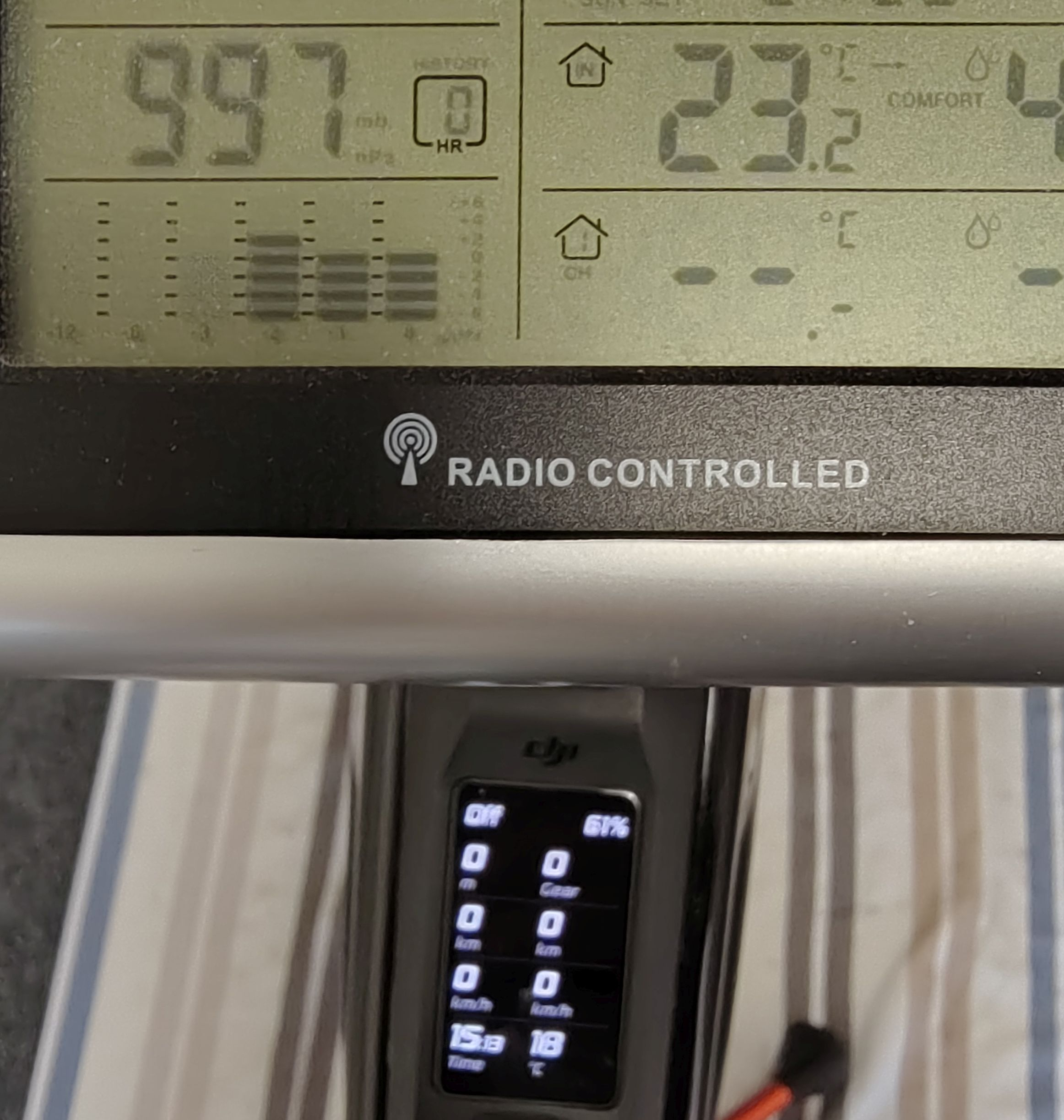

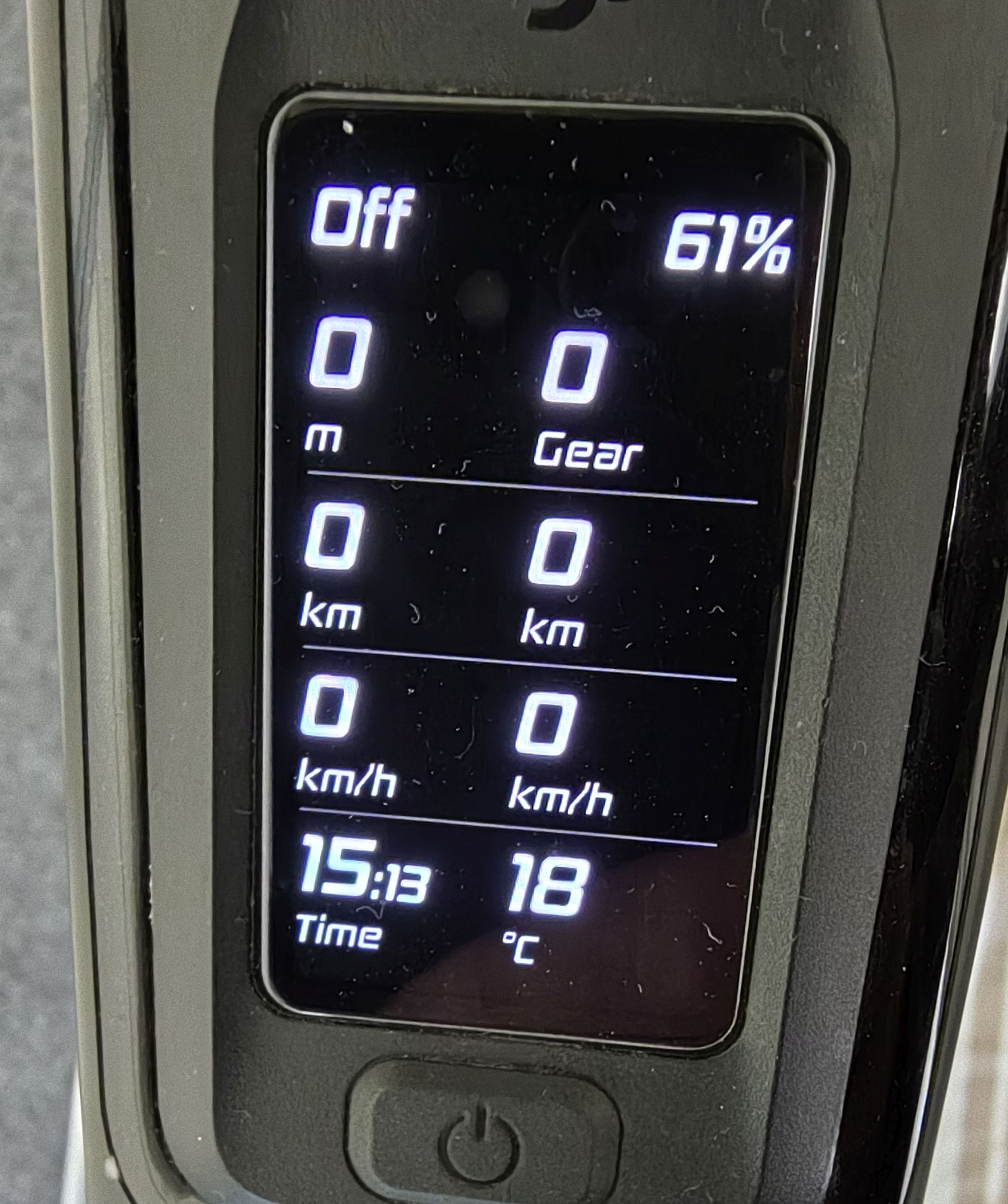

Amflow PL carbon pro - my thermometer permanently shows 5-8 degrees less than reality. Would it please be possible to add the option to calibrate the thermometer in the next update, similar to the altitude?
Many thanks!
I do not have a coil shock, and I cannot get my torque wrench onto that bolt when installed on the bike, because of the mounting below it doesn't allow the head of the torque wrench to fit. This is why most people Torque that bolt before installation.
So in your case, my concern would be the type of torque wrench you are using to fit ? And that if the head of your Torque Wrench is contacting that bottom mounting. Your Torque reading will not be accurate.
Anyway. Just advice from someone who also checks and greases his suspension bearings regularly. And I haven't had any issues with the amount of torque causing a problem. (y)
@Amflow Support:
Many thanks!
Hi, thank you very much for sharing.
May we know whether you are referring to the ambient temperature or the motor temperature? If you are unsure, feel free to contact [email protected] for further assistance.
Thanks for your reply. I mean ambient temperature, of course. For example - bike stays at my home, for long time, ambient temperature is about 23 degrees (celsius). Same for a long time. And bike shows 18 degrees only, again, same for a long time. Difference is 5 degrees.. Outside on the trail is the difference usually more, around 8 degrees. Possibility to make a calibration would be highly appreciated...
View attachment 164435 View attachment 164436
I have the same problem, the temperature shows lower than it really is.
