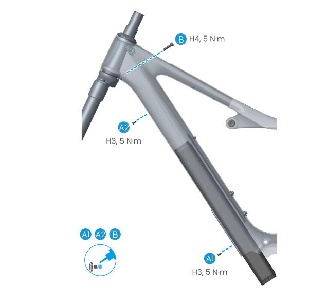

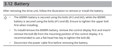

I am thinking of buying a spare battery for overnight camping trips but I am unsure if it's feasible to drop the motor and replace batteries when required and how long it will take. I regularly do this on my bosch motor because of engine mounting bolts coming loose and its probably a half hour job
Unfortunately, we can't sell batteries separately. And you'll possibly need hex wrenches and special tool to remove the motor and the battery on the Amflow PL. Nonetheless, I’ll make sure to note your riding situation for our higher-ups to consider offering more solutions for different riding scenarios down the line.
Unfortunately, we can't sell batteries separately. And you'll possibly need hex wrenches and special tool to remove the motor and the battery on the Amflow PL. Nonetheless, I’ll make sure to note your riding situation for our higher-ups to consider offering more solutions for different riding scenarios down the line.View attachment 159938View attachment 159939
Thanks
That looks reasonably straight forward but it won't be a whole lot of use to me if I can't purchase a 2nd battery. What is the reason for this? Also when I fly with an ebike the battery must be removed first. The battery is able to be couriered in advance via land mail
Cheers
