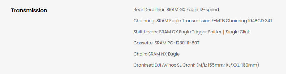

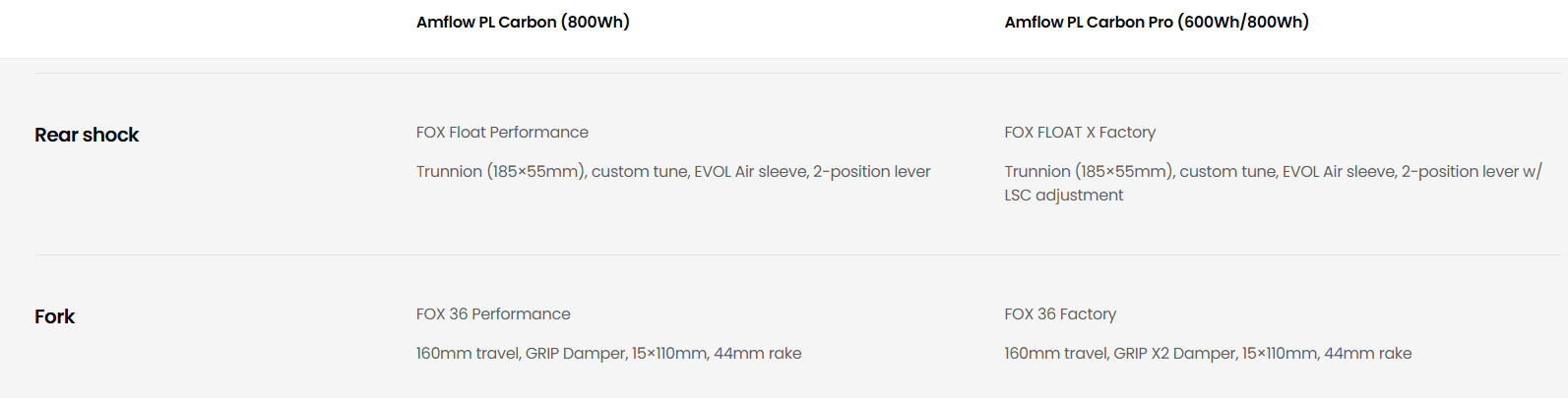

Wondering if you can help me decide. Not sure whether to get the pro version or basic model of amflow. Is the difference worth it. Does the pro version perform that much better than basic model. Is suspension a noticeable difference.
If you are a casual rider or just starting out, the Amflow PL Carbon should meet your needs without the extra cost of the Pro version's high-end components. However, if you are looking for a more professional riding experience with lighter weight and higher-end components, the Amflow PL Carbon Pro might be worth the investment. You can see the comparison information about suspension and other parameters on this page Amflow PL - Specs - Amflow (United Kingdom)

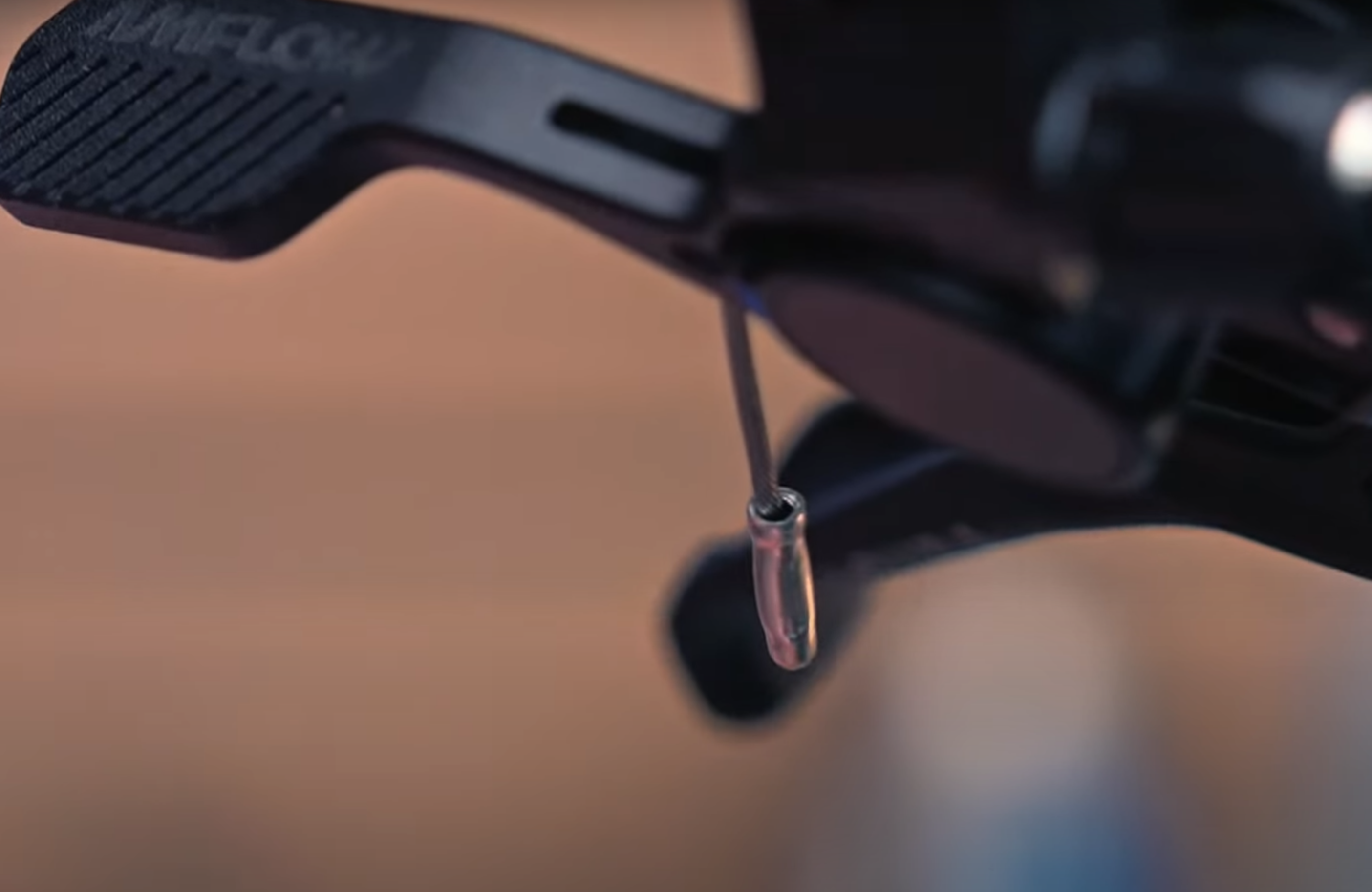

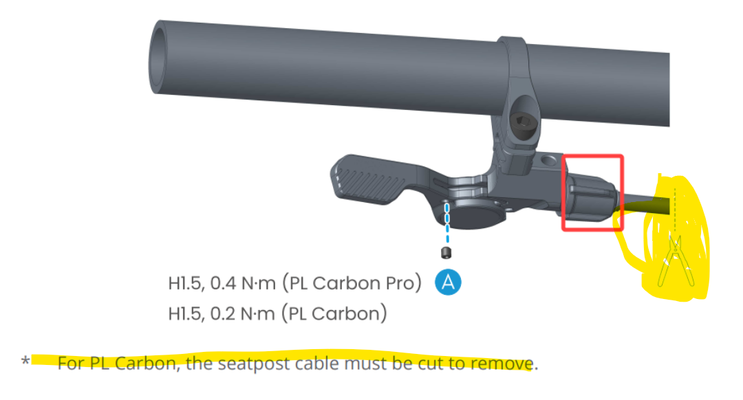

So for the PL Carbon, to remove the seat post you have to cut the cable, which according to the pic includes cutting the housing too? I realize the seat post removal isn't a regular thing but that seems excessive considering the other version has a simple bolt. I haven't had much exposure to many bikes, is this a standard practice?
Have you tried turning the screw in the picture clockwise? Did that help with the issue?
Regarding the seat post removal, you do not need to cut the cable. Could you please clarify if you are looking to replace the seat post?

I was referring to your posting you included a picture of the seat post removal that indicates for Carbon PL the cable and housing has to be cut.

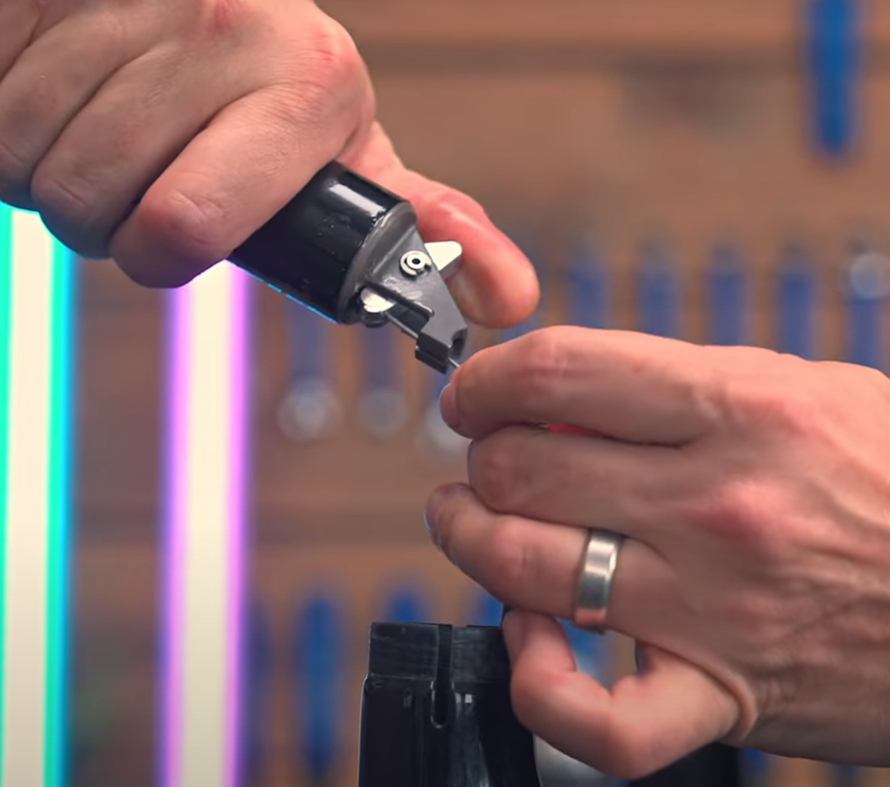

When you undo the screw under the trigger. The cable can't slide out, because there is usually a cable end clamped onto the end of the wire. So you cut the cable just before the cable end. That way you can reuse the cable. Then the cable is free to fully slide back into the sheath.
But you should be able to unhook the cable at the post end, without cutting. Just undo the screw under the trigger, undo the screws holding the cable sheath to the frame, and see if you get enough slack to unhook the cable at the post end.
I'm referring to this in yellow for that model.View attachment 154370
For the PL Carbon, if you need to replace the seat post cable, we recommend following our manual's instructions to cut the cable for easier handling. But if you're just looking to remove the seat post from the frame and keep the cable intact, there's no need to cut it.
OK, it sounded like (from the pic) to remove the seat post from the frame, the housing and cable had to be cut. Thx for clarification.

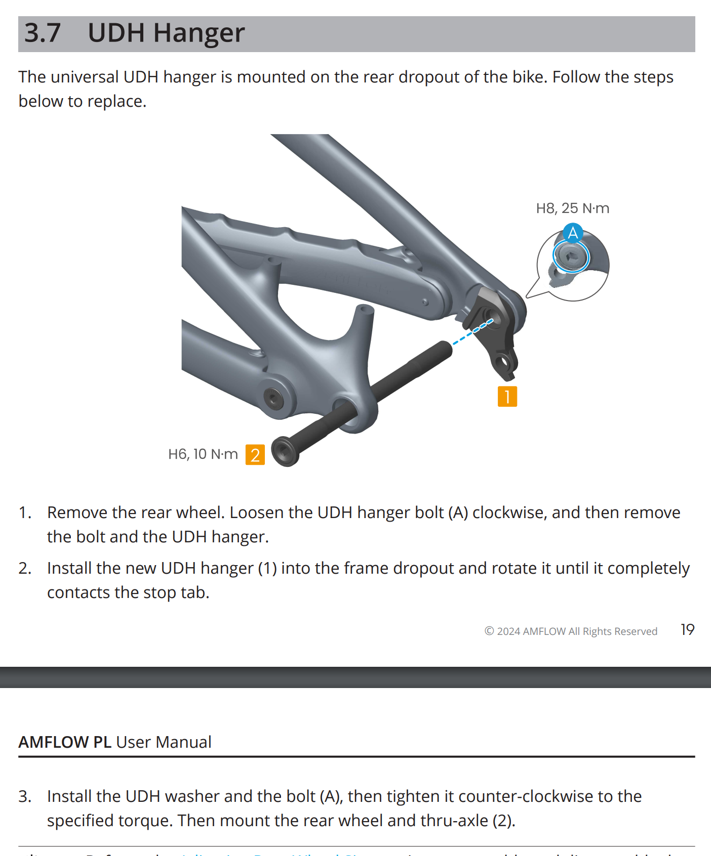

I managed to rip my mech off completely yesterday & also destroyed the hanger on a large rock at the same time. Does anyone know where I can get a new hanger please ? I have looked on Amflows site & they‘re not shown.
Bike is the standard PL not the pro.
It does appear to be a standard SRAM UDH hanger. Should be able to get it from most bike stores.

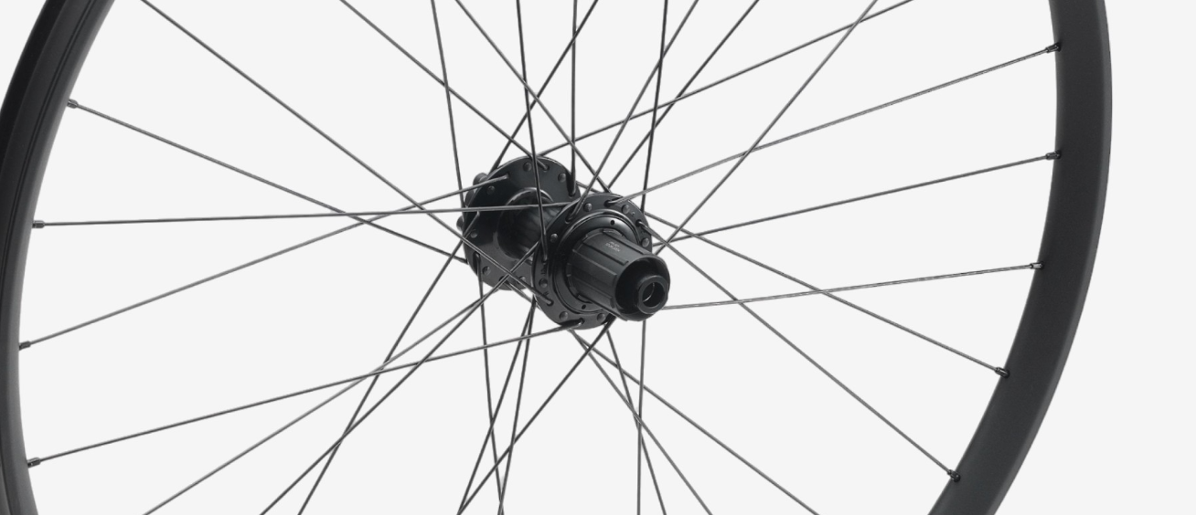

Can anybody tell me if I need to change the free hub body on the PL carbon version, ( Amflow HMA-30 wheelset) If I am going to put on a SRAM 1295 10 to 52 tooth cassette?

If you go to the Accessories page on the Amflow website. You can buy a new rear alloy 29er wheel. And in the photos. It definitely has a HG Hub. Whilst the rear Carbon 29er for the Pro, has a XD hub.
You definitely cannot fit a 10 tooth cog on a HG hub. So you will need to change it to a XD hub to fit that cassette.
Thanks. Pretty much what I thought, but does it have to be Amflow wheel specific, or can it be any SRAM XD freehub body?
I build my own wheels, so normally I just buy an entire XD hub and freewheel assembly, of any brand, and re-spoke the wheel. So yes. If you change the entire hub assembly. As long as it's an XD Hub. It can be any brand.
I'm unsure how easy it is to change the HG freehub only, or even if it can be done. And what brand of XD freehub will fit that hub assembly. It is Amflow's own wheel.
Thanks, I’ll await any further advice from others before jumping into buying a new cassette. Apparently XD freehubs are in the order of AUD70, but that of course assumes you might be swapping like for like, as you say, not sure if you can do an automatic swap for the HG free hub body.

Hi JonoHobart, Amflow makes all the wheelsets, hubs, and freehubs for the Amflow PL. If you want to make some changes, and need the AMFLOW HMA-30 XD Freehub. Just drop a line to our customer service at [email protected] with your shipping info, and we'll creat a freehub purchase case for you through our after-sales service. Thanks for your understanding and support!
