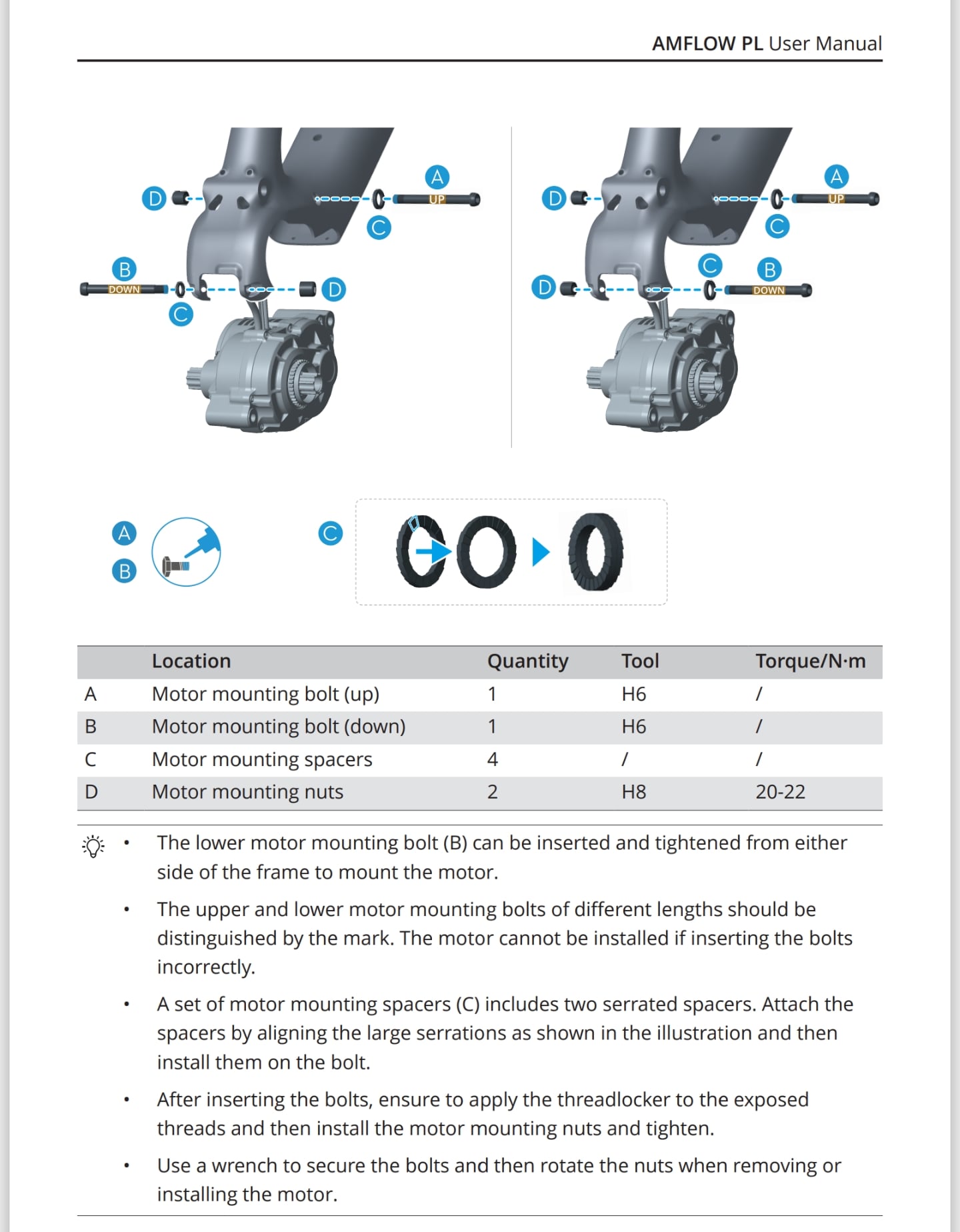

Hello , my amflow makes a noise every pedal strike, it appears to came fron botrom bracket. Te bike has only 1 month and 500 km. Any suggestions?

Torque the motor mounting bolts to a torque of 22nm
On the newer bikes, they're loosening up for some reason

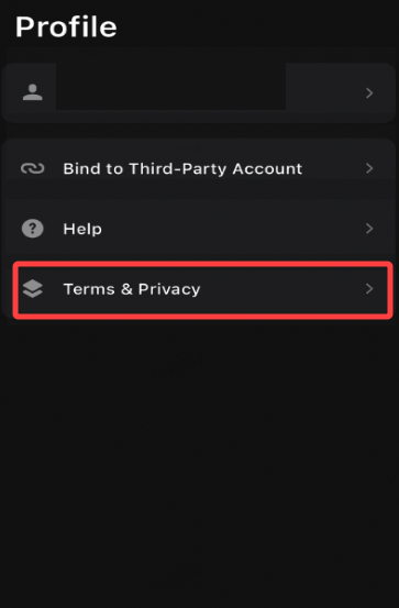

Hi!
Where exactly in the Ride App (1.3.4-6470) do I find this backup&sync feature? I can't find it.
Anyways, I think most ebikers would want to look at the statistics immediately without having to manually trigger the sync (switch off and on again - and then off again, or opening app and manually download data). Since everything on this bike/motor is so modern I was puzzeled that the ride data has to be downloaded via Bluetooth and some manual steps - I was sure, I did something wrong 😀

Hi!
Best regards,
Herbert
Hi Herbert,
You can enable the feature in the App by going to Profile > Terms & Privacy.
We totally understand your concerns and really appreciate your feedback—improving the experience for Amflow riders is very important to us.
Please check if the feature is enabled, and let us know if you have any issues with ride data uploading after turning it on.
