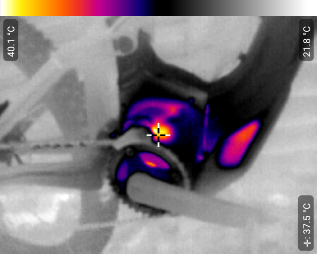

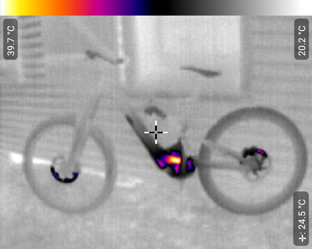

I just heard something interesting on Sam’s Bikes on YouTube about his alloy super build bike. He mentioned they could feel the heat from the motor radiating into the frame and making the frame hot. Anyone with an allow frame experienced this? He always rides in Turbo mode, so I wonder it that makes enough heat to be felt in the frame?
I'd be surprised. I did several heat scans after turbo runs on a kenevo and there wasn't much heat. I think @Bearing Man has done similar.
An alloy frame should conduct and radiate any heat away pretty quickly.
The gen3 also did away with the flat top frame over the motor and re introduced the angled frame, so there should be more air over the motor.
Yup, nothing to worry about.
