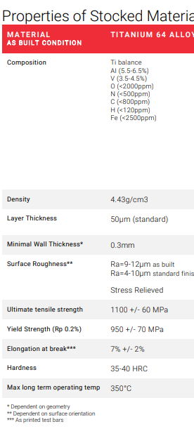

7075 if 550mpa uts 3d printed ti is 950mpa. So almost double the strength of 7075.
They are between grade 9.9 and 10.9 bolt grade strength.

PS I was also wrong. They are 950mpa yeild and 1100mpa uts.
This big question are they as strong as the bolts i've removed? The answer is a about 100mpa less.
Lets see it they work. Only one way to find out!

yep. They are approximately 100mpa UTS less. I suspect there's a 3 or 4 to one safety factor on the oe bolts. So i'll be reducing that a bit. Time will tell.
