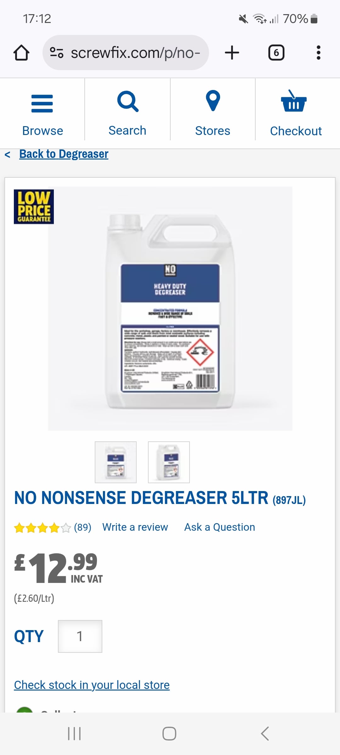

If you can be bothered, data sheets on cleaning gear can be revealing. I keep a £10 5l bottle of Screwfix no nonsense degreaser after sussing out it's an identical formula to Halfords bike degreaser at £15 a litre.
I'm on it . Is this the correct one ?
Blimey, they put the price up a bit. Still, it's a lifetime's supply.
