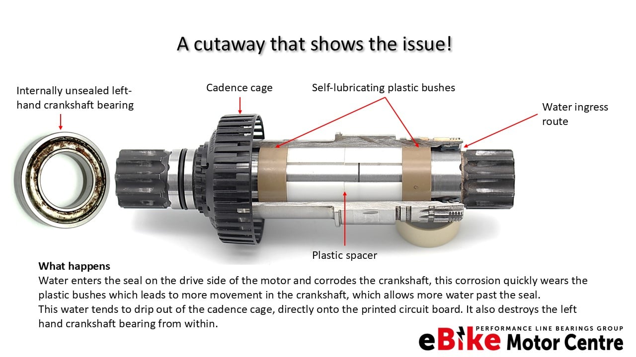

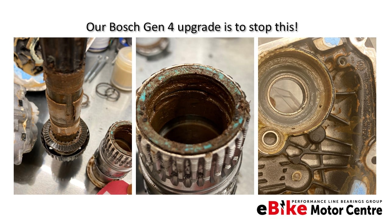

This is a great video, but missed the real reason motors fail. Putting aside pressure washers etc.
As we all know, you can ride your emtb through deep water and nothing happens, it will appear to be fine! Unfortunately, the failure will often occur months later when you have completely forgotten about the dunking you gave it 6 months ago. It will be a complete mystery why this happened!
The reason for this; with a motor in good condition, water will usually just enter into the outer bearings and not the motor at first. (Sadly, no one checked for this in the video). The bearing is still quite well sealed at this point so the water can't get out again. This starts slowly corroding the bearing race and ball bearings, this wears the ball bearings down until the bearing seals can no longer fit properly, allowing water to flood into the motor itself and eventually kill it!

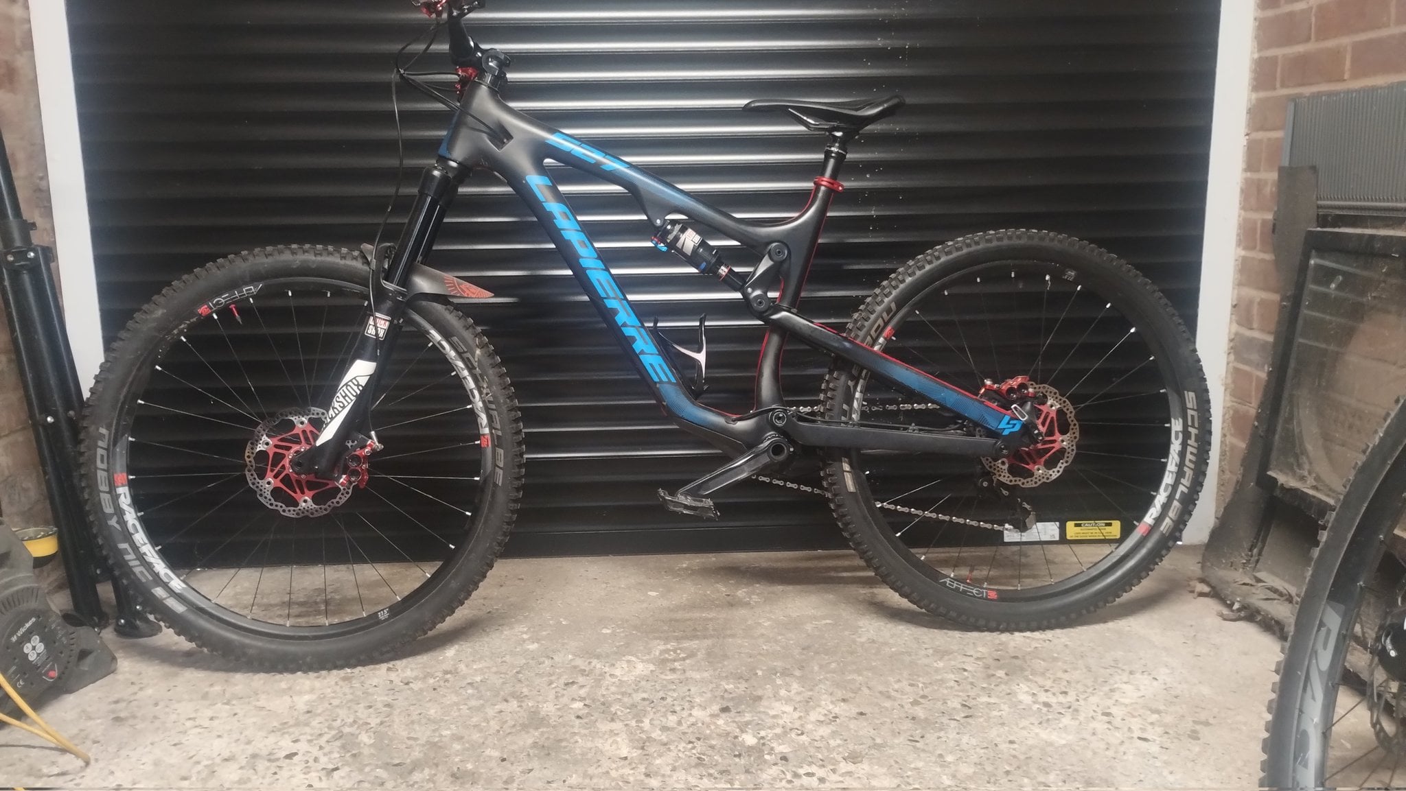

I recently changed the front wheel bearings on my normy Lapierre Zesty, not seen it before but they were marked LLU. I looked them up & it denotes a bearing with a sealing lip on one side for higher sealing & intended for use where one side of the bearing is exposed to the environment. My takeaway from that is designers do what they can to prolong components but in the end, mechanical components invariably wear.
Any excuse to shoehorn a photo of this beast in.

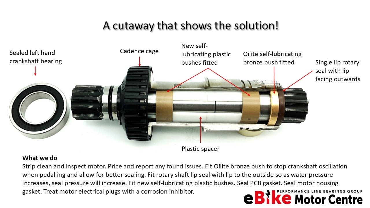

The wait is over! A more comprehensive explanation, reasoning and price will be on our website as soon as I have time. I cannot confirm a price on here as prices change, but in the UK this should be just under £200.00 Please note, the parts are not that expensive, but this motor is extremely time consuming.
Forgive me for being obtuse, Pete, but do I have that on mine?
View attachment 144527View attachment 144528View attachment 144529View attachment 144530
Besides all the other upgraded parts, it looks to me that the “single lip rotary seal” is one of the best solutions.
