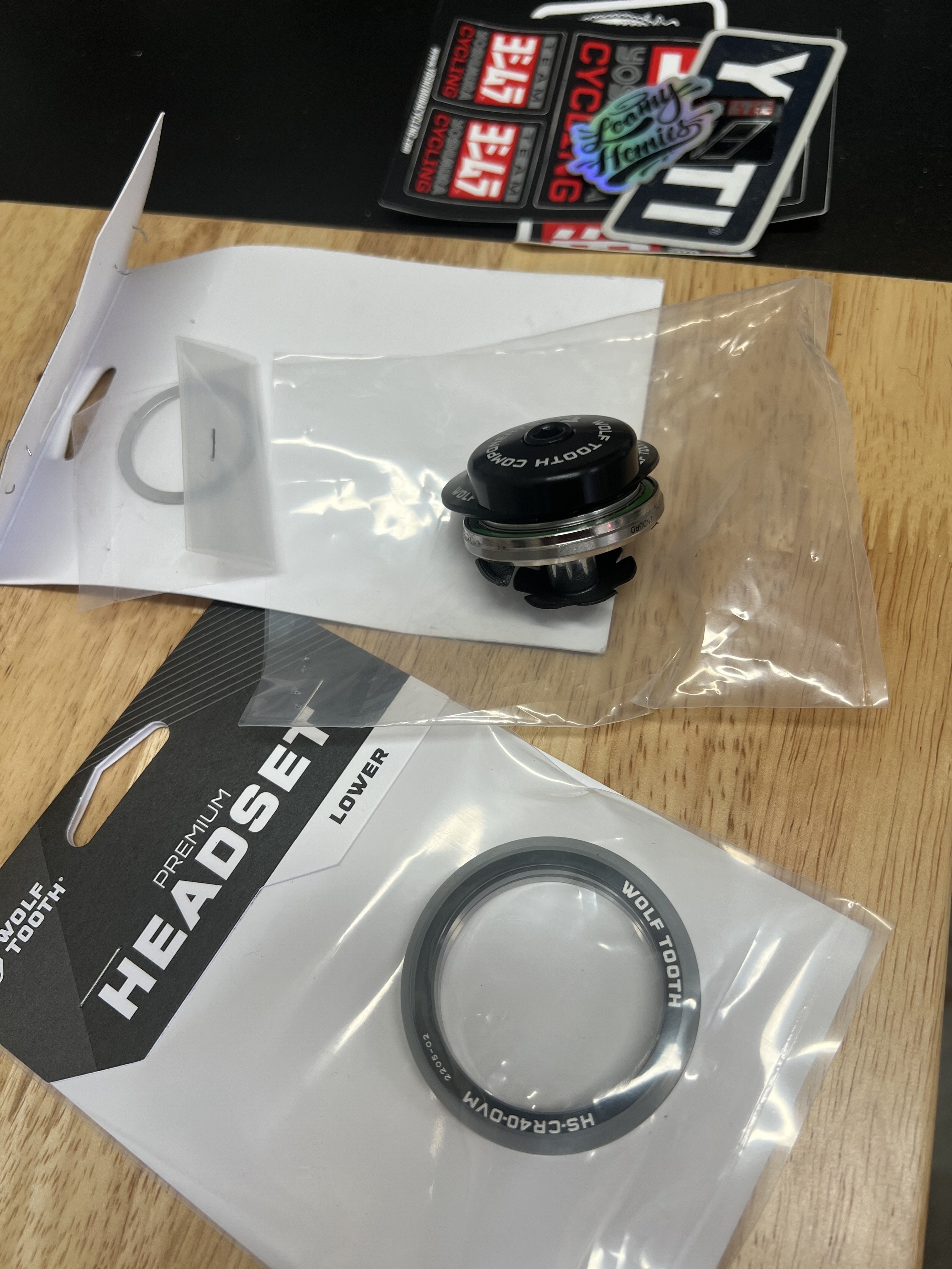

Wished the CK Dropset 5 would work withe the Levo at slack setting…
Since no, i went with Wolftooth. I’ll see how it goes

How do you find this upgrade - is it more "firm"?

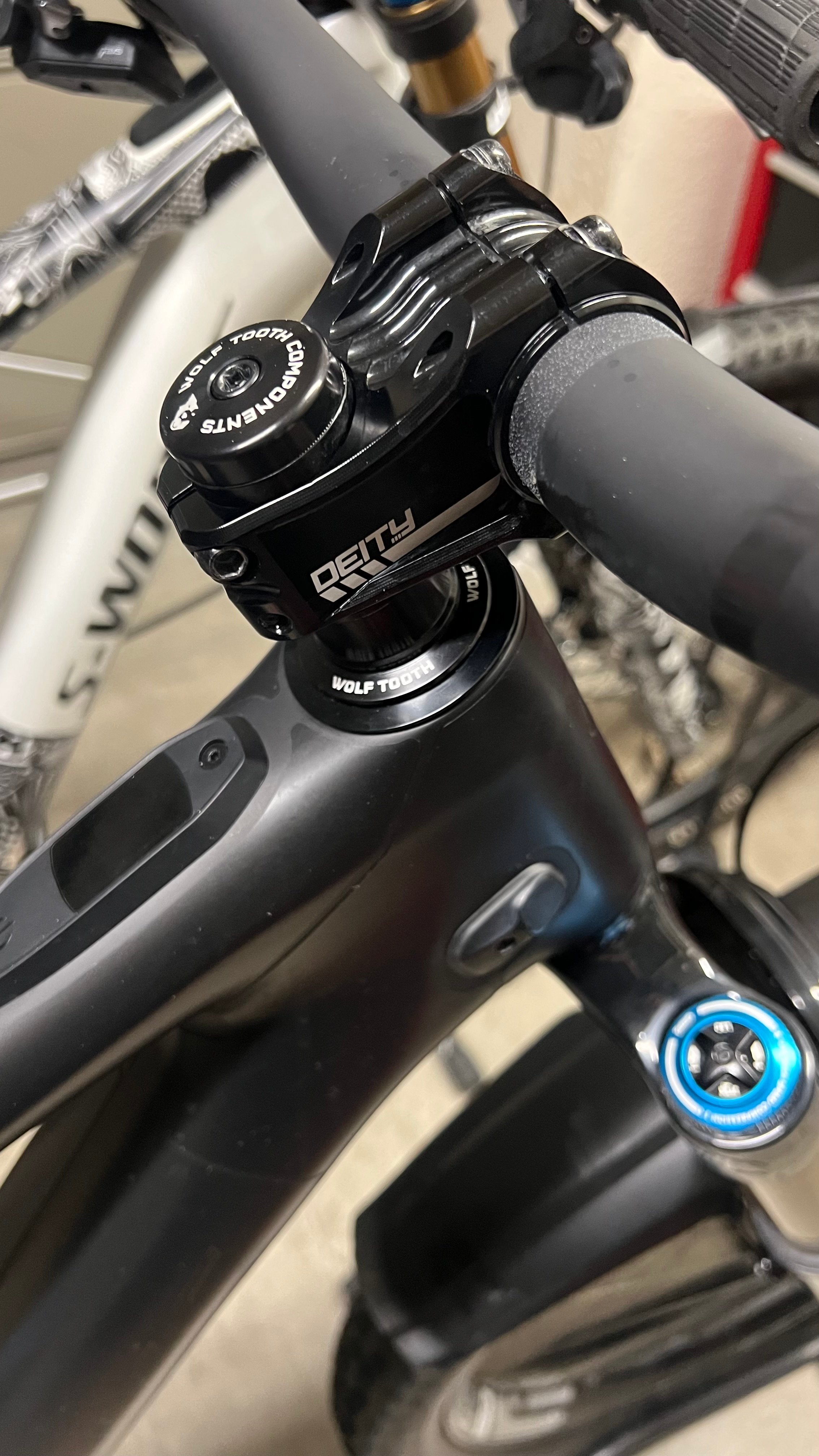

performs like any good headset i guess. Didn’t like the look of the stock one and didn’t like the fact i had to re-torque everything
i also don’t like the stock crown race. The wolftooth lower bearing come with a crown race that has a dust/water seal. I wash my bike often so good to have the seal
my kenevo has a cane creek headset, levo sl wolftooth and levo has the stock headset with cane creek crown race.

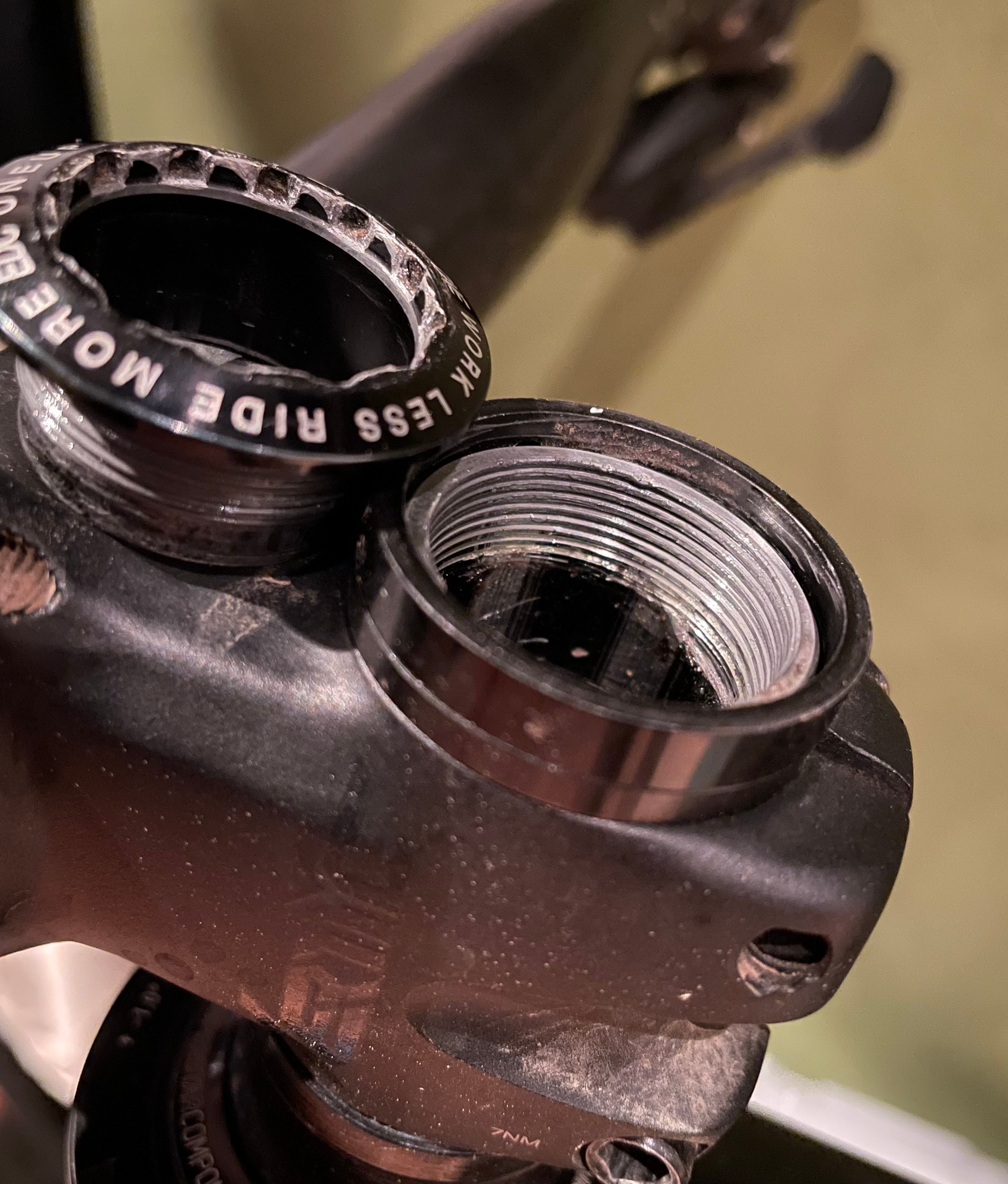

Continuing this, Berkshire cycles looked at this for me. They recommended this
Head Doctor - Head Doctor star nut replacement which looks as if it will now never move.
This was fitted but I havent ridden enough to know if its fixed it yet.
