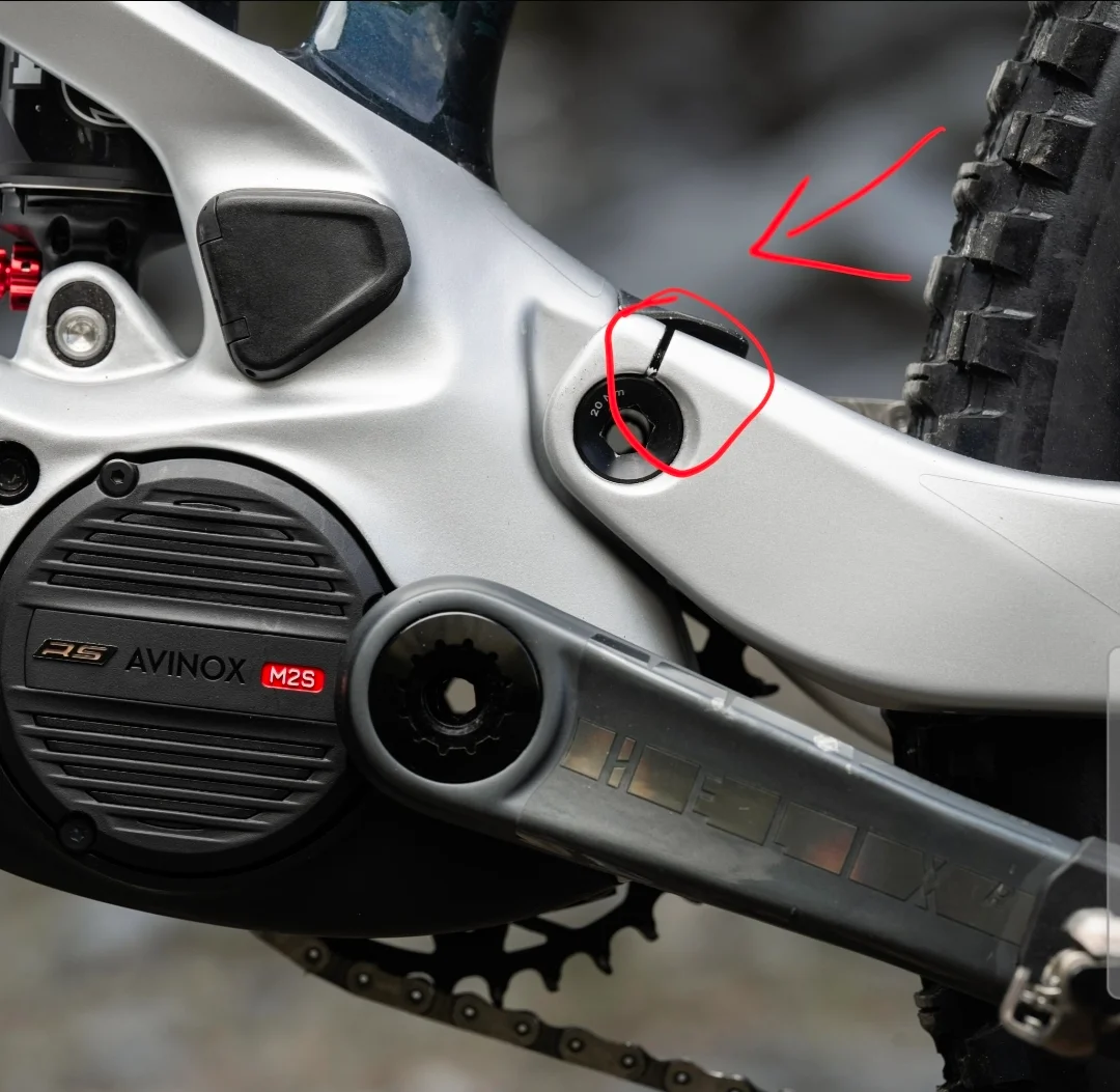

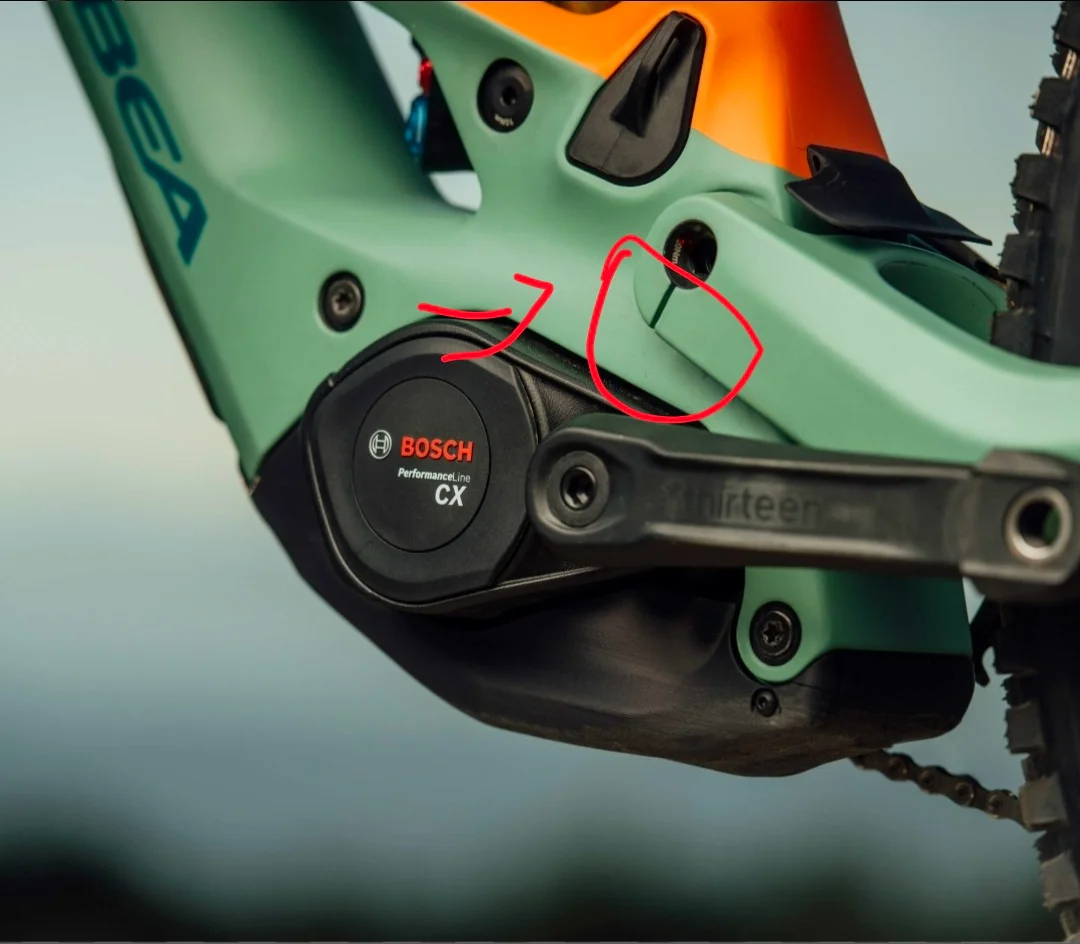

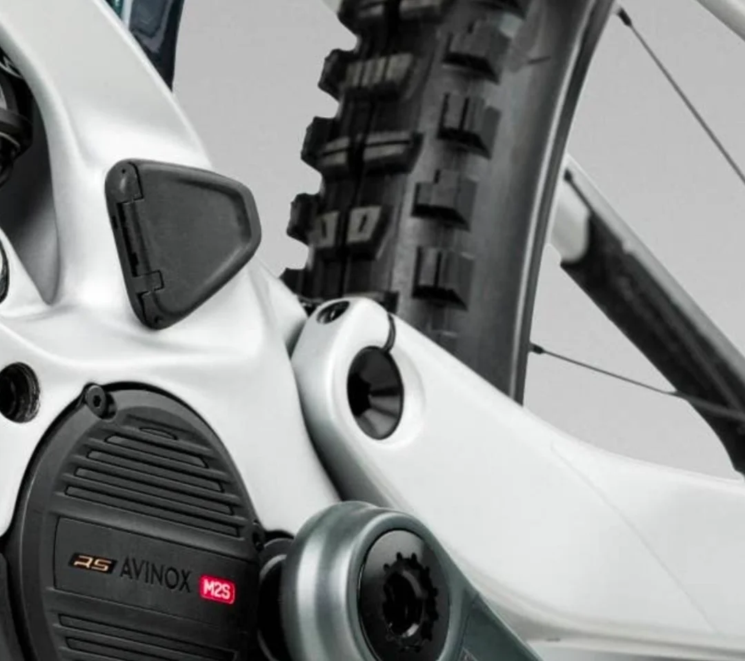

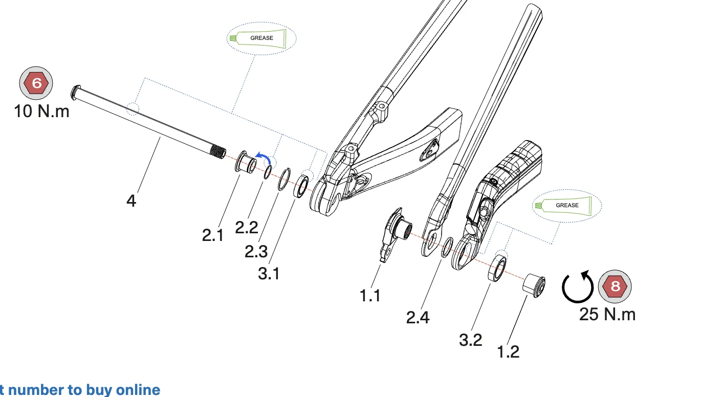

The last Wild had cheap/weak bearing hardware. Only one bearing per chainstay and no dust seals! Way behind competition! I hope they improved the hardware on the Wild LT. Has anyone seen or heard about bearing hardware upgrades from the last Wild? I don't see the new model manual on the Orbea website yet
