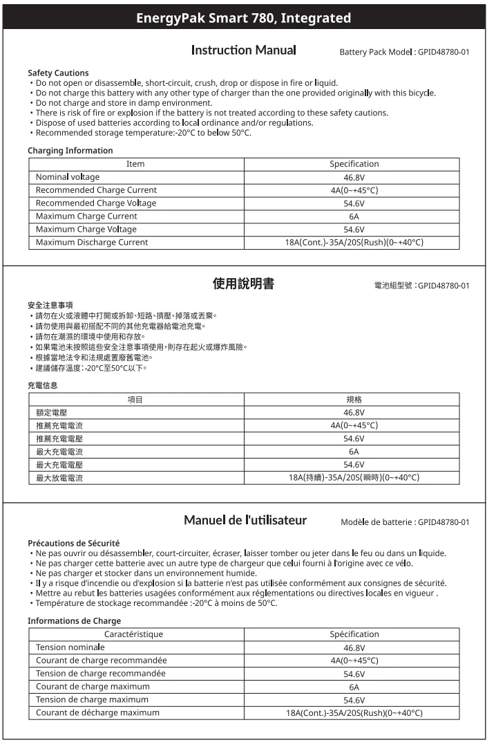

On Giant's official website, page 9 of the "EnergyPak Instruction Manual_V4"
there is 48v EnergyPak Smart 790Wh battery.
Is it will be used in the new 2026 Reign E model? or it's already being used in other models?

Good catch, I remember people catching information about the new 800wh in the manual too when the 22 Reign E+/Trance E+ were released with the 625/750 batteries.
Great news that Giant are getting back to offering full power/full battery ebikes and if you have the option to run the 560wh, everyone will be happy.
I'd heard that the new Trance was going to be 810wh but it could be 790. Hopefully the 48v bikes will have the option to run either battery like the last Reign and Trance. I have 625 and 800 for my 2022 Reign and it gives good flexibility.

No, that info is for Momentun Cito: Cito E+ | Momentum Bikes US that bike use 780wh battery 48v
As far as I know, the new Trance will come with 840Wh
