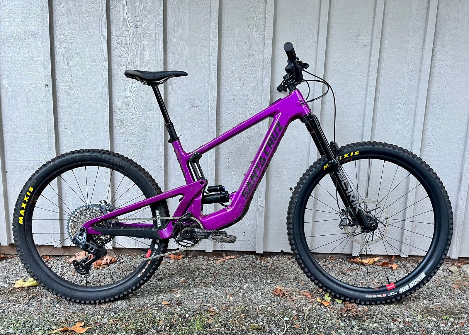

RS Ultimate suspension. Code RSC with Trickstuff discs and pads. SRAM X01 cable group with XX1 chain (for all black). DT XM 481/EX 511 rims with DT 350 hubs custom wheel set. Old Newmen Cockpit (SL Alu parts).
Don‘t care about C vs CC weight because of the E. But I don‘t like the C/CC concept. Specialized is better in this regard.

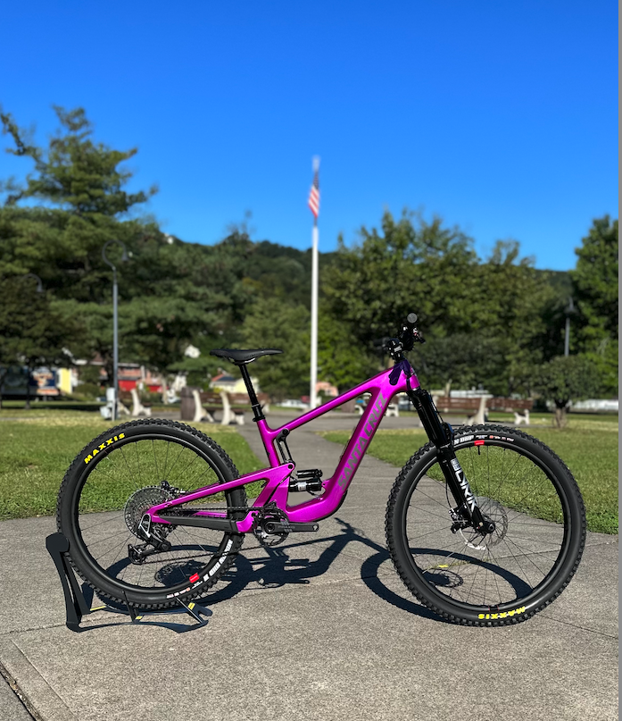

just got mine in the other day I got the x0 reserve cc build had a chance to get a few rides on it , before this model I had a pivot shuttle sl team build , quick comparison if your a very aggressive rider that loves the most rocky steep tech terrain the heckler sl is for you the bike smoothes out the trails night and day compared to the shuttle sl , for me jumps totaly amazing compared to the shuttle the heckler sl wants to pop off everything the suspension is much more active with the Rockshox ultimate front and rear on the other hand the pivot is about 3 lbs lighter gets up to speed alilttle quicker and maintains it with the full 29er but once the trails get rocky and steep going down the shuttle sl quickly reaches its limits with a very nervous rear I tried a ext storia coil which calmed it some what but in this dept the heckler sl is night and day calm controlled flattening out the gnar, the shuttle sl you will need better line choices compared to the heckler just flattening out the line I will take the more poppy and playful mullet setup vs the full 29 on the pivot for me jumping smashing rocky gnar and just poping off everything the trail has to offer is the perfect sl for me , I would have to say for my style of riding the heckler sl hit all the boxes the shuttle sl is a great bike to but thats depending on what the rider wants out of it ,so far I love the heckler sl it was money well spent and cant wait to get back out there again and push its limits more ,fazua ride 60 new firmware updates finally got it right since the Santa Cruz launch of the new heckler sl , smooth power , dead silent and much better super impressive range , hope this small review helps some sl owners .

Yessss.... from where did you order? I've got the GX build on order and am (im)patiently checking my order status every day. Nice to see a bike that's landed.
Piermont bike in ny has a gloss magenta instock gx medium build ready for pick up today ask for sunny and tell him al recommend you he will take care of you he's a great guy , if you need another size and build kit let him know he gets them fast , your gona love the bike .

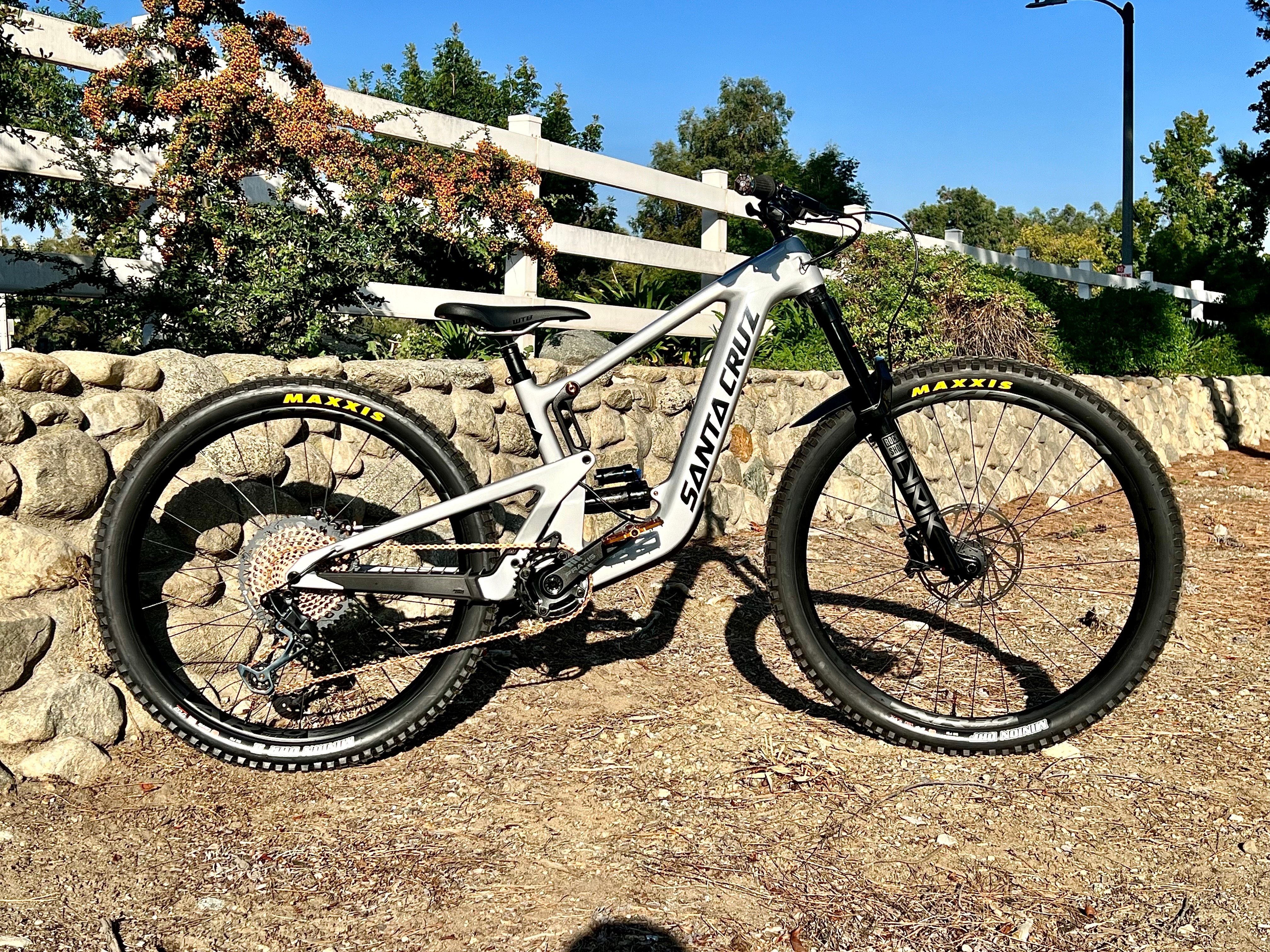

Picked up my Heckler this week. Did 30+ miles at the bike park. Geez this thing is fun. Really loves to jump and pop. Handles rough chatter so well. The FAZUA motor sits right where I expected for a SL, but had plenty of kick. Think all in all sits about 41bls given I did a lot of mods that got it little lighter but we are taking not by much. This is the “C” build size small.
My last bike was a LIV Intrigue Advanced 27.5. I’m 5’3” and generally had issue with bikes feeling too over the bike. This bike you feel very “in” it due to the geometry. I was wanting a little more progressive geo, mullet, light enough to lift over the tailgate of my truck but would get me up the hill. Love the Lyric fork with the damper 3, so smooth! This thing is fast, loves it rowdy, loves the bike park, and hit every expectation I had for it.

Nice! What mods did you do?
Swapped all the bolts to copper, matching copper cassette and chain, added my carbon bars, put my Rev grips on. 5Dev pedals. I want shorter cranks (155 or 160), but 5Dev is still working on the FAZUA 60 cranks and expect them to be able to ship soon. There is no frame wrap yet for this bike and my bike shop did a banger custom wrap that’s flawless. 👌🏼
