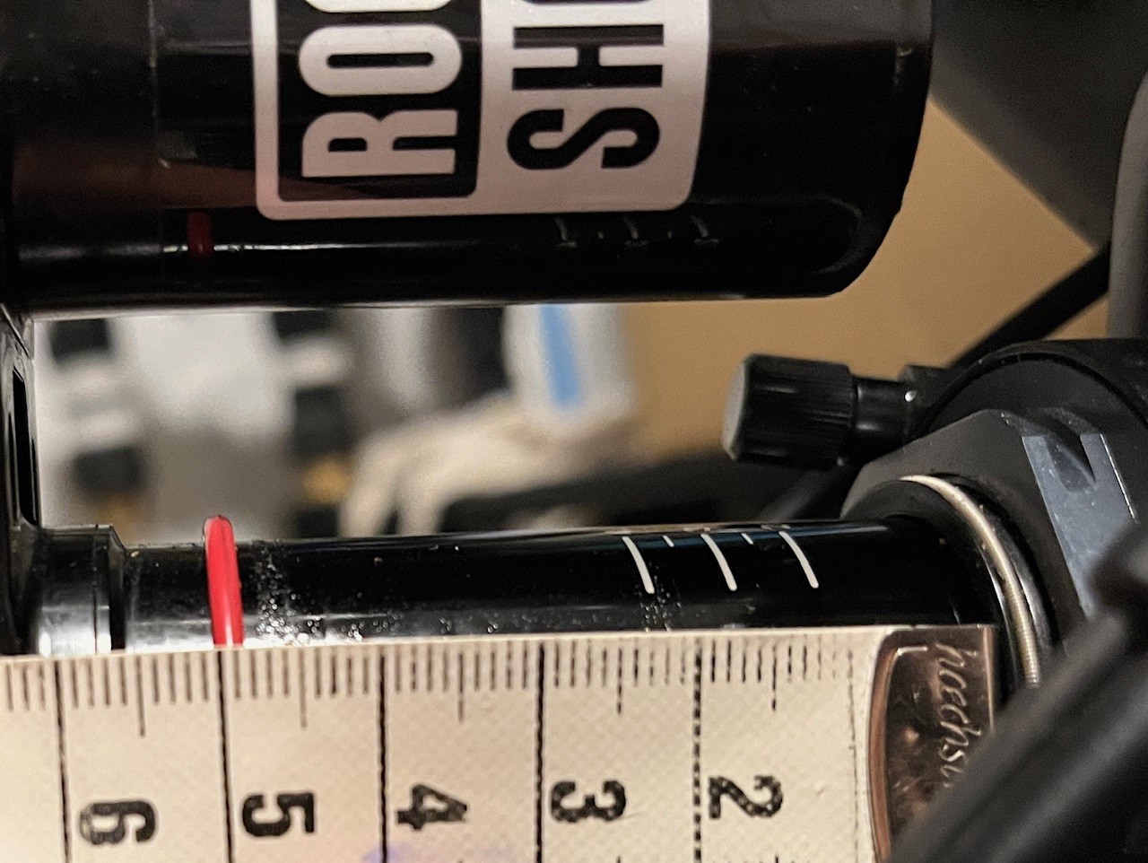

The stock performance is already really good, I'm happy with that. But I struggle with the utilization of the full travel. The last mm are not used, even when HBO, LCS + HSC are adjusted to fully open. Also with released air and full body weight sitting on the bike.
HAve you measured it to see how much it's using ? Not all shocks/forks have the 'end' of the travel at the end of the sliders etc... So it could be that it looks like it's not, but it actually is ?
At full bottom out, the O-ring will not reach the end of the stanchion, there's about 1-2mm of free space in reserve (roughly a bit more than 1 O-ring's width).
On both my Vivids with C37 tunes, I run 2 tokens, 30% sag, and HBO fully closed / +, it bottoms out on any jump over ~3'/1m but I can't feel it because it's such a memory foam feeling at the end.
Looks like there are 50mm of travel in use, same result without air sitting on the bike. 1-2 mm should always be free, ok. But the last 5mm are missing according to the measuring tape. However, 55mm should be available :unsure:
