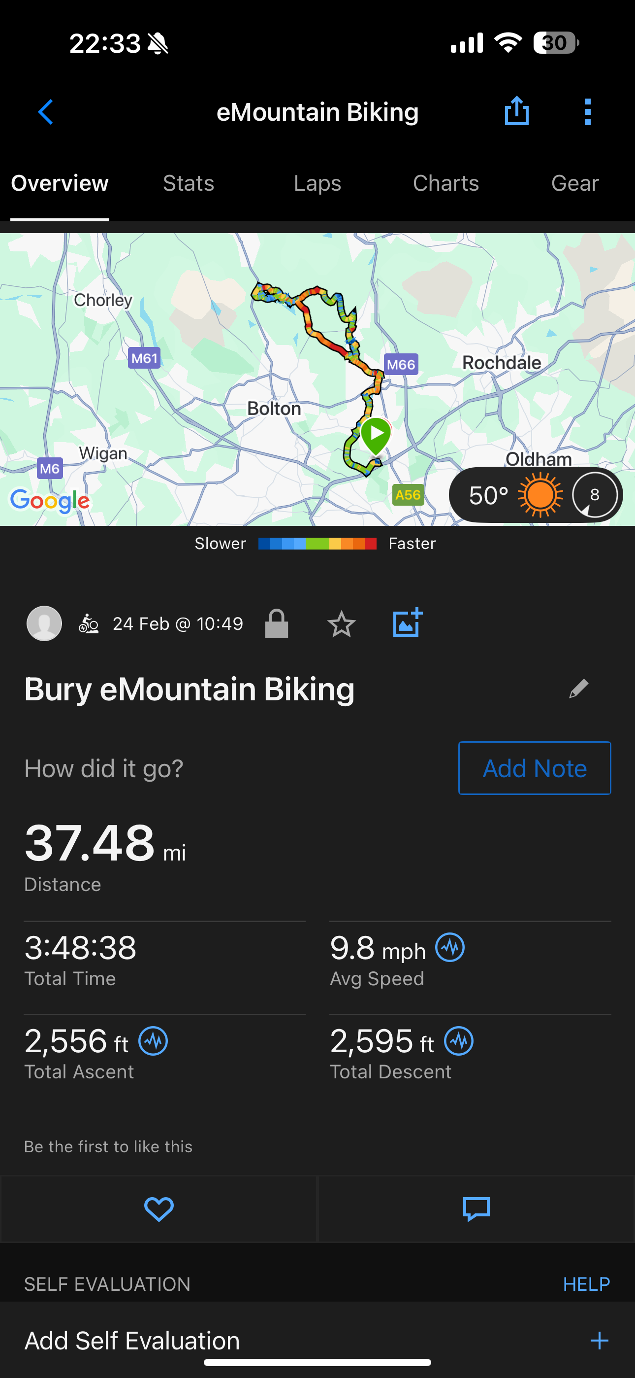

regarding range, I found it pretty interesting, that when riding with my buddies on a bosch (when they are riding on turbo, and I am riding on turbo), we get more or less, the exact same range, with more or less, the same % left. Of course, I am putting out more power, with more battery capacity, but still...its pretty much the same.
That’s really interesting. I would have thought I would have to drop power down when cycling with my friend who has Bosch cx motor. But based on what you are saying may be not. Because was worried I might not get same range as him because the power off the amflow in turbo is higher.
You mostly won't ride in turbo. I can easily keep up with my Levo in turbo by riding in trail on the Amflow. I did some timed tests up a 2.5km climb and the Amflow in trail still slightly beat my Levo times.

Also in my tests yesterday I repeated the same climb 4 times. 2 in turbo and 2 in trail. 2.5km 250m elevation. I'm 100kg in kit. Average gradient was only 7% though.
Trail was 8 minutes and used 8% battery.
Turbo was 5 minutes and used 12% battery.
My Levo times are close in turbo to the Amflow in Trail.
So I use 50% more in turbo than trail, which makes sense. You'll still hit the boost button occasionally, which is quicker again, just to see the look on their faces as you sail past them. :)
