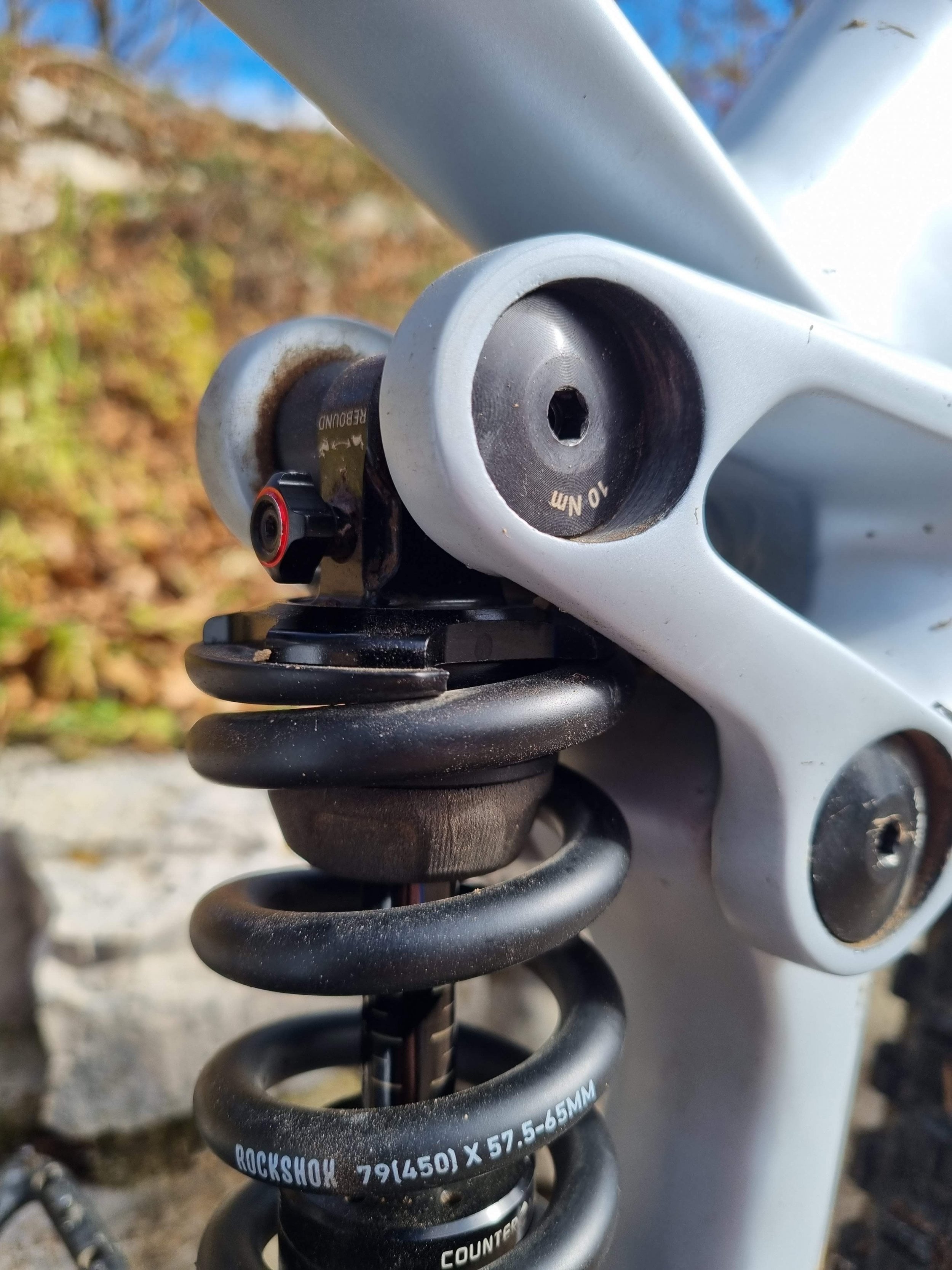

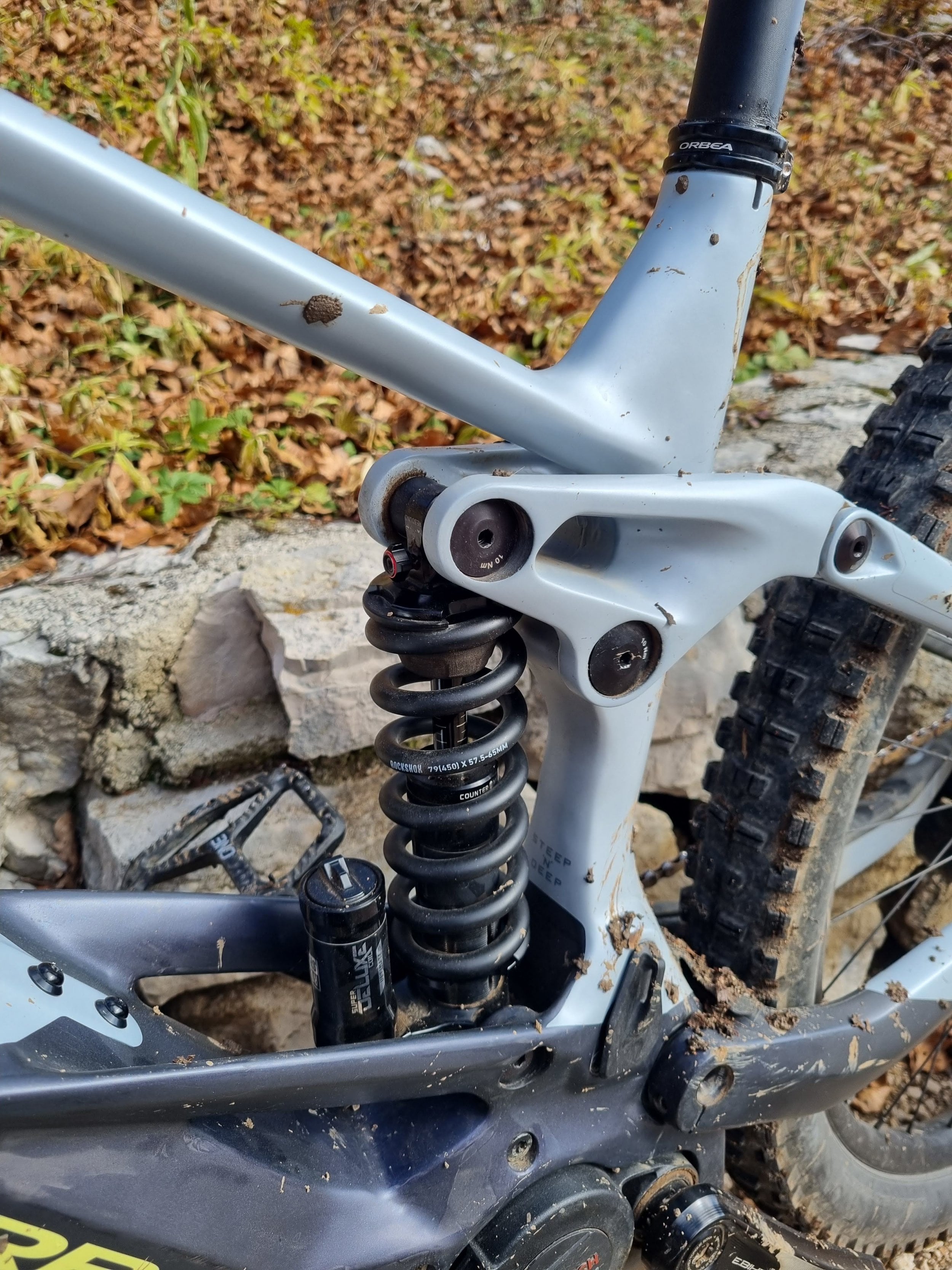

I replaced successfully the air shock in my L M10 Wild with a Rockshox super deluxe coil RCT, using a 450 lbs coil (my weight is 82 kg).

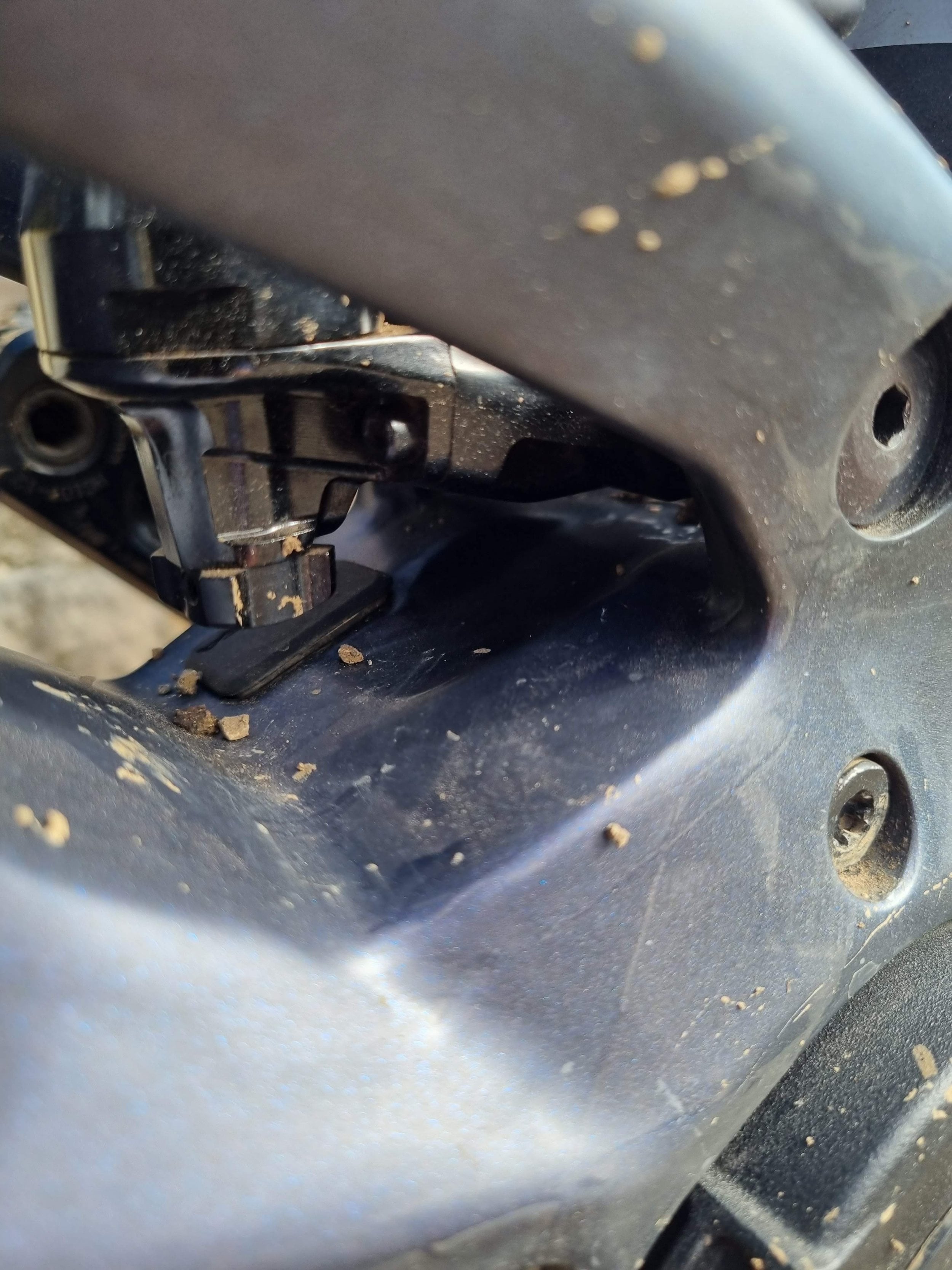

What year shock? I had a brand new sdu air on XL Mteam and it hit the frame on full compression. Curious if you have any upclose pics of the shock installed and at full bottom out. Thanks
It's a 2022 model. I'm attaching some pictures taken today. Sorry, I don't have pictures at full bottom out, never experienced.
