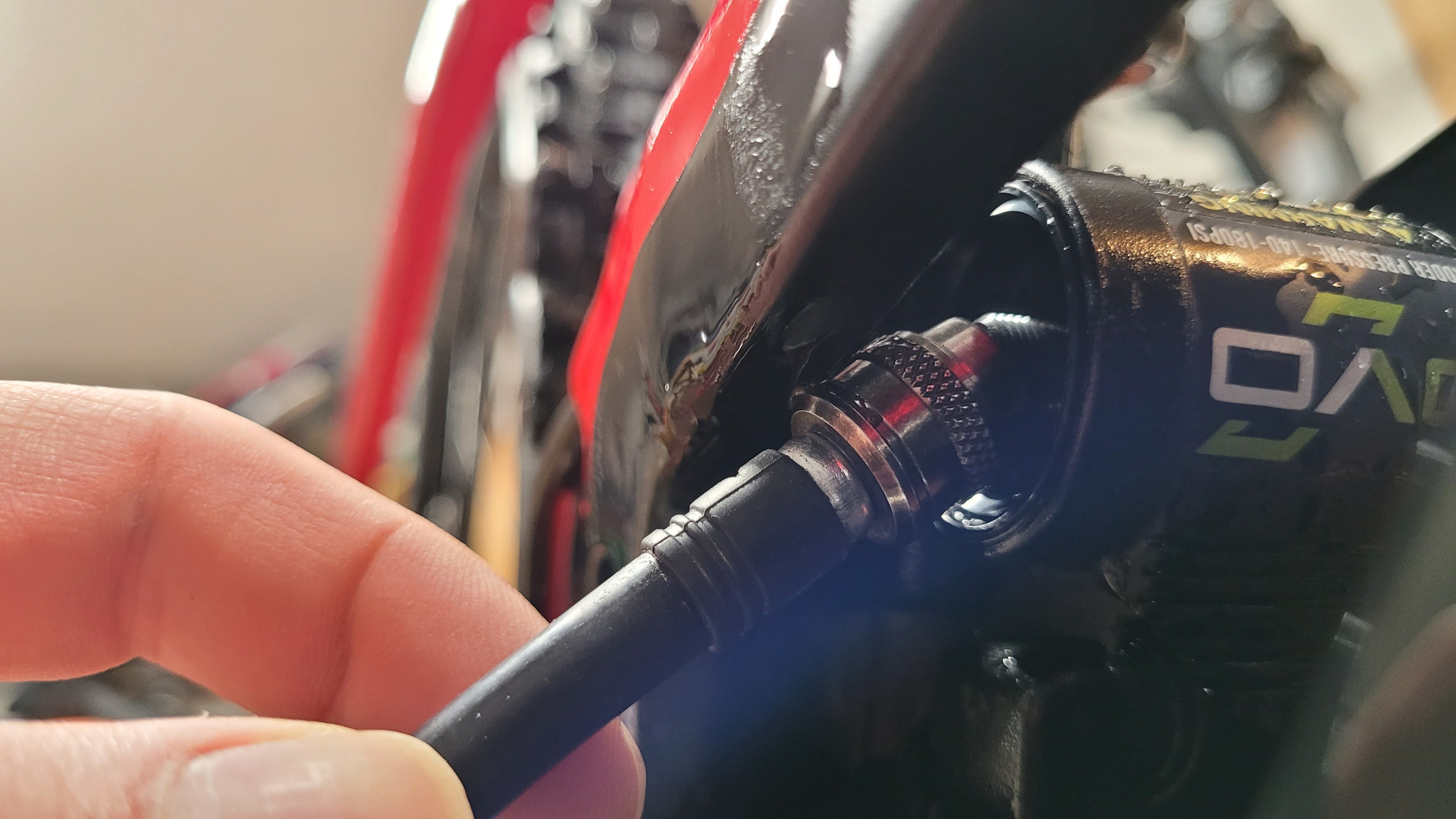

Old thread, I know, but I just wanted to drop a comment for anyone else who like me had help from this thread:

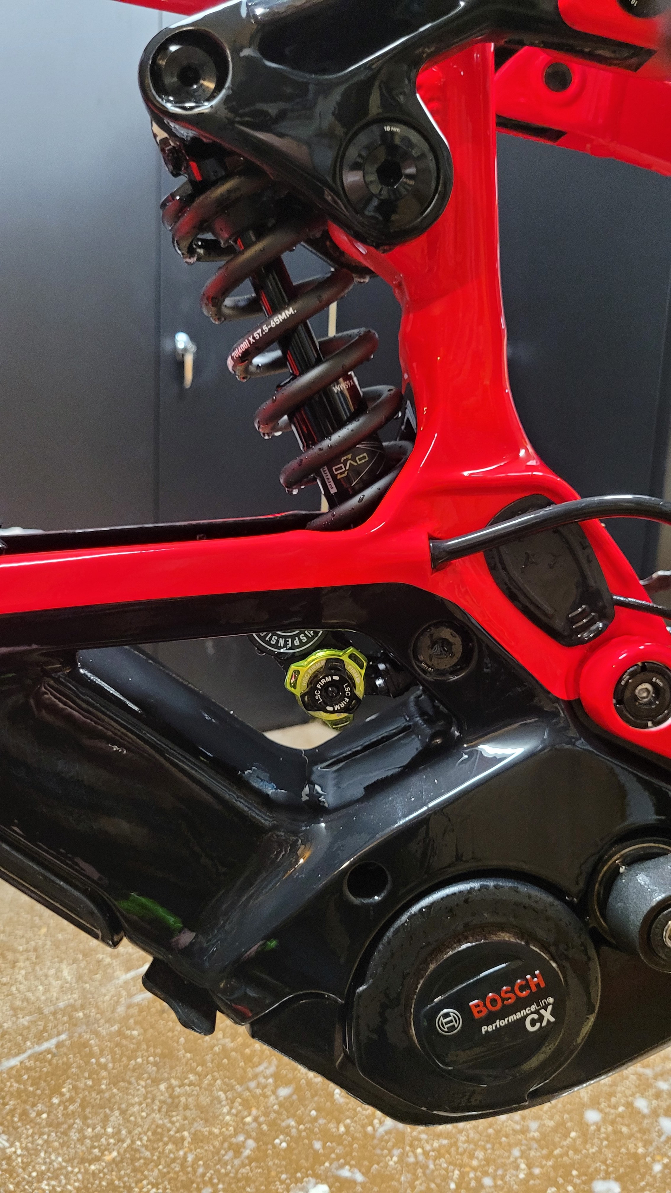

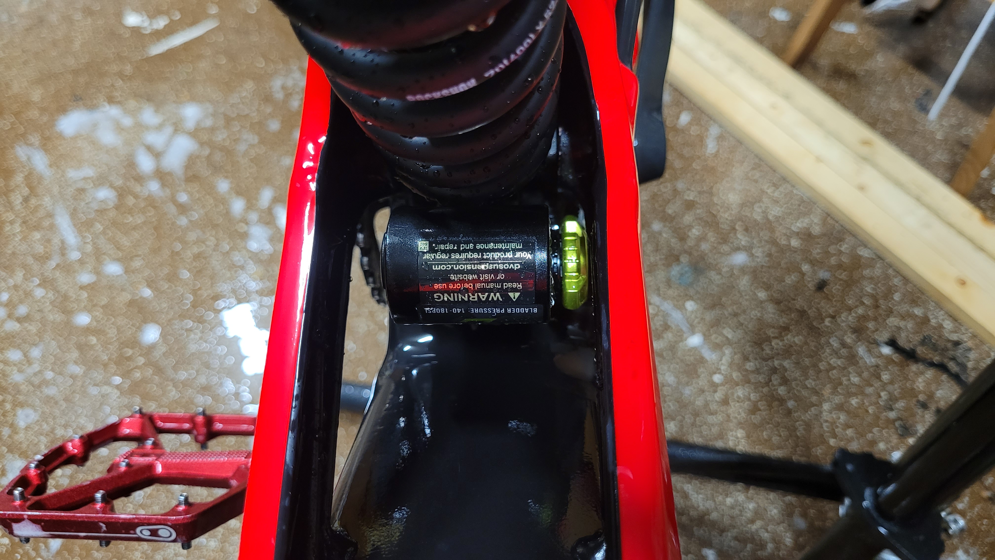

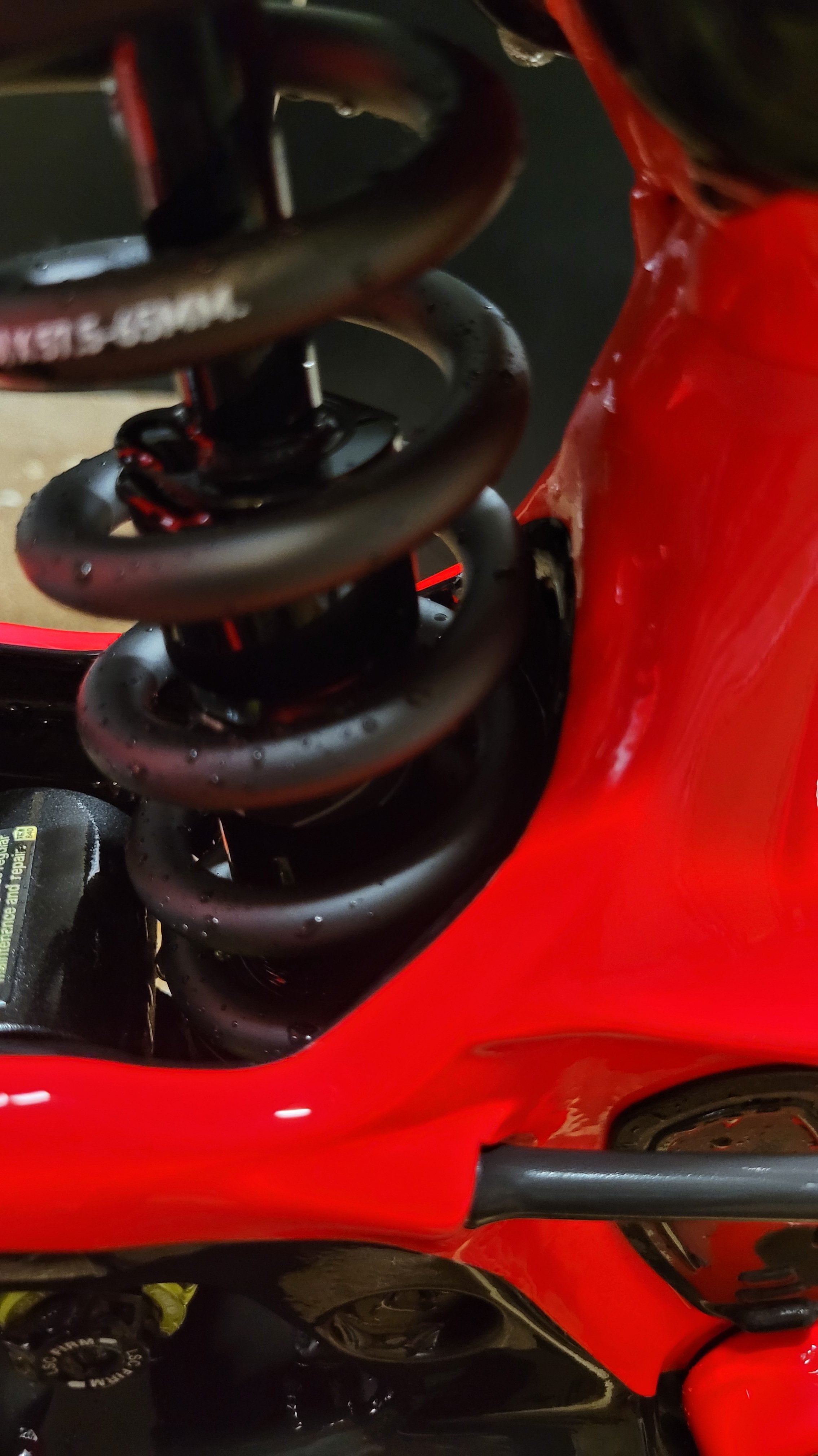

I have the Orbea Wild from 2020, so also one with the lower cross beams. It really looked like the DVO Jade X Prime should fit, from pictures, I even scaled a picture and measured to my bike. So I pulled the trigger and purchased one, and it fits perfectly. All dials are easily accessible, the only issue is that the valve for the bladder is not accessible without disconnecting the top bolts. However, that is easy enough, and then both bladder pressure and replacement of the spring is a breeze to change in a couple of minutes.
So in conclusion, the answer from DVO that all Orbea Wild models with lower cross beams cannot fit the Jade X Prime is wrong. Not sure if the Wild geometry is the same all the way up to 2023 or if something happened earlier, so make sure to check that, but 2020 works! 😁
20250422_203137.jpg20250422_203158.jpg20250422_203209.jpg20250422_203725.jpg20250422_204118.jpg

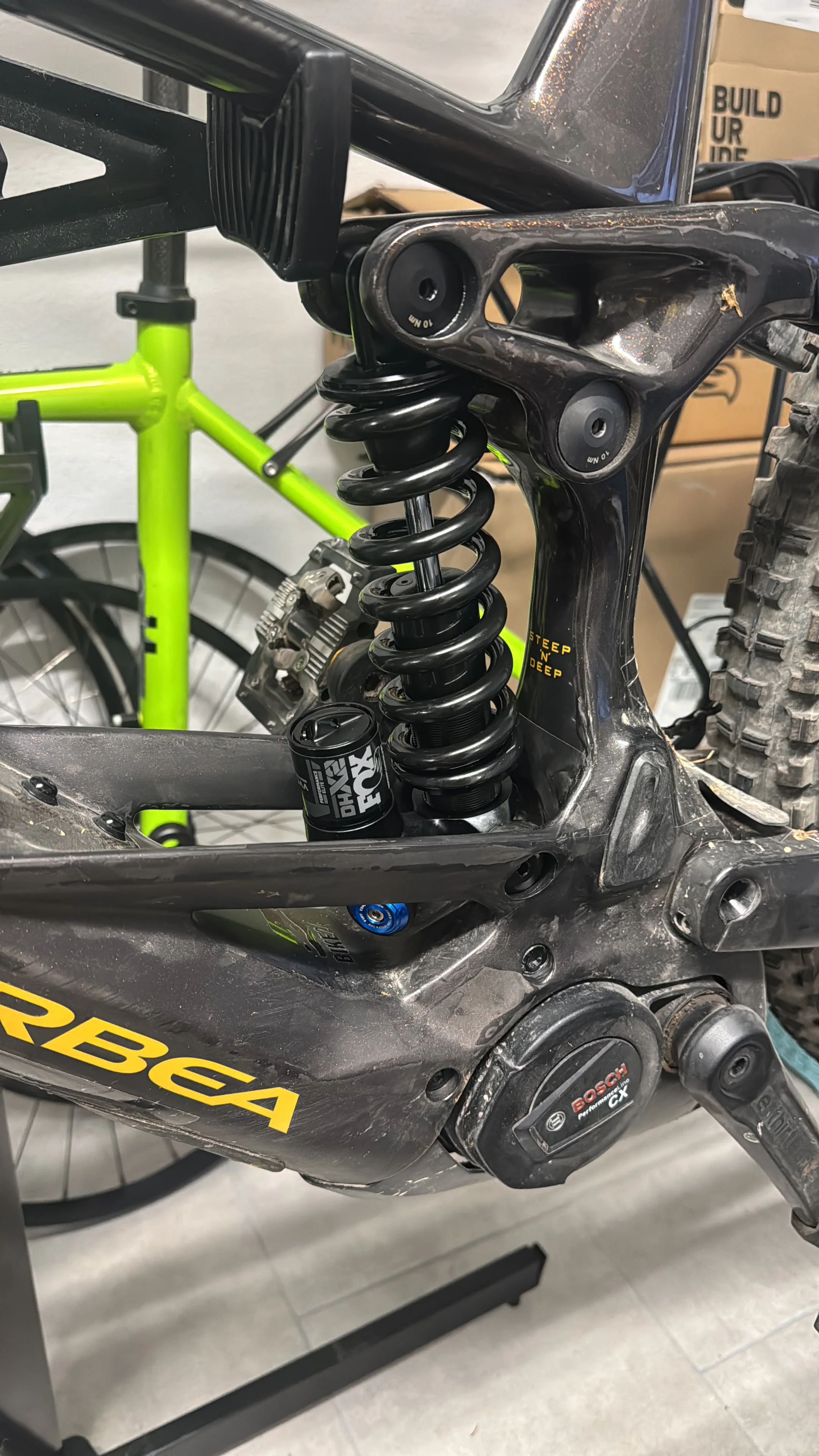

Hi i would like to ask if the rockshox super deluxe select+ with HBO will work on the 2025 model i see the frame of 2024 and 2025 wild have difference shock clearance
