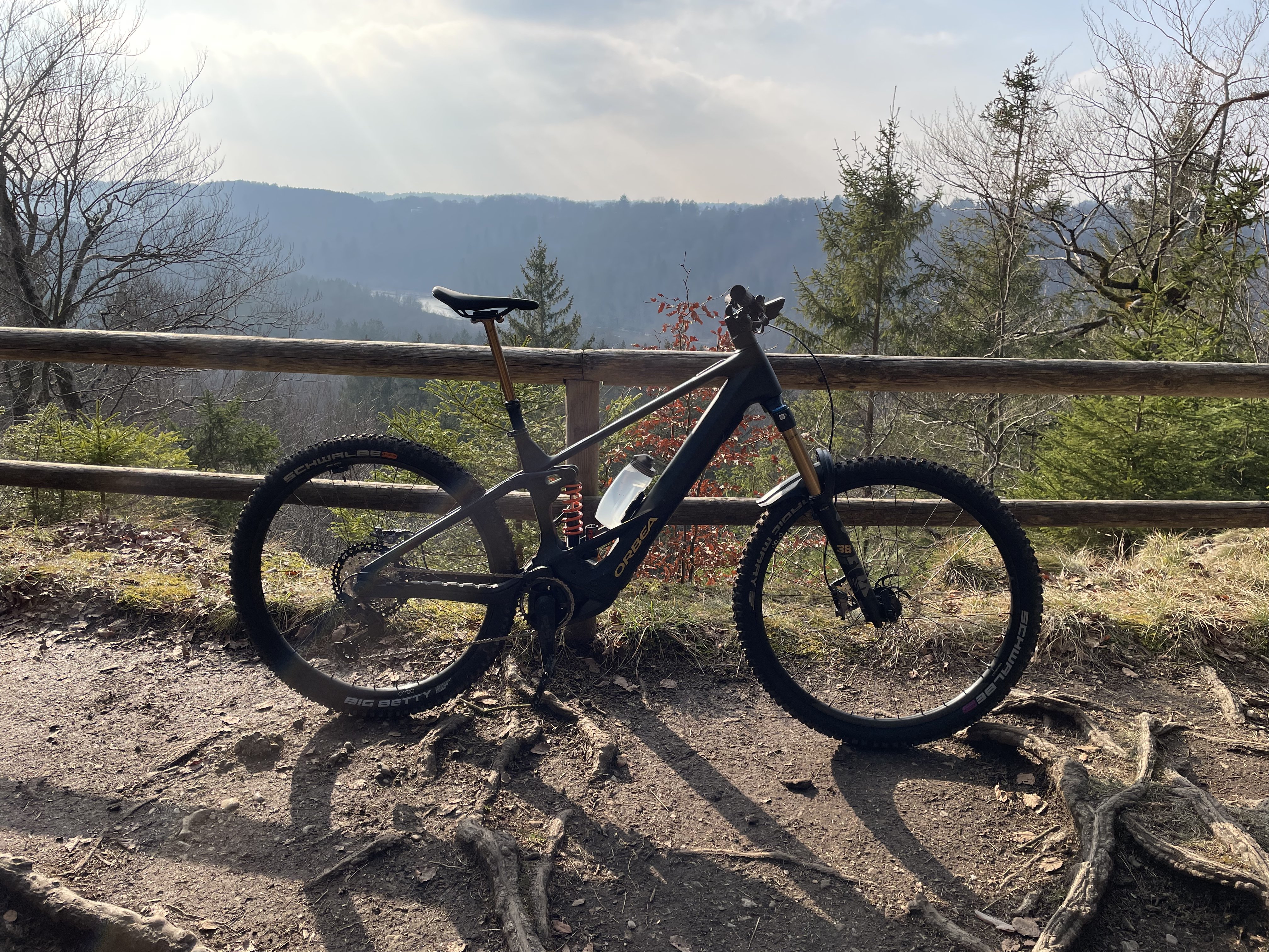

First ride….super fun!!

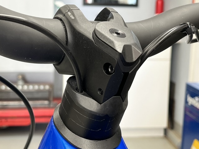

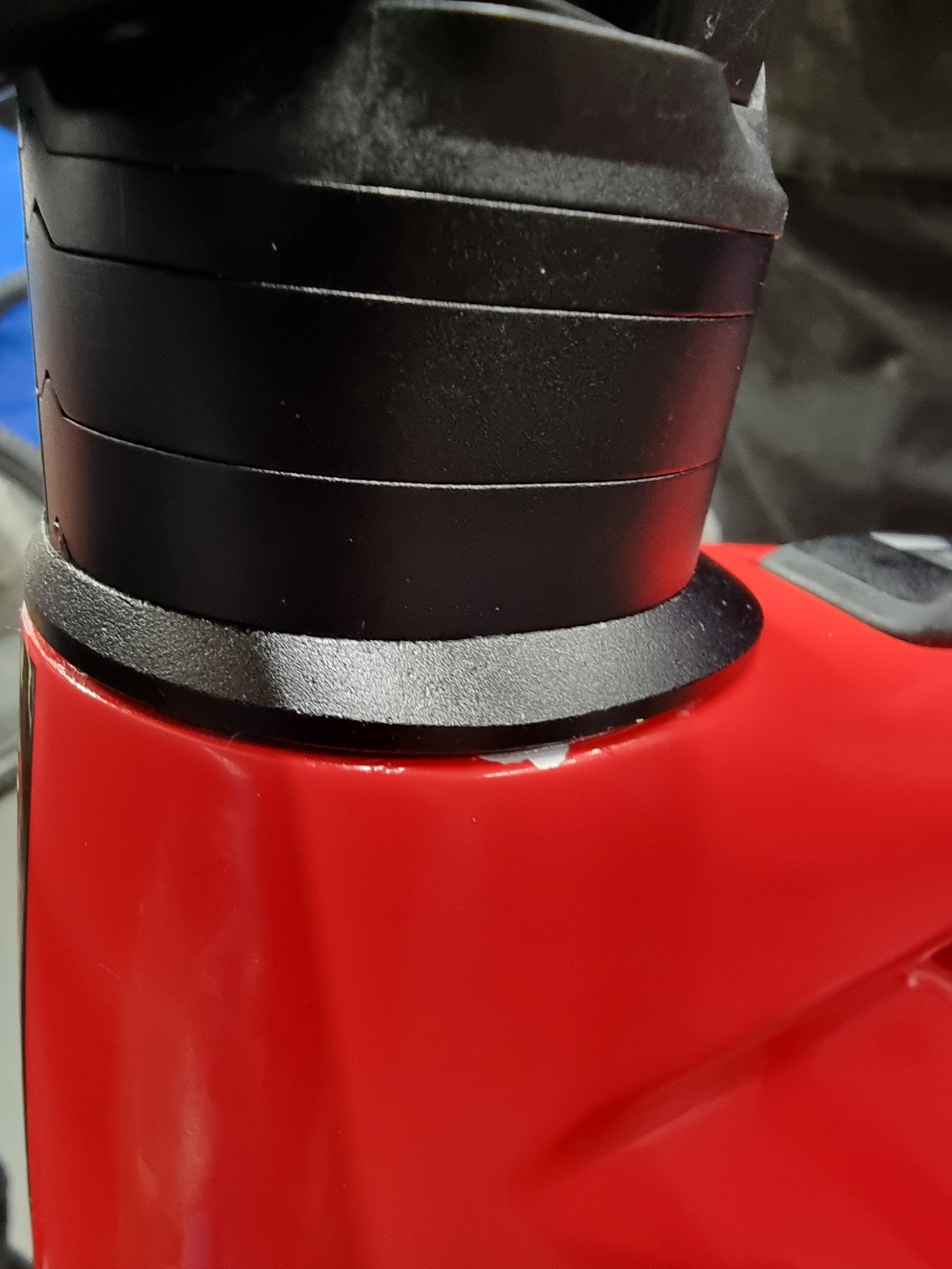

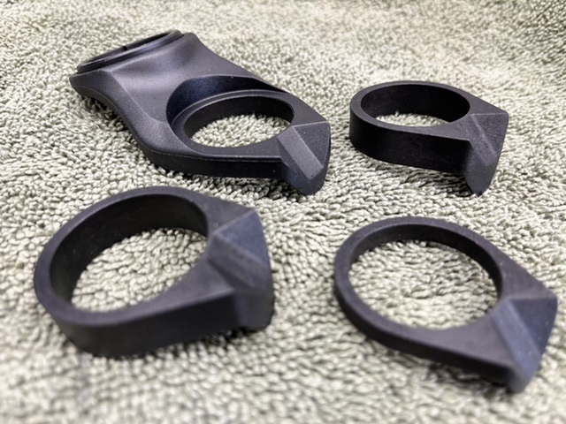

View of the interlocking spacers and extra pieces included with my bike….

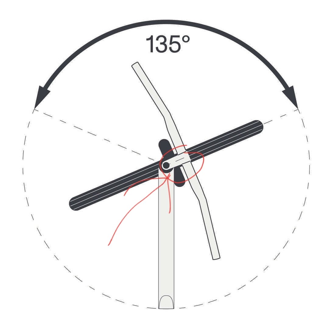

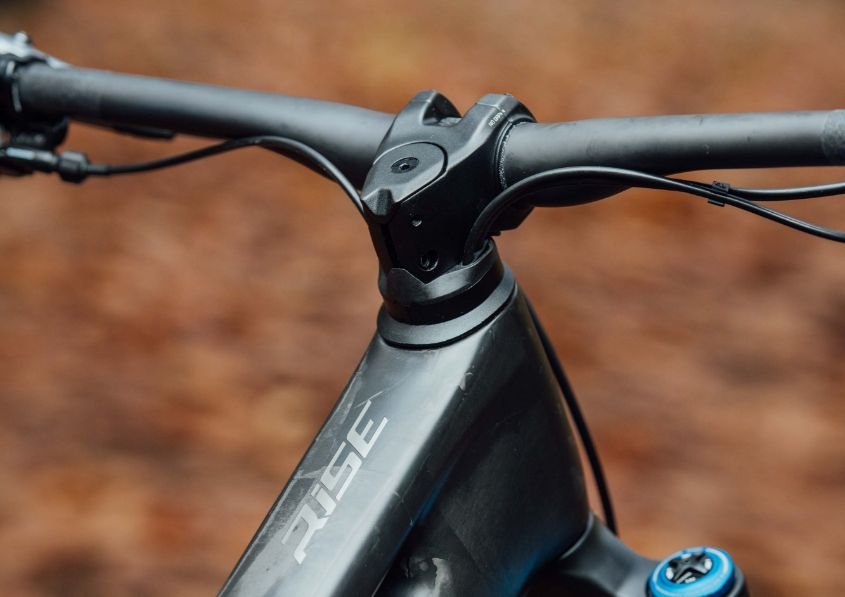

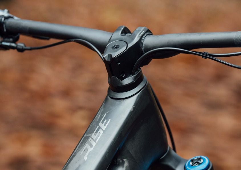

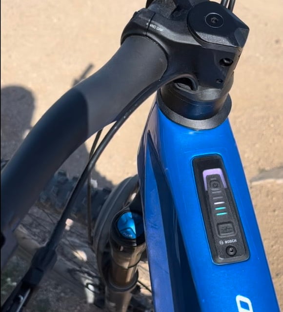

Hey a quick question...I am not that familiar with these new designs for running cables through the headset area.
Am I thinking wrong or right about this...would the cables get pinched by the stem turning as a consequence of a crash?

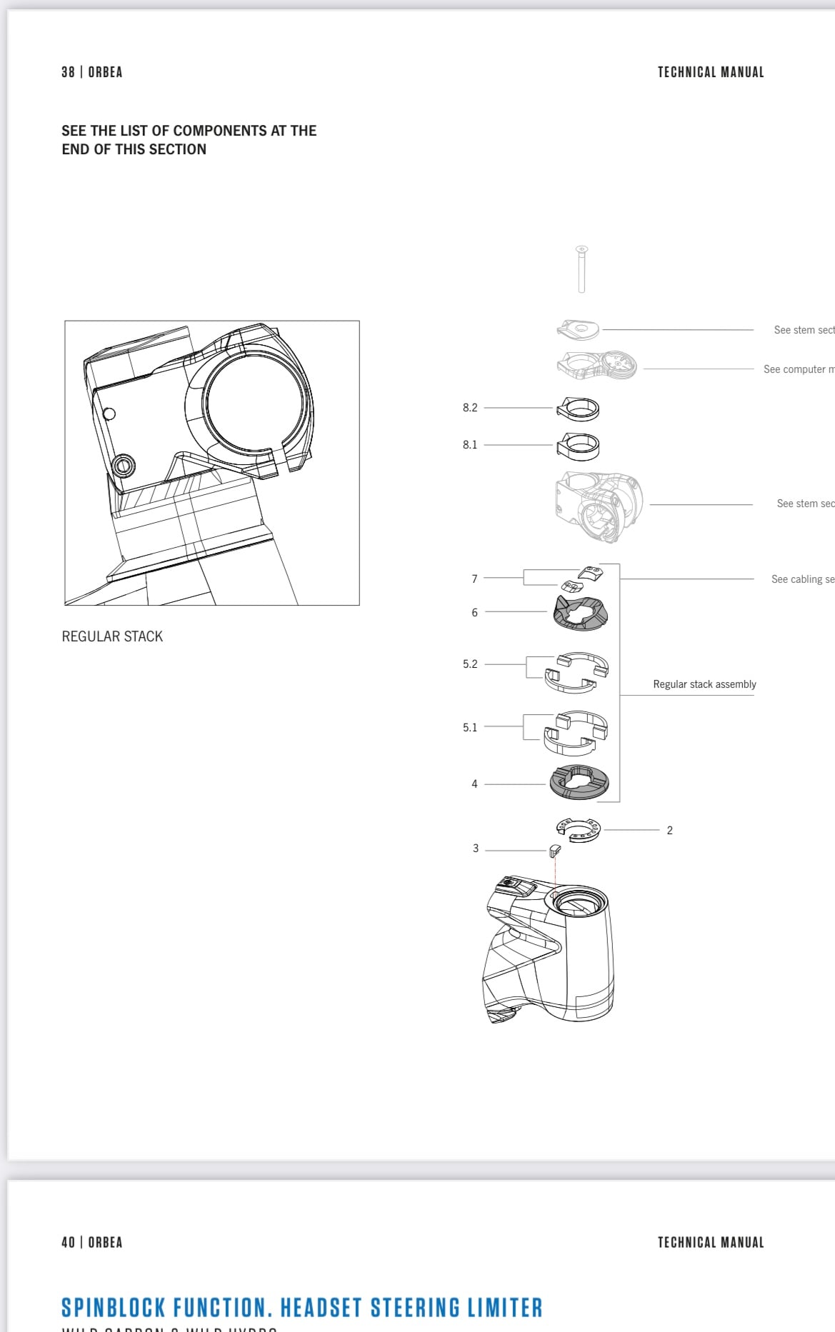

Per Orbea:
Spin Block Protection
Crashes happen when you are pushing hard. Our light and simple Spin Block prevents the handlebars from over rotating and damaging your beautiful frame.
Per Orbea:
Hey I think you didn't understand my question. I know what spin block is for, to protect the carbon frame from a fork CSU or handlebar hitting it.
I am asking about damaging the cables and brake hoses because If you crash hard enough the stem which is holding the handlebars can rotate from the force and looking at location of the cables going in on both sides of the stem and just under it, if I am right the cables and brake hoses are going to get damaged/pinched which is not a good scenario as sooner or later we all crash...
If the spin block stops the bars from over rotating then I’m thinking it will prevent cable damage?
I am guessing Orbea is using the Acros block lock headset rebranded with their name.
The sole purpose of these block headsets is to limit steering angle and nothing else if I am correct.

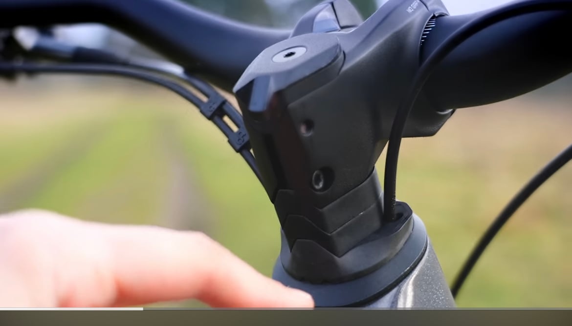

If you look at the picture you can see that even when the spin block (or whatever it's called) does it's job - limits steering angle, the force of a crash pushing on the handlebars can force the stem to turn even further...any serious mtb rider has had a crash where the handlebars twisted because the stem turned.
Cables on the Wild/Rise are so close to the stem that even a slight movement of the stem could pinch the brake hose.
The only way this would not happen is if the stem is somehow connected to the spin block headset, which I think it isn't?
Maybe it's easier to understand what I mean in this video where you can see that the stem is not connected to the spin block headset.
Why don’t you ask Orbea? Seems you are going a long way for an answer that may be very easy to get….
Ah, yes. I see what you're asking now....

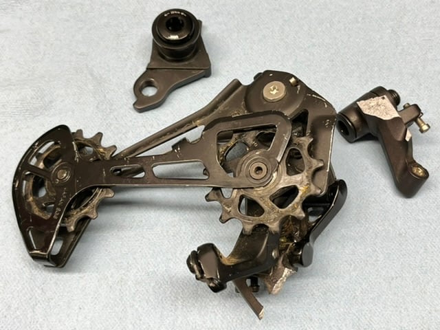

Oh, and a rock bit my derraileur in a freak hit today…. ☹️View attachment 109538

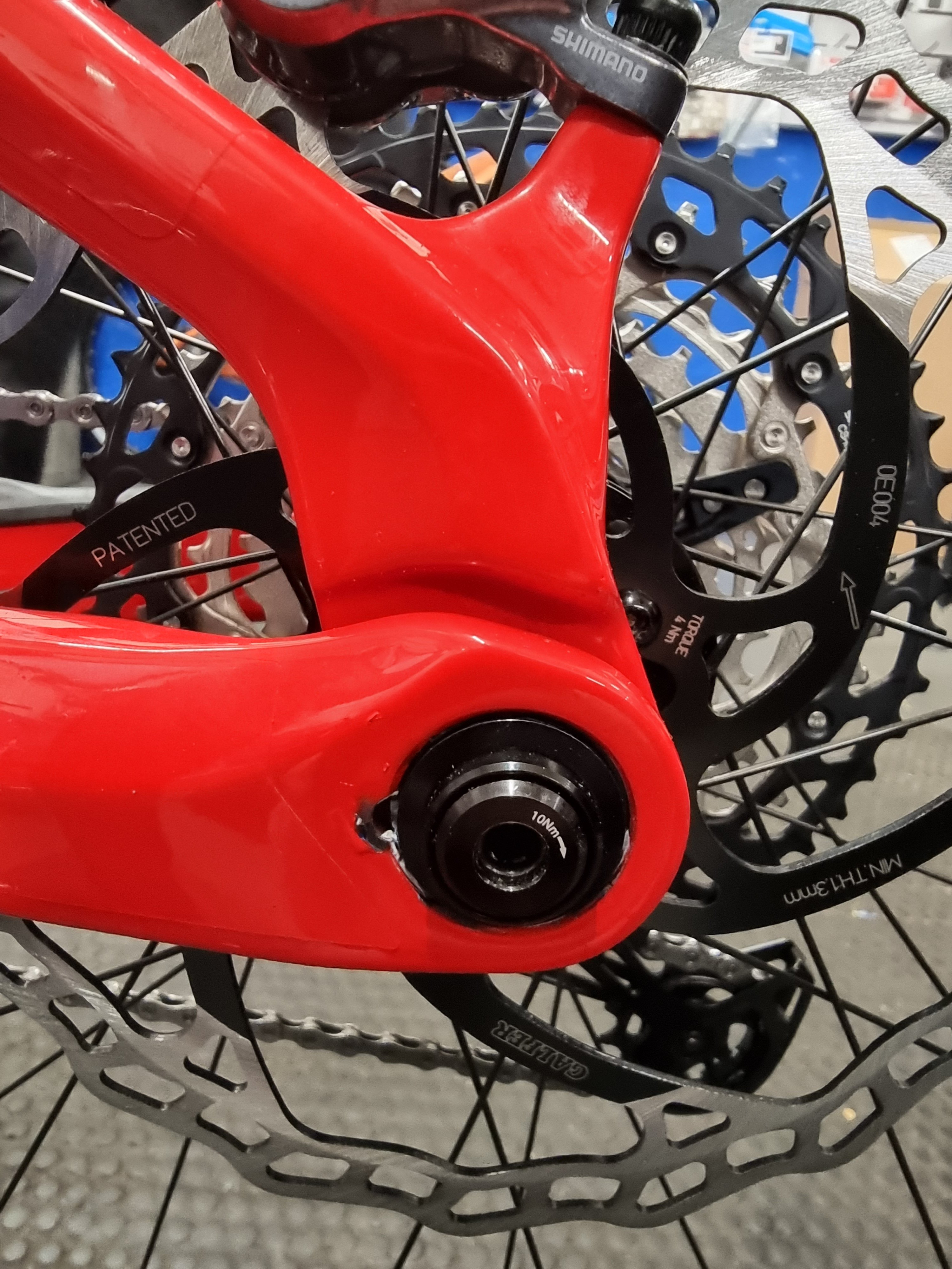

The bike shop I had my new wild M10 delivered to this week have left me a voicemail saying there's an issue with my bike that they've just built. Hopefully nothing serious but I'll call them tomorrow to find out.
Will keep yous in the loop if its anything significant. Just wish they'd said in the voice msg :/
**pics of how my bike arrived from Orbea. Absolutely gutted tbh, can't help but think it left the factory in this way due to the location of the damage but who knows**
View attachment 109813 View attachment 109814
What’s the remedy? Sorry to see that. We wait a long time for these bikes. QC is paramount, Orbea!
