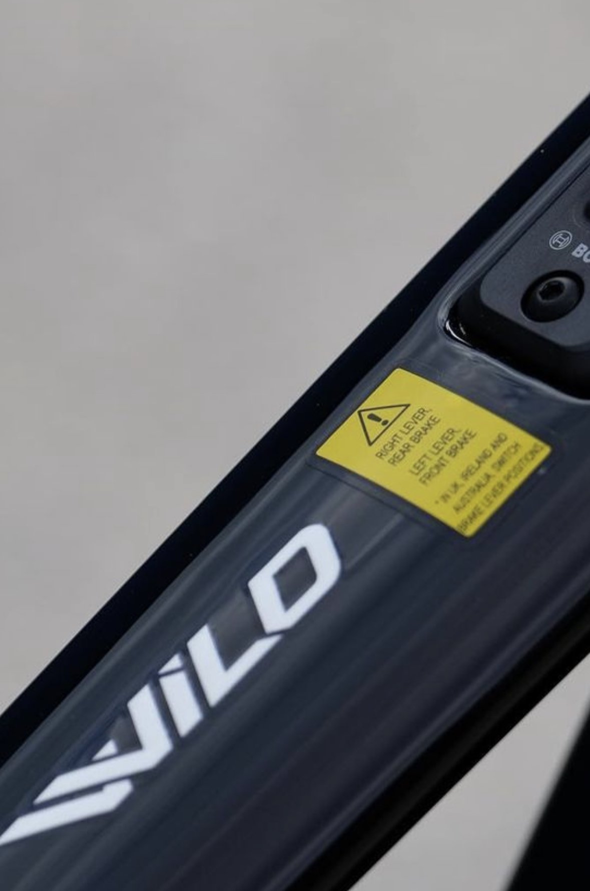

You can also see on the wild logo some outlines and the logo is not placed in the middle. on the website the logo is with those outline also on other models.

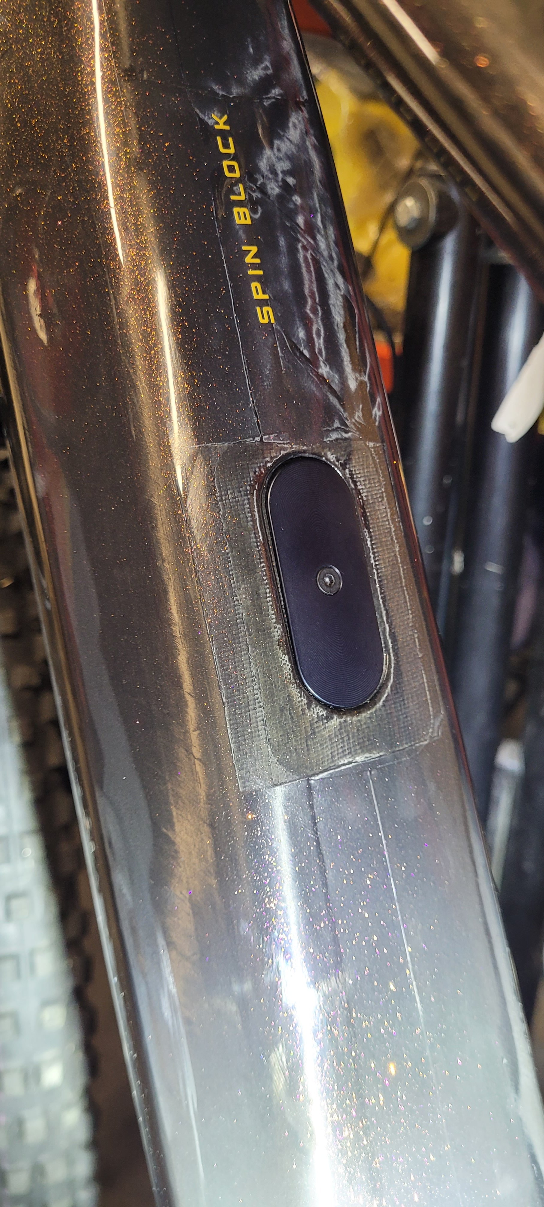

Got my Cosmic carbon a few days ago, whilst messing with the dropper and shining a torch down the seat tube it caught the light and I spotted this. I mean you can't normally see it and the clear coat over the top is smooth, but it's like they forgot to put the mystery port in and then cut it out with a blunt Stanley knife afterwards. Blindfolded. It doesn't exactly scream of quality, does it?
Anyone else's like this?
Absolute horrible. One bike more of missing QC
Just had a look it the sunlight and whilst not as bad as with a torch it's still visible and pretty shoddy. Also spotted the surround to the System controller isn't much better! The shop have said I can swap it for a silver one if it hasn't been registered with Bosch or Orbea but I have already done both. Also want over £100 to pdi another bike. Not sure how this is going to play out at the moment
