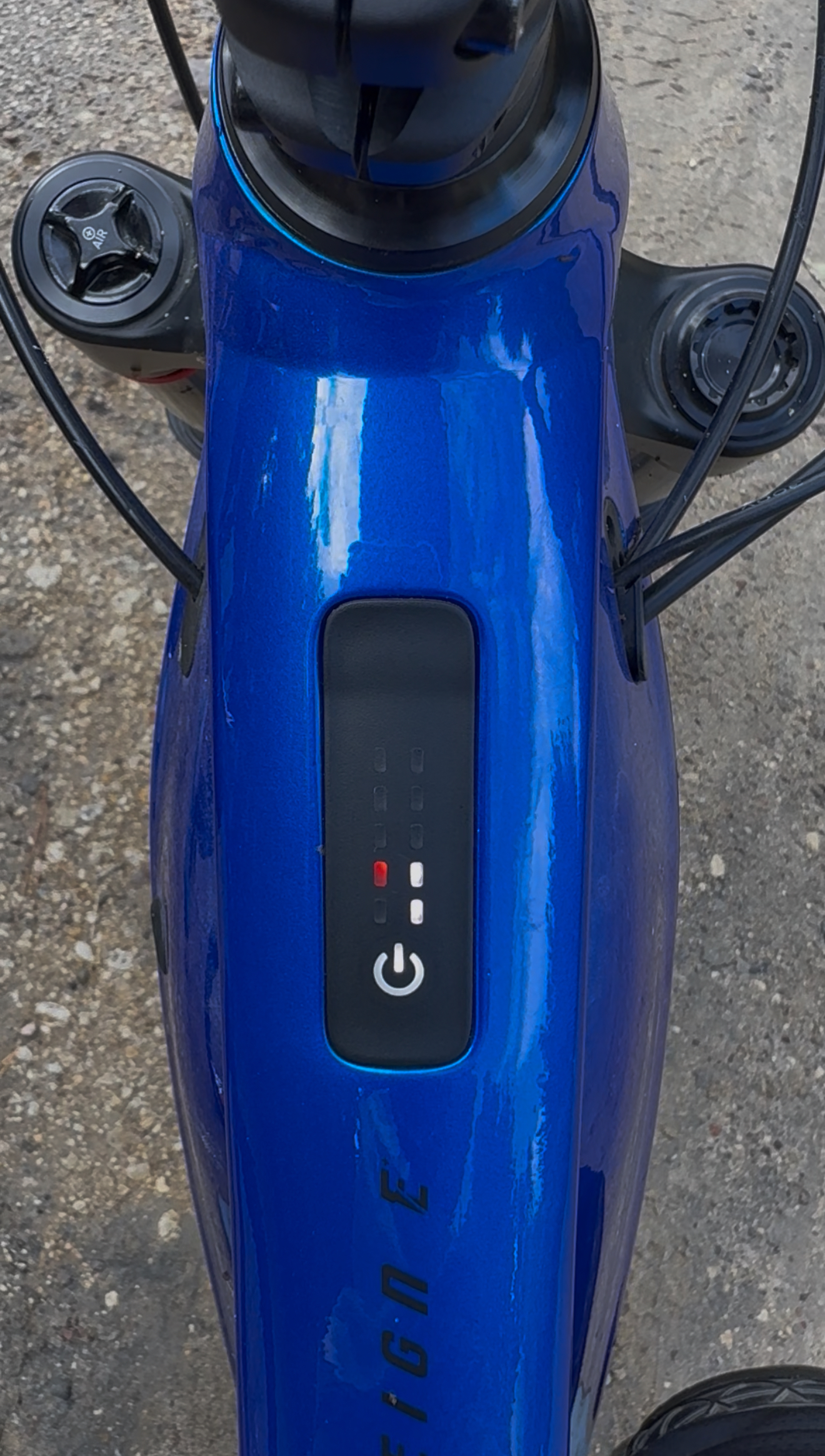

2023 Giant Reign E+ flashing L2 led
i think the problem is the giant software....like someone said before. giant thinks they coud do better then yamaha and from the start this giant software sucks. if i coud and if it is possible i woud go for yamaha software but i dont think it is possible. if someone knows how let me know
So after 4 months going back and forth with giant, they tell me the motor has no problem, determine that I ride in the smallest cog on the highest power assistance, pedal too slowly... Utter BS and it is my fault, then i am told the bikes have humidity problems and i shouldn't ride in the rain and should dry my connectors mid ride...
I then ask should you spend 6K on a bike then put bathroom sealant everywhere to protect it from water??? especially i bought an offroad bike. I had to tell them Ive been dirt biking for years even on E dirt bikes river crossing and i've never heard such rubbish
They literally have no solution and are pushing it back on the customer. Weird thing is i cycle up hill it cuts and goes red.
I stop to chat with a mate it goes red. I ride dh trails it goes red. I ride in dry weather or wet weather it goes red.
They will lend me a battery to see if my battery may be the problem...
So I'm not sure they have a solution, at least not in my store. and may have spent too much on replacing motors and are cutting costs.
PS yes I've cleaned connectors tried the die electric grease, but it doesn't change the fact that it cuts out even in dry weather.

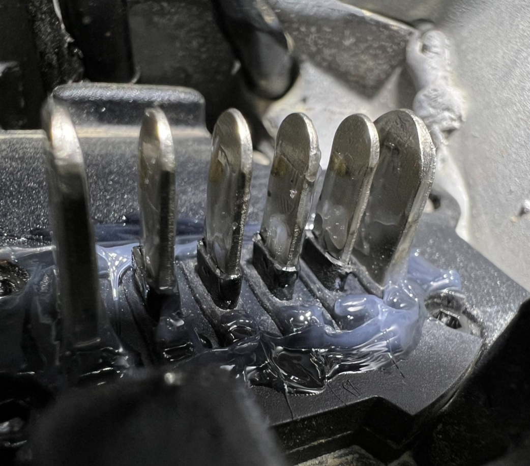

Hello, I'm experiencing the same issue. It happened to me 15 times during my last ride this weekend (with the latest update, the one that requires creating an account, etc.).
I contacted my dealer who is very nice and involved. He advised me to use dielectric silicone grease (Velox brand) and has submitted my issue to Giant.
Of course, I will come back and share anything that might help resolve the issue.
Did the dealer specify where to apply the grease? Searched for Velox grease and it seems to be not be available here in the U.S. . I wonder what the differences are from other dielectric grease?
@parkp81 Yes, you need to apply the grease on the battery and bike contacts (a thin layer is enough). I will do it this weekend and post a photo of the grease application.
Regarding the brand, he told me he uses this one (Velox) and it works well for him, but I imagine any dielectric grease (for electrical contacts) will do the job.

I have used a thin layer of Super Lube dielectric grease on the plugs to the motor and battery contacts. I have cleaned the battery contact points with electrical cleaner and have not had issues since. Hopefully it helps you, like it did for me.
Hello,
Just like parkp81, I cleaned the battery and bike contacts with a contact cleaner spray and applied dielectric grease (see photo). I also tightened the battery mount completely to ensure there was no play.
I turned the bike ON and without even moving, it went into error mode 20 seconds after powering on. To be sure, I slightly loosened the battery mount since my colleague’s (who has no issues, Reign 2022) was less tight and did not have this problem at all.
We went for a ride, and the problem occurred more than ten times, then after 10 km, it calmed down.
We took a break for 5-10 minutes, the bike turned off automatically. I restarted it, went up a technical climb, and it crashed in the climb (~2 minutes after I restated), but not at all for the remaining 15 km. I feel like it only crashes when it’s cold.
My dealer and I are wondering if it’s the battery. I will swap it with my colleague’s (if it fits) to see what happens and get back to you.
I forgot to mention that I also cleaned the battery contacts with the electrical cleaner and let it dry completely before installing it back onto the bike. For dielectric grease I used a very light coat using a qtip to apply it to the battery pins you show in your pic.

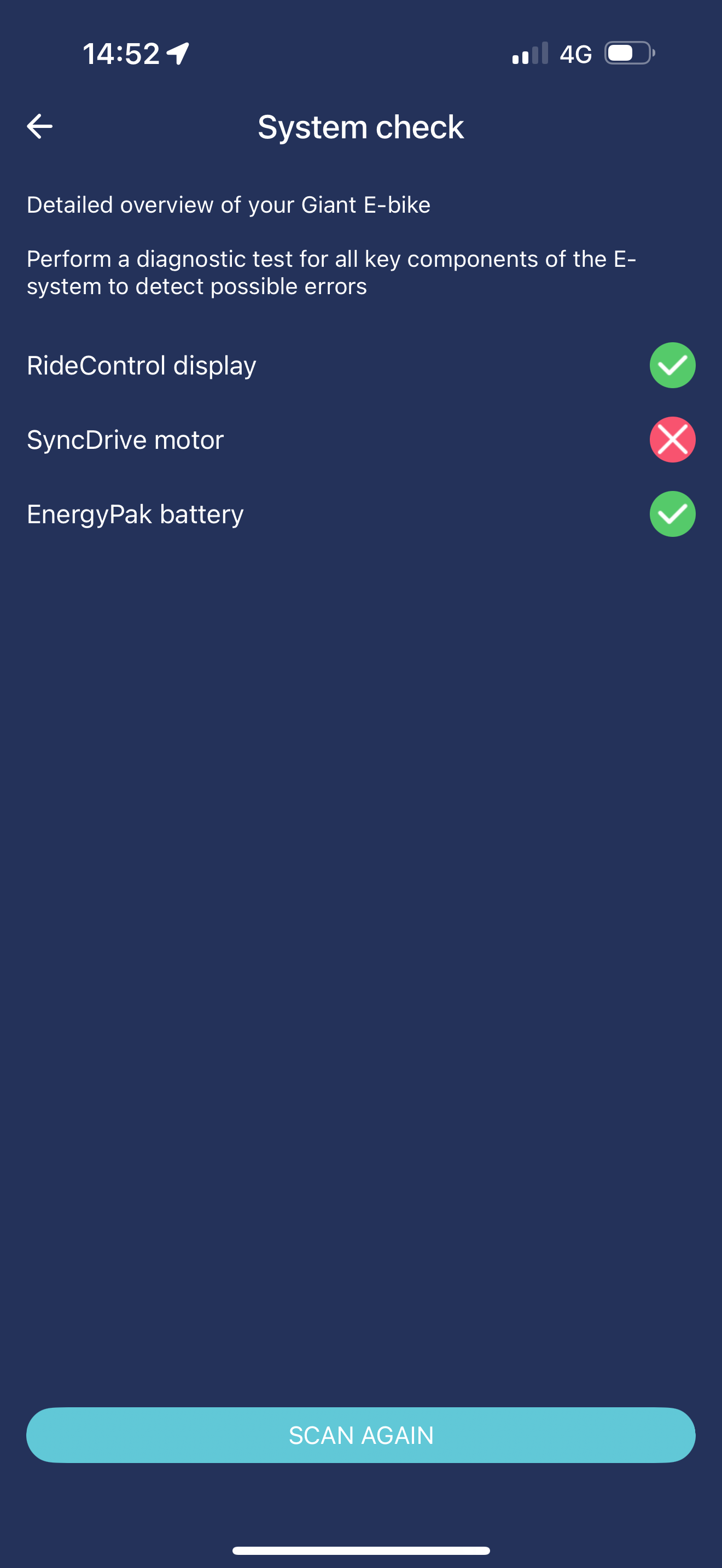

Nobody is sure where this problem comes from or how to fix it (except that their app says it’s the SyncDrive motor).

My bike is now having this problem after 1500 kms. Giant dealer ran the advanced diagnostics and its coming up with a torque sensor error. Apparently that can't be fixed and it needs a new motor.
