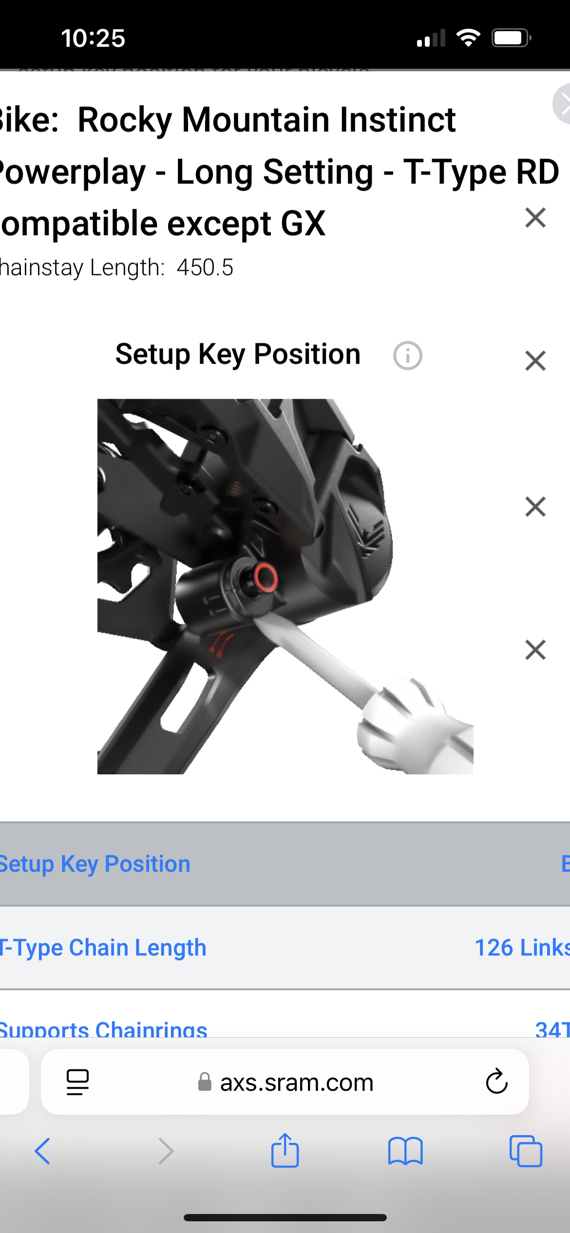

One thing I have not figured out yet is chain length. The sram calculator does not have any powerplay models. Anyone who has done it, what chain length did you use?

The SRAM calculator says 126 links with a 34t chainring, I checked for both medium and Large sizes and it’s the same.
I installed mine at 126 links, Large frame.
One concern is my torque sensor cog has chipped teeth. Not sure if it is related to the t-type chain or not. 500 miles on the bike.
