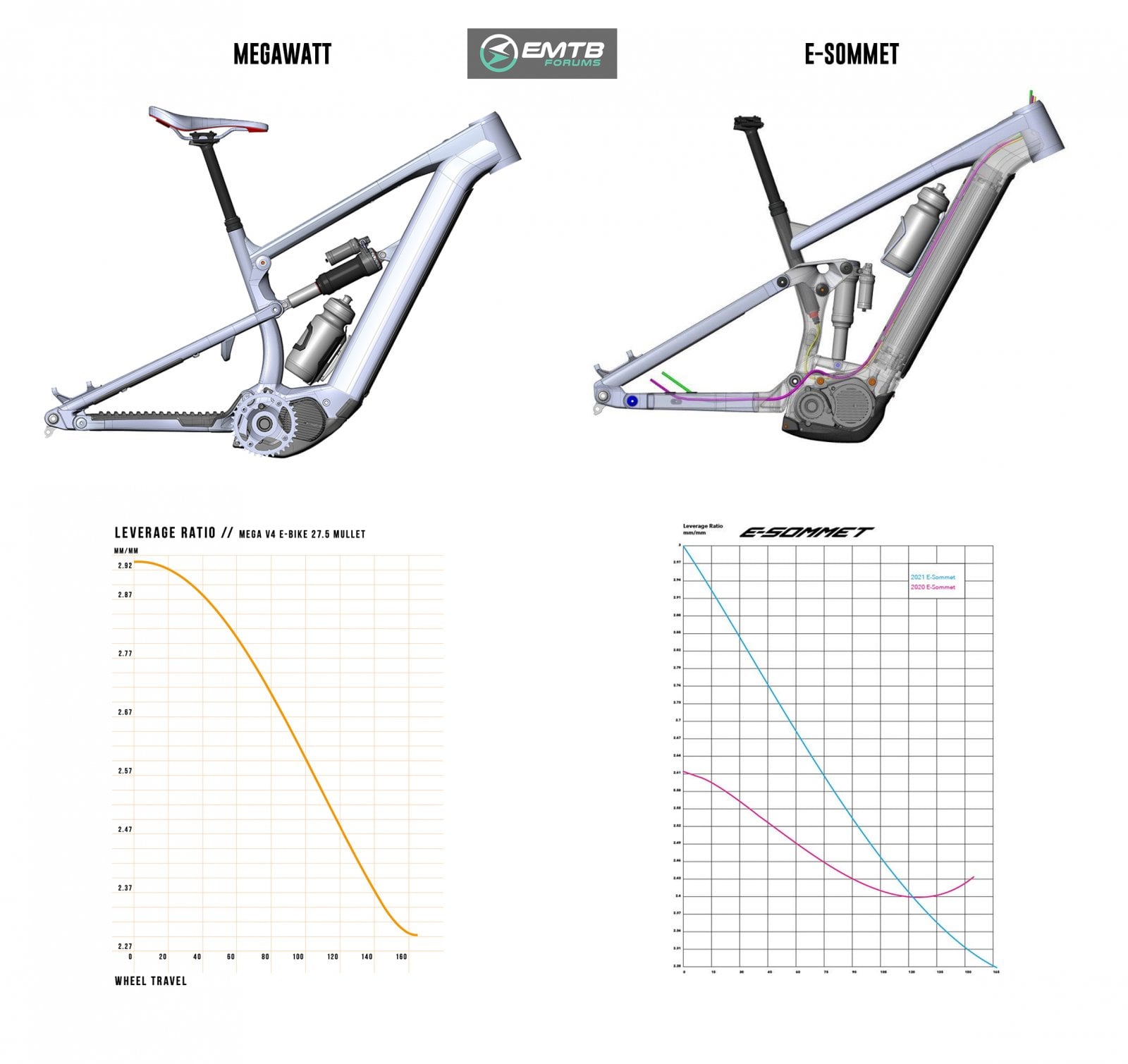

Megawatt vs E-Sommet frames. Looks like it shares a lot of the front triangle (obvs as same company) but motor area is different, seat tube and rear linkage and rear triangle different, shock rocker etc.
All leads to a different leverage curve, and you can see why the Megawatt is so supple off the top first 40mm travel is quite different, the E-Sommet is way more progressive right off the top so likely not feeling as sensitive (I've not actually ridden it, just looking at the curves).
Seeing as each graph is not to scale; If you look at the numbers on the graphs instead of the shape of the curves you can see the overall leverage progression of the two bikes isn't actually all that different (2.95ish - 2.3 versus 3.0 - 2.3).
Yes the start of the Mega's curve is shallower but consider that the first 50mm of travel is beneath the bike's sag point. and in actual fact that flattter portion of the Mega's beginning curve is offering more support below sag point rather than a softer initial rate.
At and just above sag point (where small bump compliance actually happens) the two are really quite similar.
The old Esommet (pink curve) is still a predominantly progressive curve but a lot flatter so as to work better with the natural progression of an air shock and has a falling rate at the end where an air shock naturally ramps up tons more.

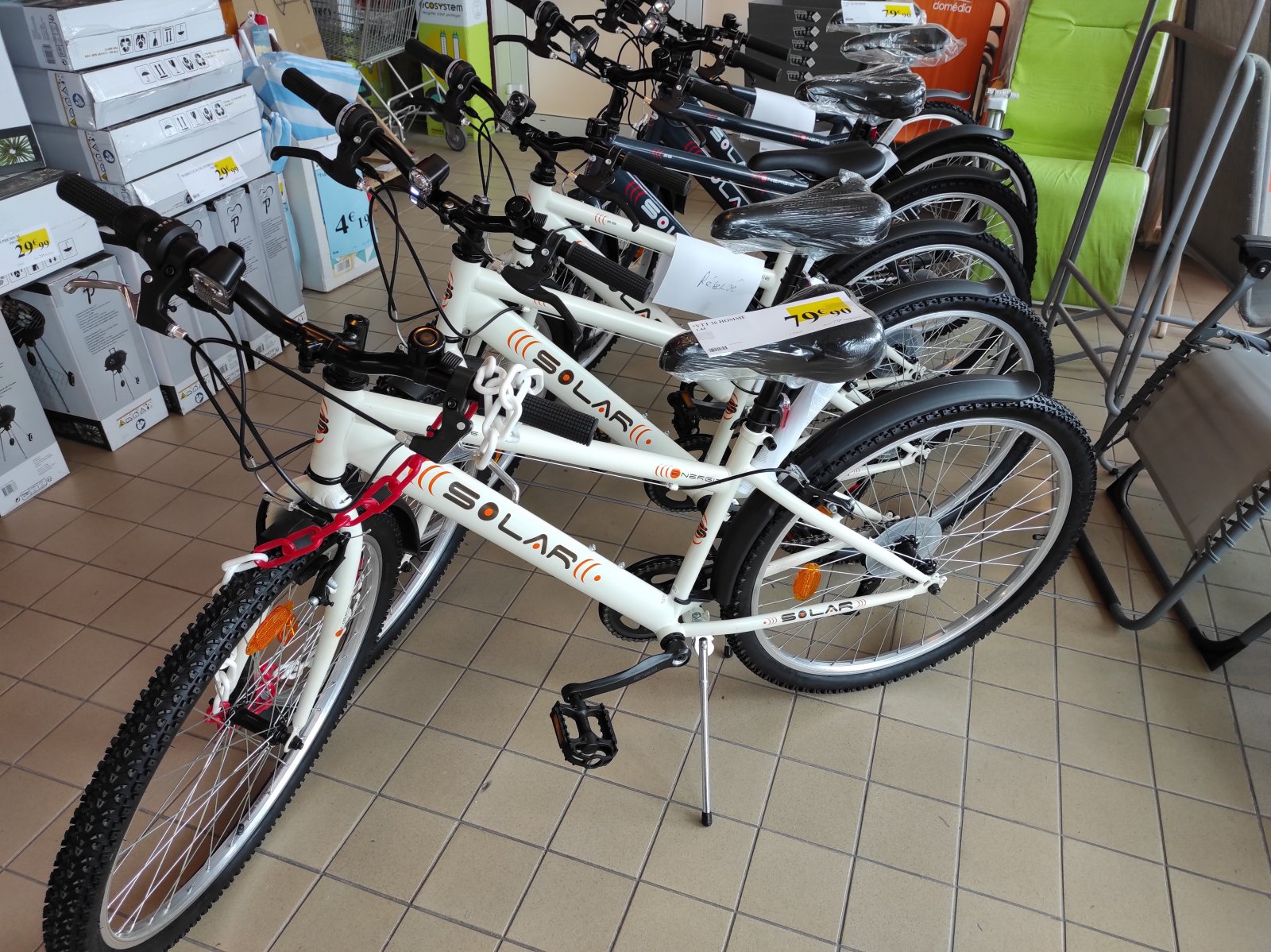

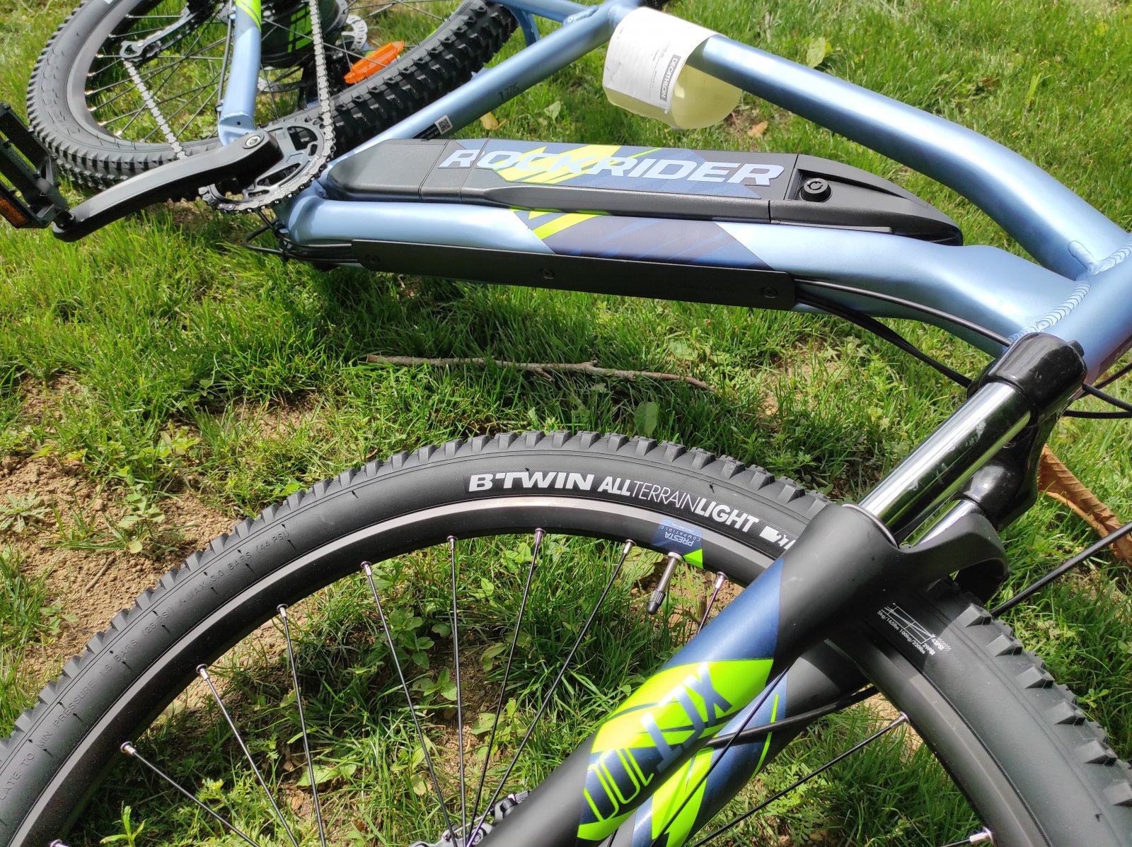

Found this for you. €79 for a saddle with a free bike with bell, lights, reflectors,wheels,cables,chain,gears, gear selector, mudguards (they're quite good quality - better than the €40 MTB ones), tyres, pedals,cranks, handlebars, grips, stand - and easy accessible cables !
Decathlon's hub motored bikes have a simple but easy cable tidy :

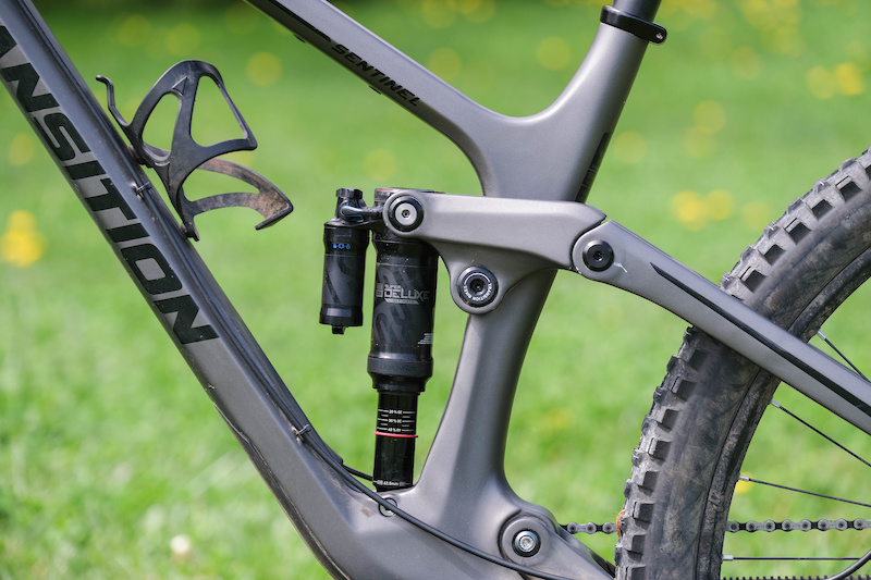

I’d be a little concerned about the cables along the bottom of the down tube getting damaged or snagged on things.

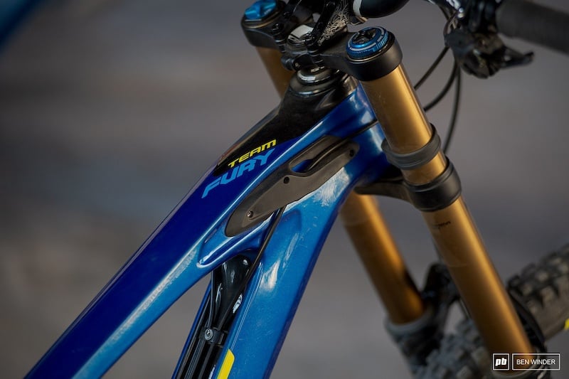

something more like the way GT does it would work though.
But I still think simply allowing the rear brake line to be able to be run externally similarly like what Transition does would be great.
How/where the hell do you ride if you're snagging the underneath of a bikes downtube on things?
you act like it’s unimaginable but yet Transition and GT aren’t running the cables on the bottom of the down tubes. I live and ride in Vancouver Canada, so lots of North Shore style trails. Steep, rocky & rooty trails. I’m not saying it would be something that would happen all the time but it’s something that’s totally possible of happening,
I wouldn't worry. Mid motor Emtbs pretty much always run cables over the top of the motor rather than below it and hub motor Ebikes aren't really suitable for proper mtb riding at all
Transition, GT and Specialized have all run cables under the BB on their normal mtbs.
routing wise it's rarely the best solution but bearing in mind the cables beneath the BB are still tucked up a fair bit higher than the chainring you really would need to be pretty special to snag them.

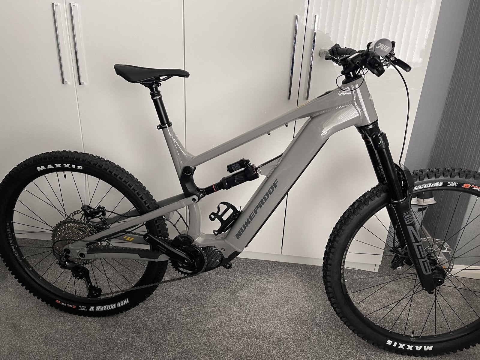

Mine is shipped and on its way. I do love Nuke for this. I ordered a Marin E2 on 1st december (release day) and I still haven’t got an accurate delivery date. I order a Megawatt Elite on Monday and its already on its way and getting here following Monday....

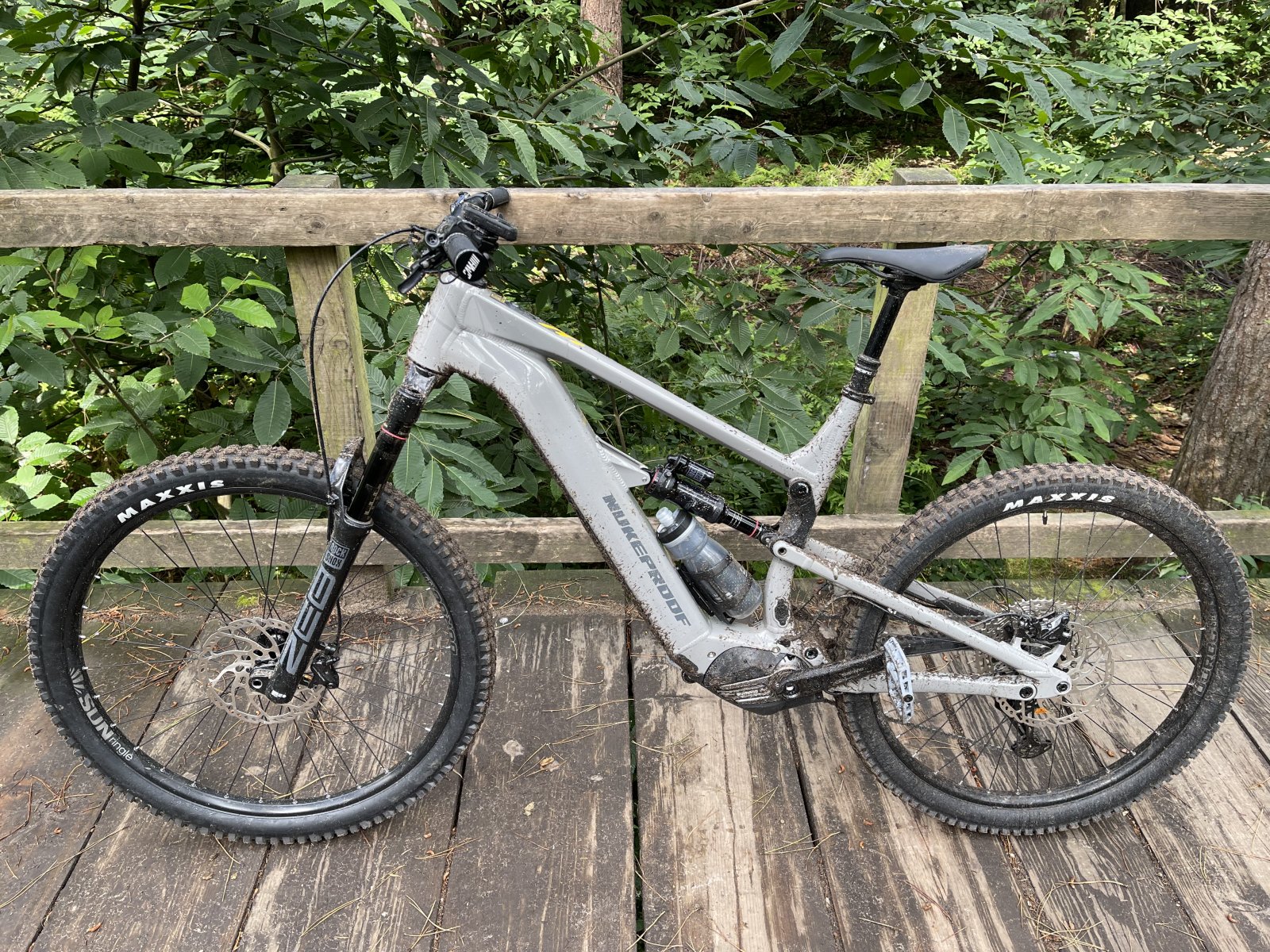

Went out for my first ride today and omg what a bike. I left the suspension how it came out the box and the sag seemed correct, I’m just about to have a coffee and read the suspension thread which was posted above. Hope I’m ok uploading a couple of photos :-).

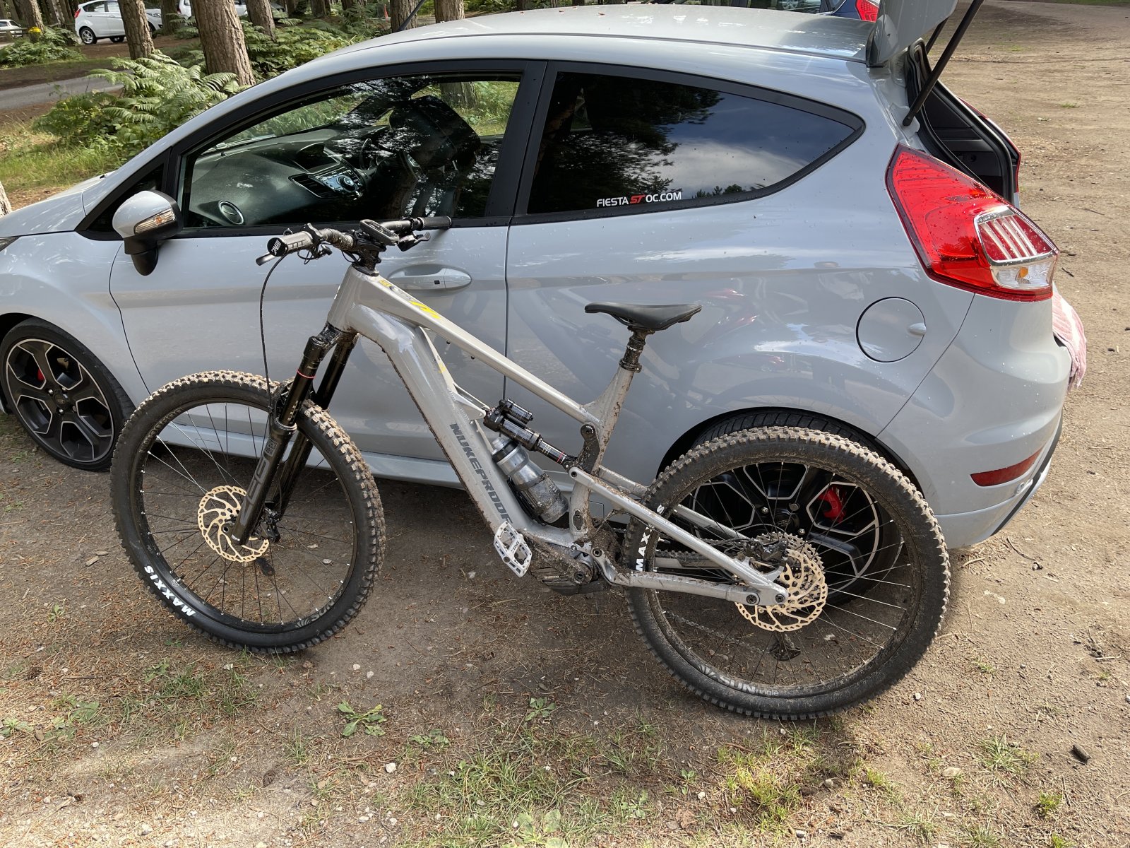

Went out for my first ride today and omg what a bike. I left the suspension how it came out the box and the sag seemed correct, I’m just about to have a coffee and read the suspension thread which was posted above. Hope I’m ok uploading a couple of photos :).
Who would ever have thought a Ford Fiesta could look cool ..

Did it come with Zebs ?
It’s just a standard comp which does indeed come with the bike. The reason I went comp instead of the Elite is because I wanna grow my riding with the bike so further down the line I’ll just upgrade the parts. The bike is perfect for me, I have no complaints at all.
