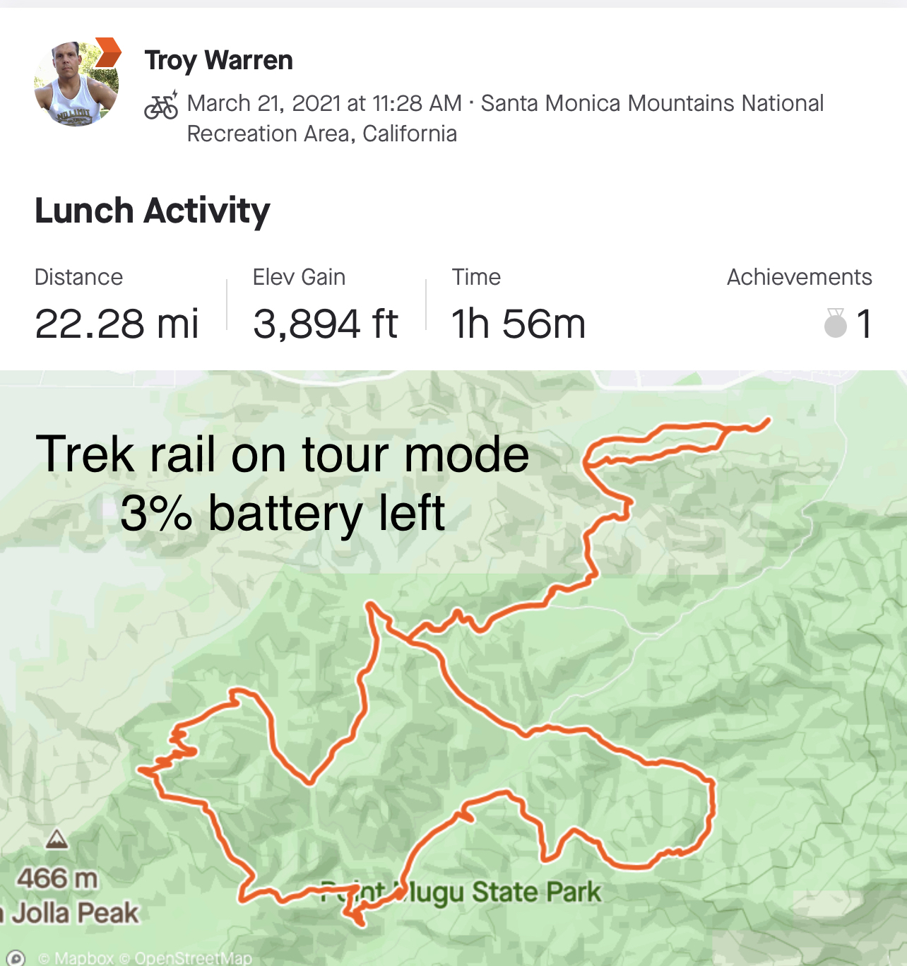

This is the most I can get with a full battery on my Trek rail when riding in tour mode. I wish I had more battery life for, longer rides, occasionally shifting in boost for strava segments, and not having to worry about running the bike dead.
I could ride in eco mode but I don’t really enjoy riding a 49lb bike in eco mode.

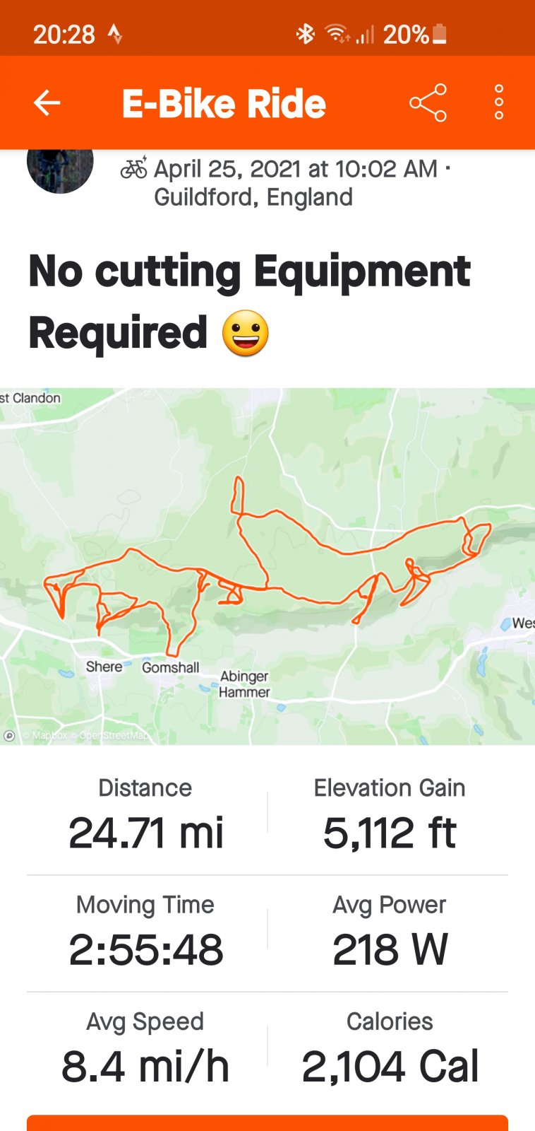

but i cant help but think my rides must be short and dull
Certainly sounds like it. :p
I've flattened my 625Wh battery in under 15 miles several times, usually with 1300-1500m of climbing, all in EMTB but pressing on, so using Turbo levels of power for most of the climbs.
Agreed. I didn't spend £5K on a bike to ride it slowly. :ROFLMAO:
