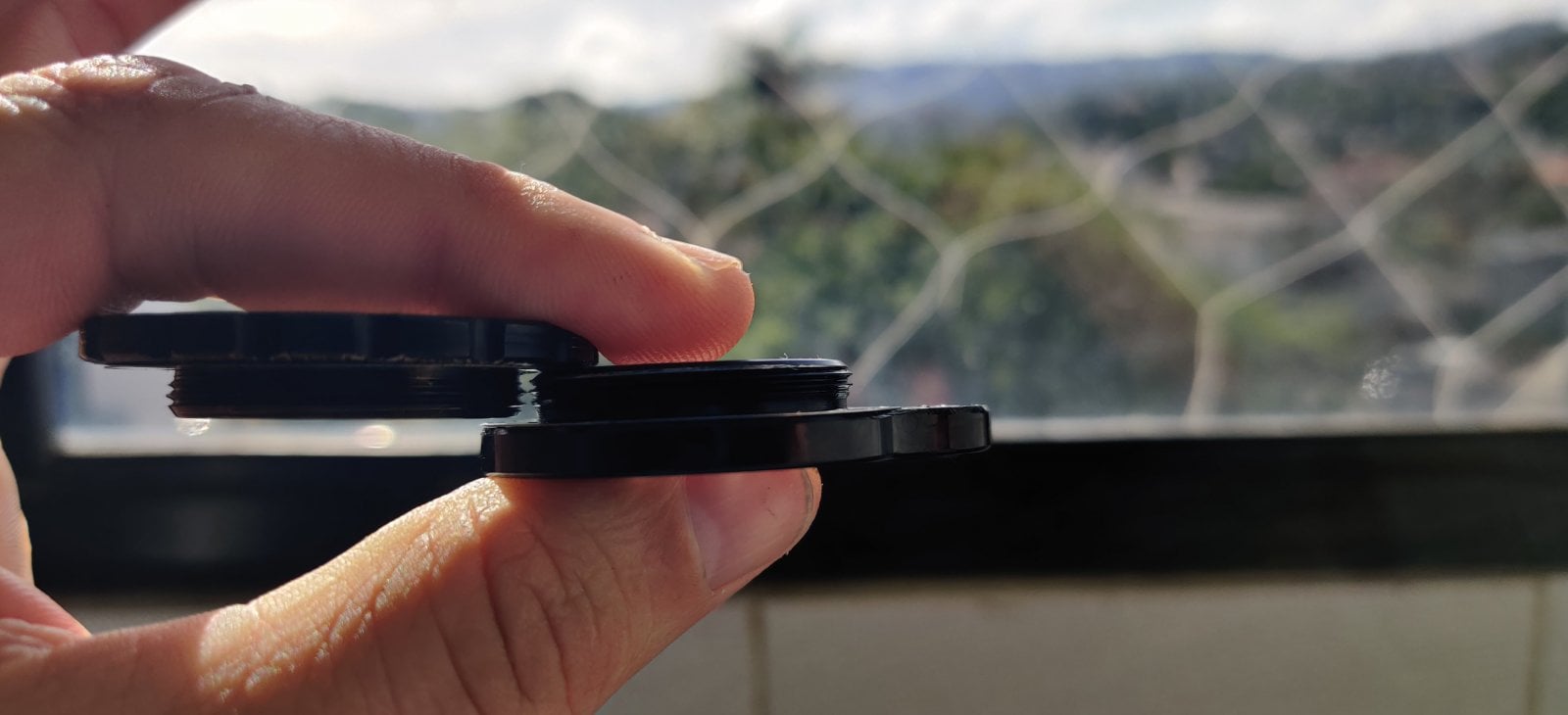

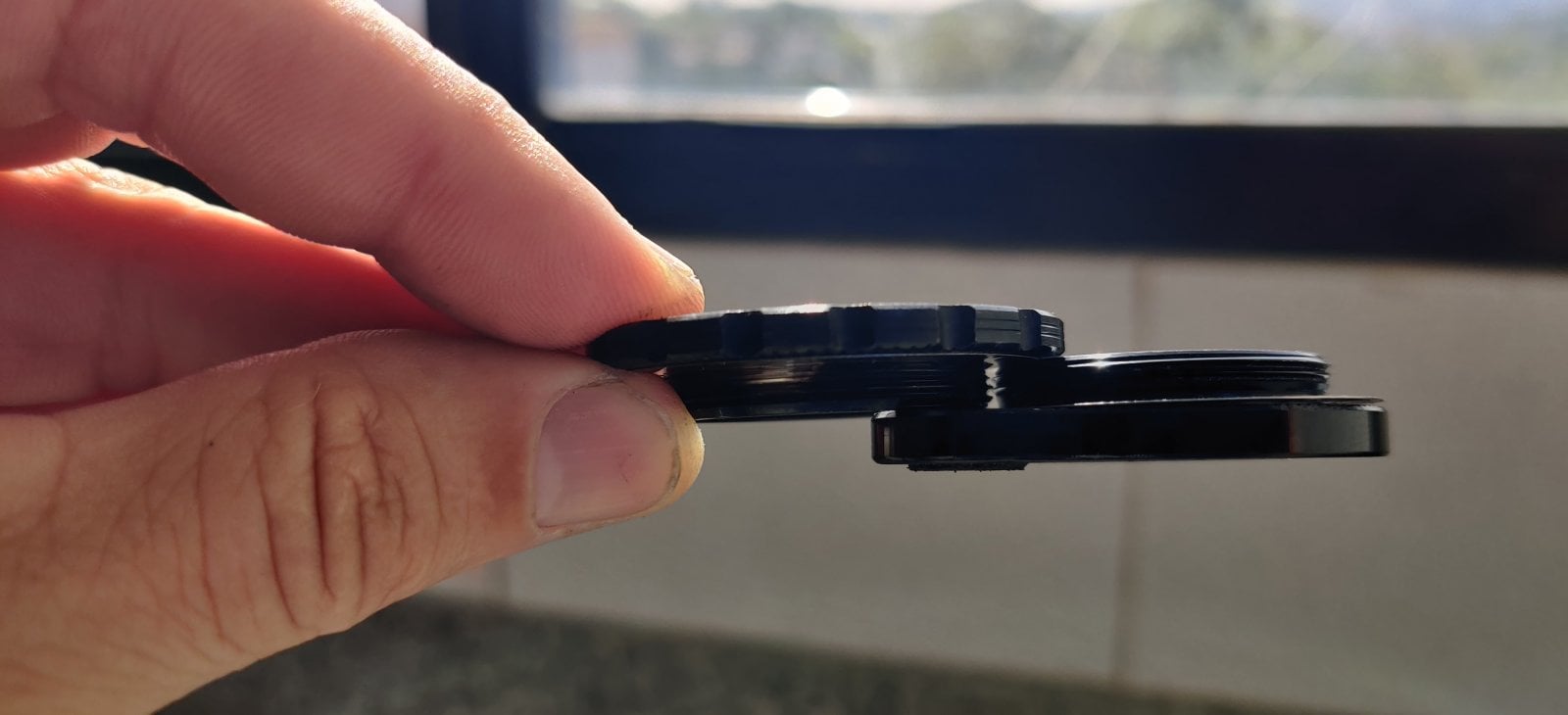

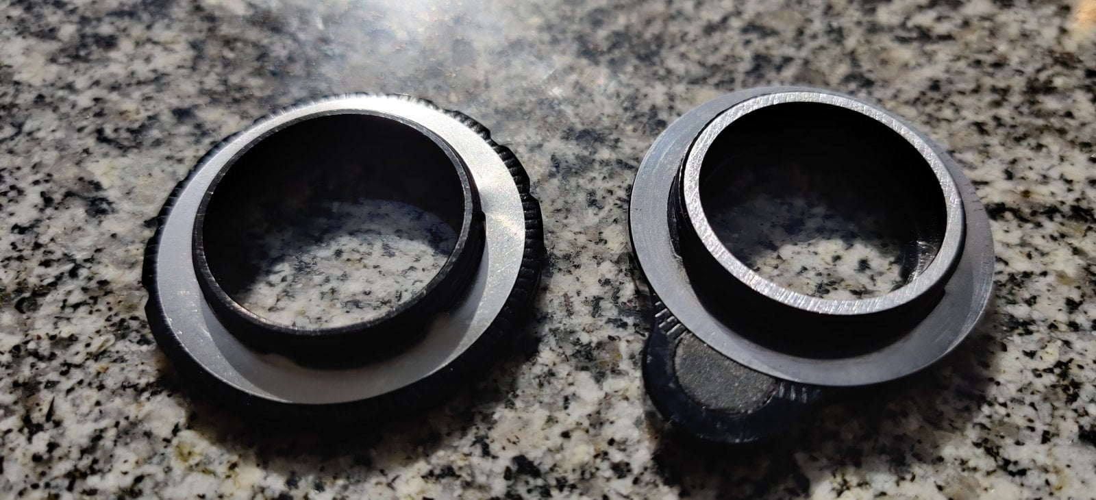

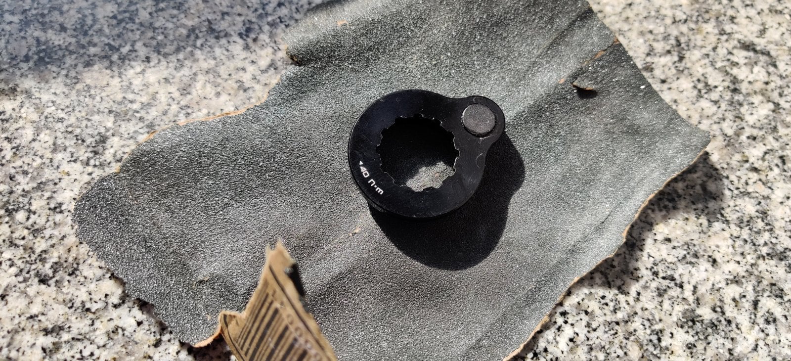

Day 3 of my new COMP. Started getting loud noise and vibration from the rear brakes. Others have had this problem as well. I think I figured it out, its not the SLX brakes the problem.
The disk was a little loose and It wasn't noticeable to the naked eye. The centerlock nut with the magnet on the rear wheel from Specialized is wider than the stock Shimano nut. I just sanded it down a bit with some sandpaper against a flat surface and now it tightens the brake disk properly. No more noise or vibration

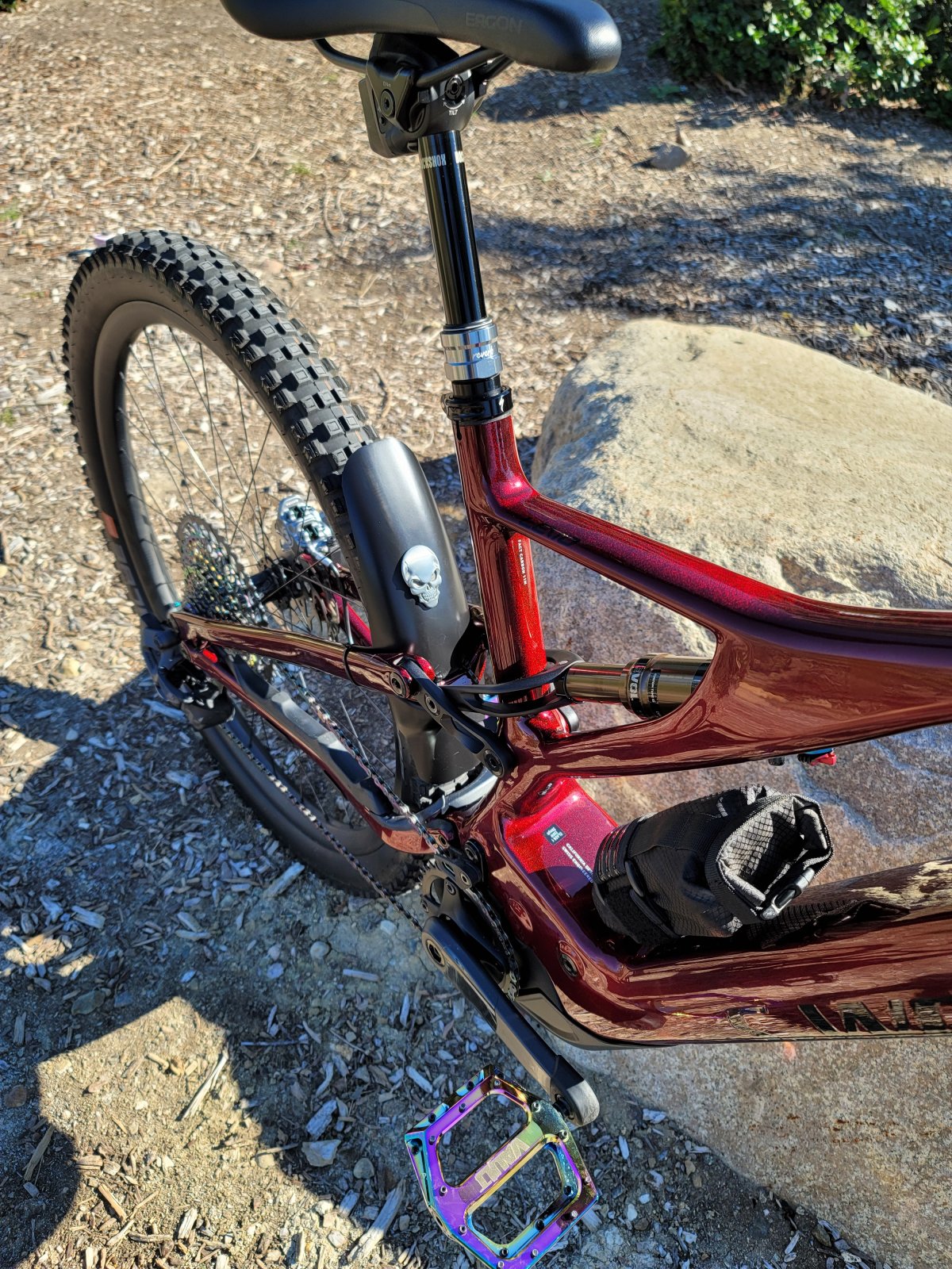

Has anybody installed mudguards on their 2021 levo?
I'm looking to do front and rear but need pointers on which one's actually with
I have this on my rear, custom designed for Levo's and Fox sells an OEM for front.

Make sure the rear disk is tight. Mine wasnt and with the Specialized centerlock magnet nut bottoming out on the shimano hubs it would never be tight unless you sand it down. See my pictutes above
