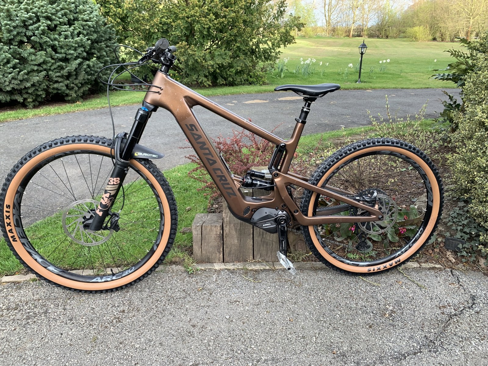

New tyres, think it looks sick ?? Let you know how it effects the range after a ride out tomorrow.

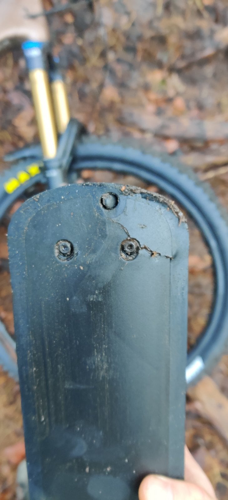

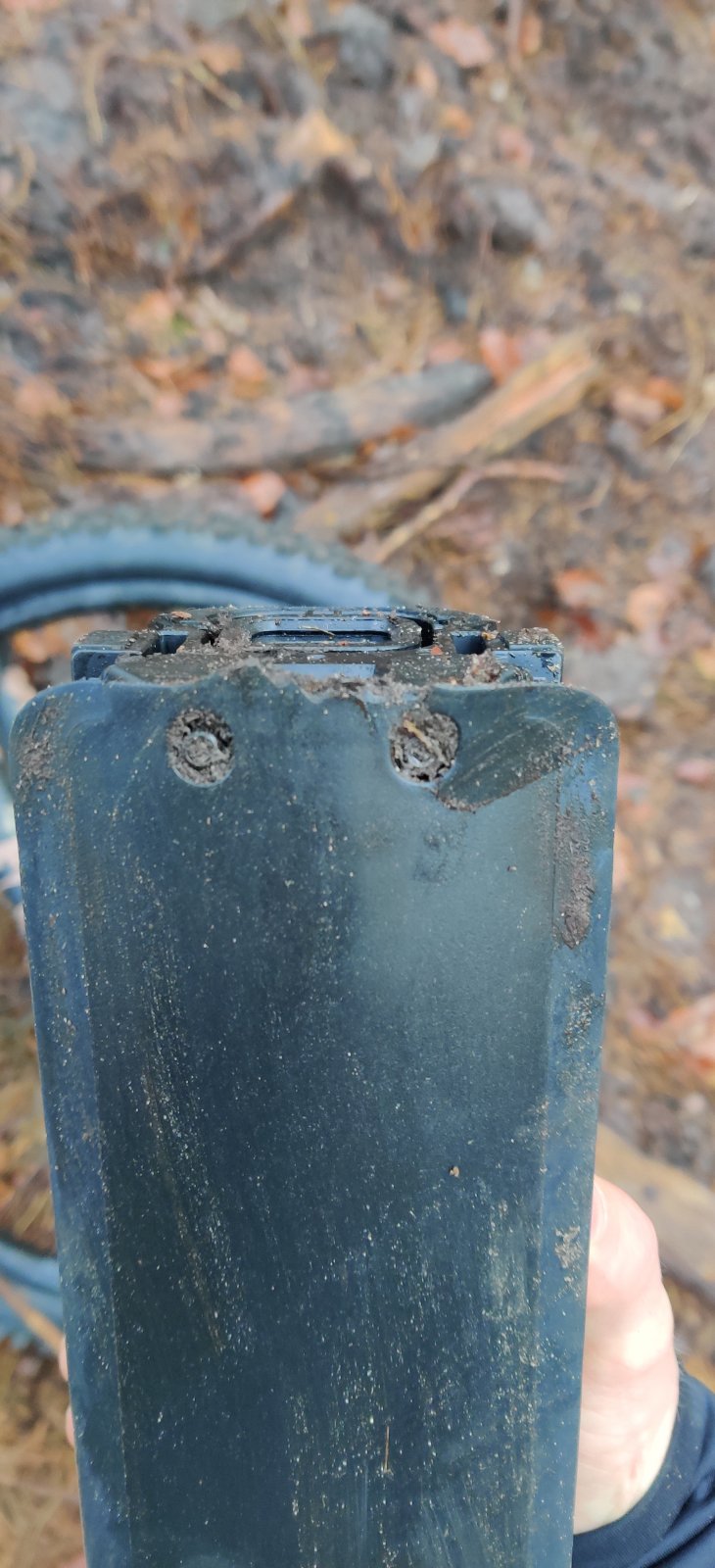

Had another great ride today on the Bullit, with a not so great experience.
Did a rather small jump, but overshooted it abit which resulted in a semi hard front wheel landing, nothing the fox 38s didn't turn into butter, but it resulted in the freaking battery dropping out of the frame with full force.
Huge disaster, so trailside cleaned it. Popped back in and everything worked.
Did another 15km afterwards "mindful of harsh landings".
Seems like only the battery cover really took any damage.
Going to get in touch with SC Monday.
Hopefully that's a one off, but probably going to do a hotfix(safetyband) solution untill someone has had a look at it.

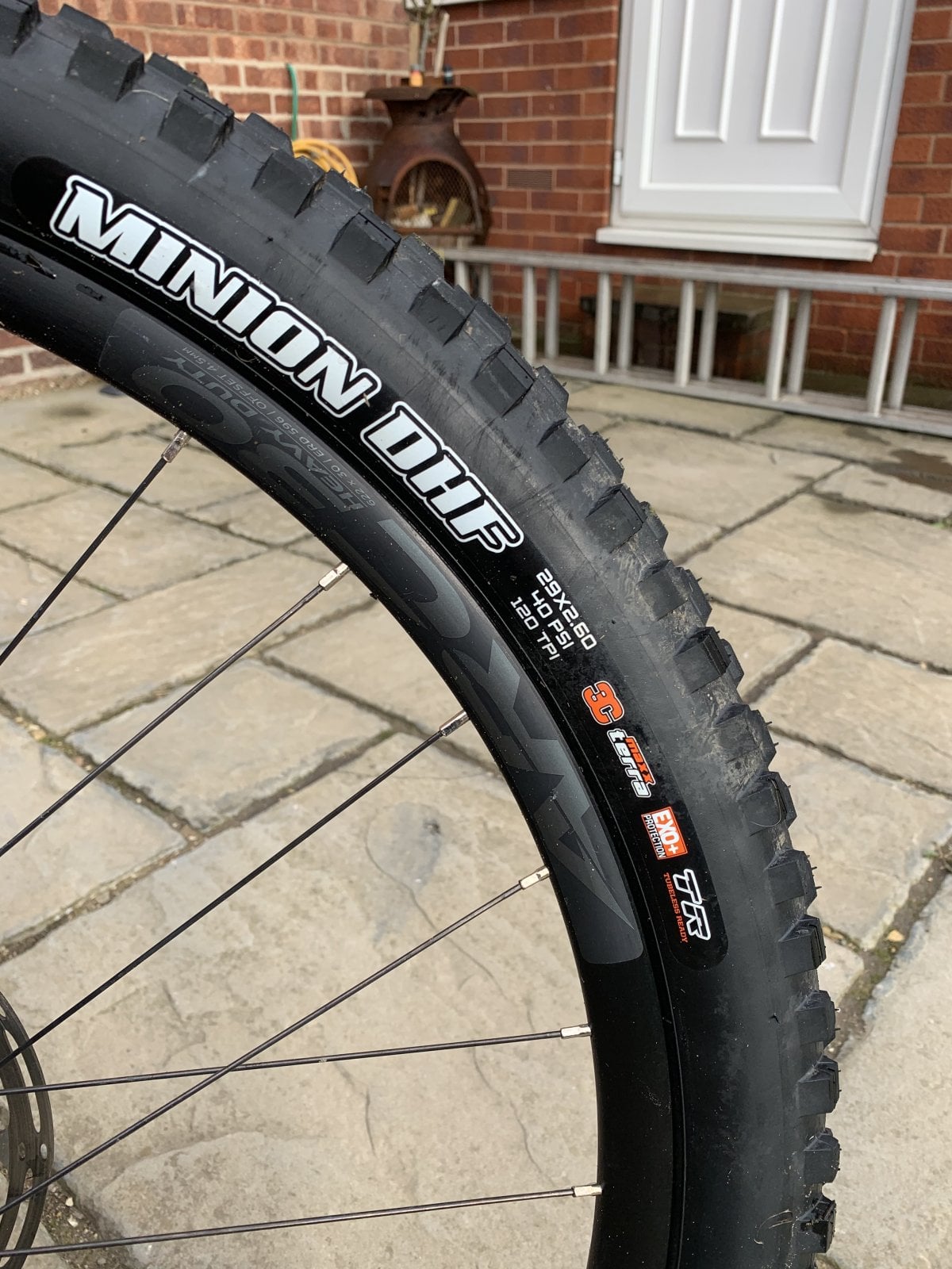

Swapped out the Assegai for the Minion Dhf Exo+ & i can confirm the bike rolls much better. Did a similar ride in the peaks again yesterday and got back to the car with 2 bars of battery instead of running out with 2miles to go.
Im not saying its all down to the tyre but there was a noticable difference, and I didn’t feel i lost any grip on the steep rocky rooty stuff.
