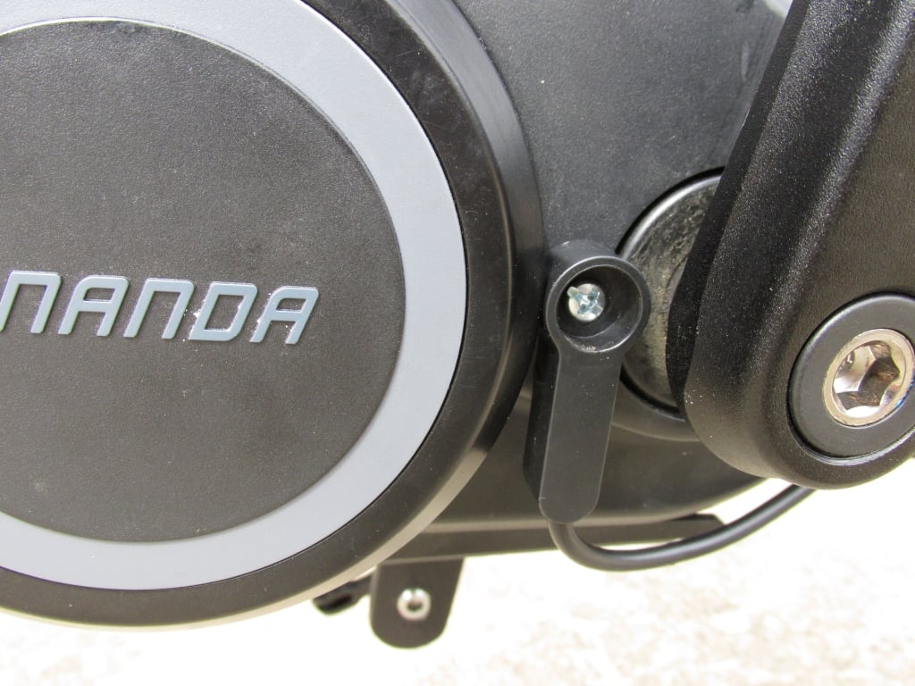

I voided my warranty the day I opened the box so might as well share my unlocking modification to remove the nonsense 25kph Australian limit and bring the bike up to the New Zealand 32kph limit.
Relocate the speed sensor from the rear wheel to the side of the motor. This confuses the motor firmware to think you are moving slower and the speed limit cut out threshold is not reached, letting the motor spin higher giving you more speed.

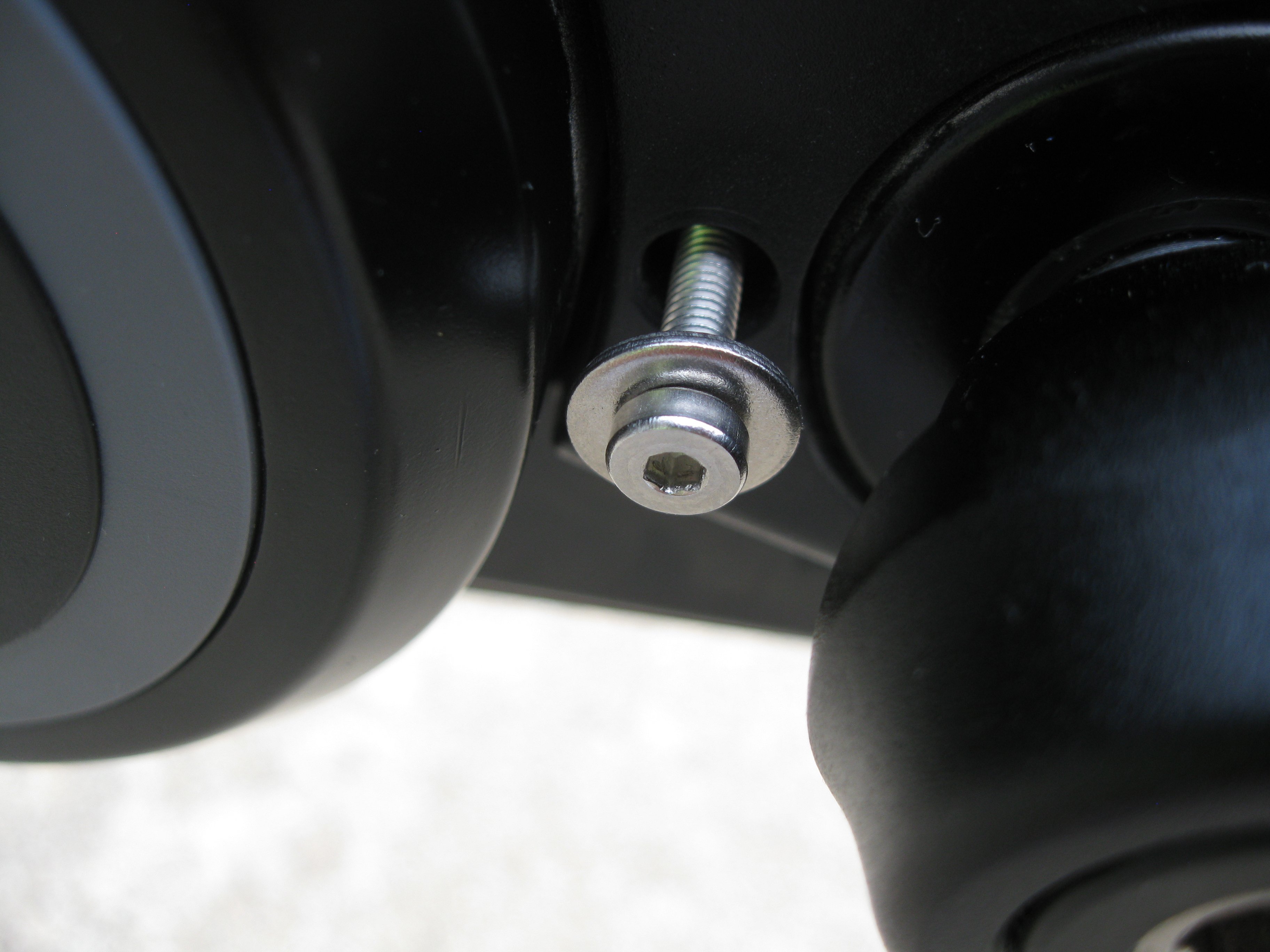

The Ananda M100 has a very convenient screw point on the left hand plastic motor cover. Remove the short M4 hex head bolt and attach the sensor using a longer 15-20mm bolt and washer. The cable run back to the motor 'port hole' is same run length.

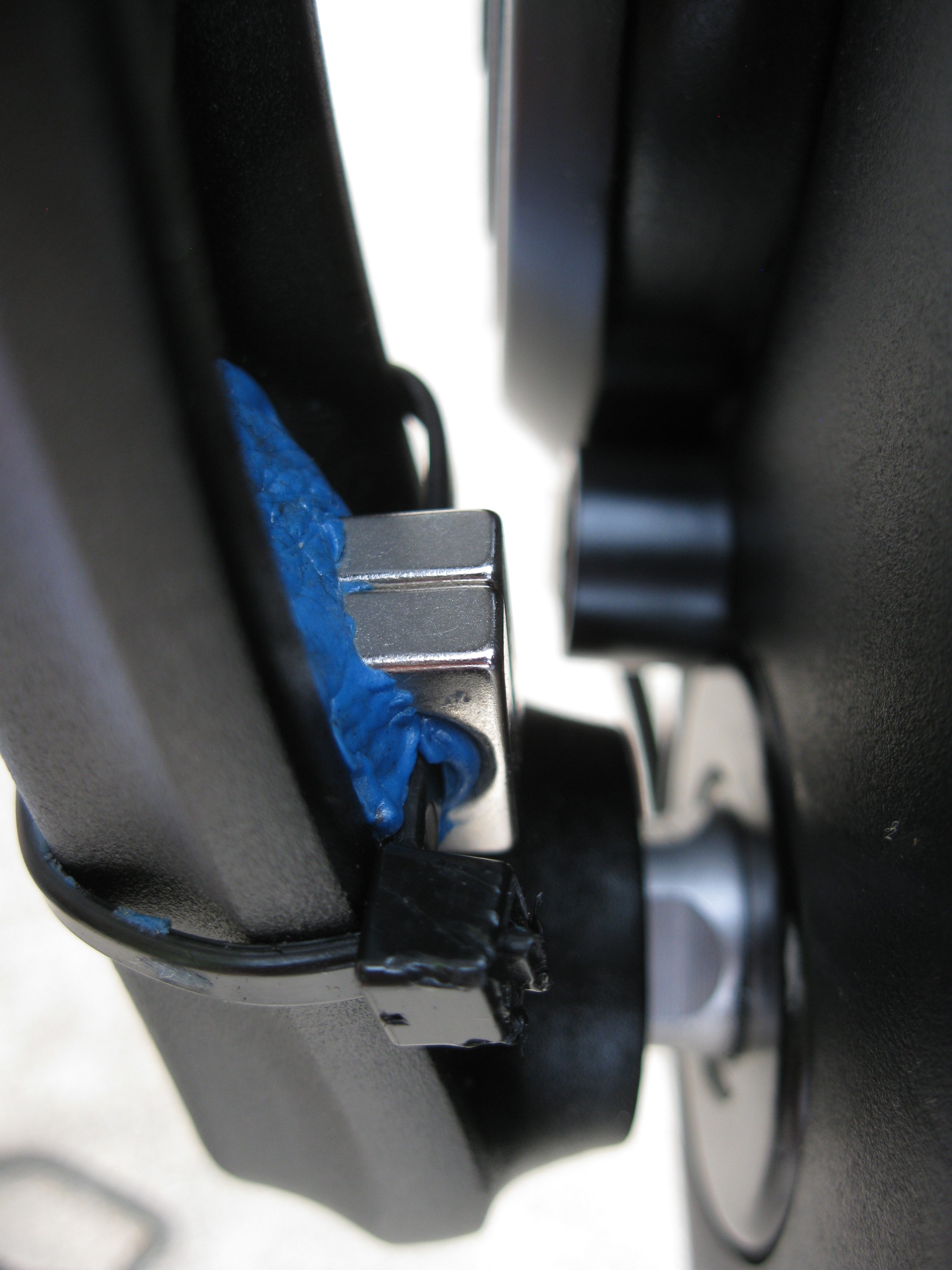

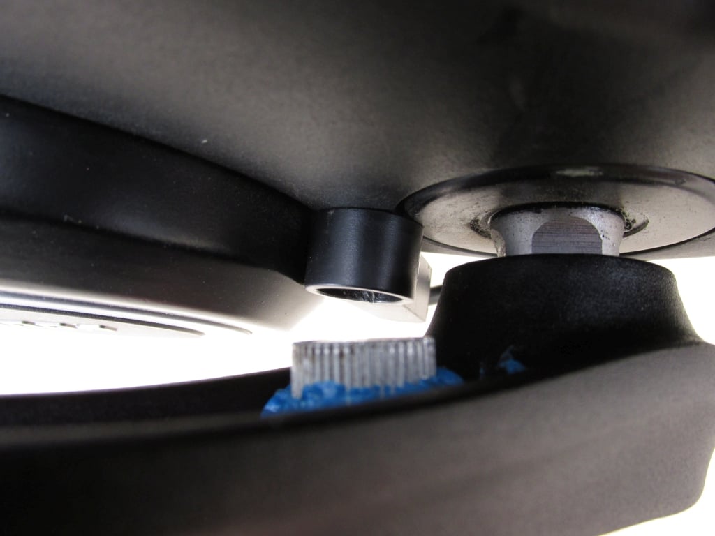

Remove magnet from back wheel and attach to inside of left crank arm with some Blue-Tac, glue or silicone. Get the distance between magnet and sensor similar to original position. You can also add a black cable tie for extra security or use any suitable magnet that will be strong enough to activate the Hall effect poles in the sensor.
The upside is a potential speed limit approaching 60kph if you can pedal hard enough. Even in the lowest 50% 1/5 setting I easily achieve 32kph with little effort. (The M100 is stupidly powerful).
Downside is losing accurate speed and distant measurements on the LCD display which generally equates to a third of actual measurements. But the loss of these features are quickly overcome with a bicycle that becomes a far more practical transport option.
