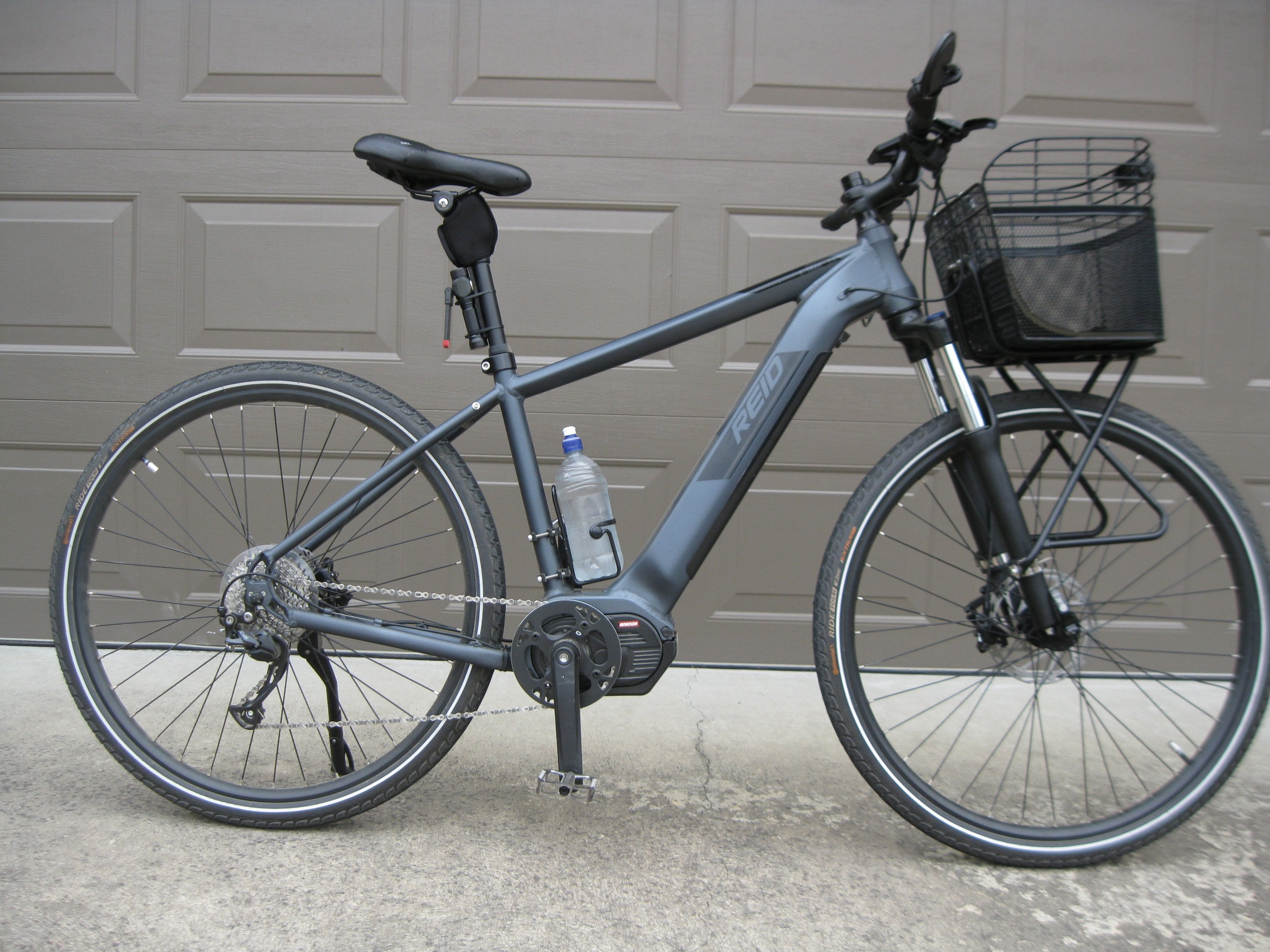

Review: Big Motor - Small Battery.
Out of the (well packed) box the E-Trail 2.0 is reasonable value for money for AUD2500 and near identical to Shogun EBX5. Ananda M100 motor is over powered and chews the small 374w battery fast. Range around 40-50km off road, 70km on flat road in low 1/5, 50% assistance mode. Disappointing. Ananda D10 display includes PAS ranging options for 0-5, 0-7, 0-9 but locked to 0-5. If 7 or 9 was available, motor and battery could be tuned for longer range. Motor needs lower assistance modes as it's over powered for flat level riding terrain in lowest 1/5 50% setting. (Needs 30% + 40%).
Motor noise remains low after 200km and suffers same knocking sound like many motors over bumps, and it's LOUD ! (see below). Ananda B17 battery (made by Tianjin Anshi Energy Technology Co.), is their lowest size and sceptical about 'LG' cells inside. Shogun EBX5 claim 'Samsung' cells ? Charger is rated at 2A but can only output 1.85A so a long 6-7 hour charge time ?
Frame is odd with rough weld lines, mounts for rear rack and fender but no bottle cage mounts - Hello ??? (Two holes and two 5c rivet nuts on the (30.9mm) seat tube would cost $2 at manufacture).
Components are low specification. Shimano Altus derailleur is clunky and rough. Seat, pedals and grips are reasonable while the Suntour shocks are spring loaded and hard. Nutt brakes have lots of lever play before they grab, very average. Maxxis 61mm tyres work well off road, but sidewalls are thin.
Overall, as a casual off roader the bike performs OK for average rider if you don't expect too much and treat it gently. Value proposition at time of writing (11/22) is reasonable. Build quality is average. Rear cable exit seal was twisted and near impossible to align. Broken hinge on display mount and rear left calliper piston seized. Repairs I was capable of fixing, but pitfalls of buying bikes online.
(Reid's pre and post sales support was dismal with email and phone calls going unanswered. Like talking to a brick wall and frustrating. Appears only one person in the role. God help you and I needing warranty claim...)
(Me: 43yo, 63kg, 170cm, experienced cyclist. Medium frame).
"The bike I love to hate" (did I get a lemon ?) - 300km update.

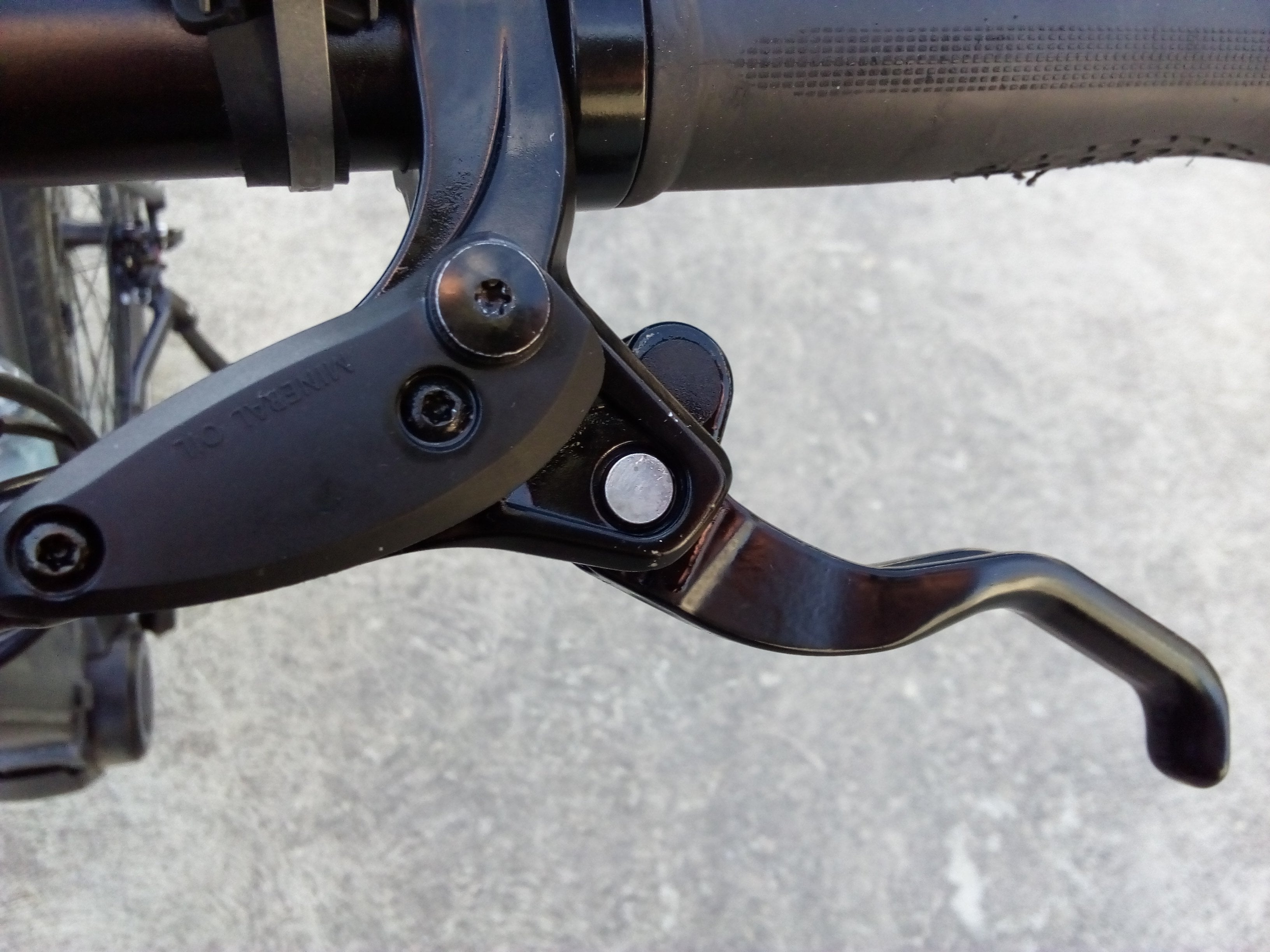

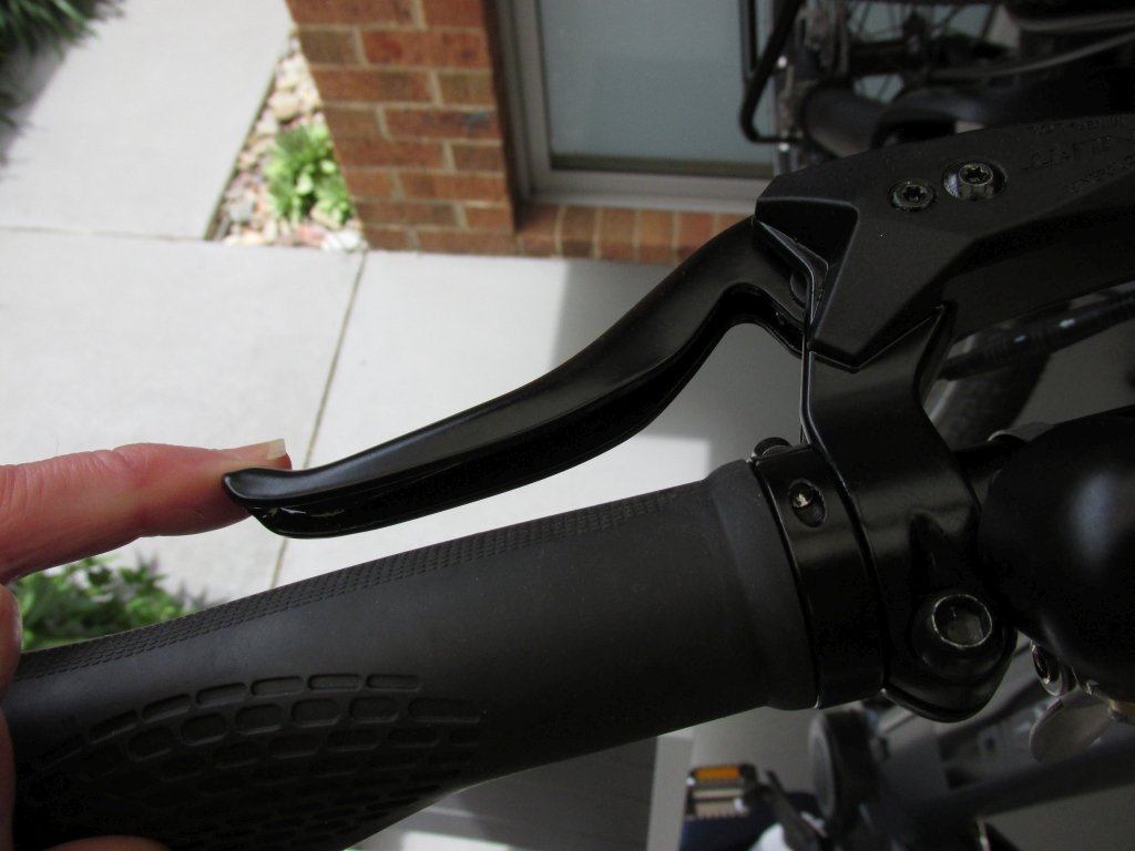

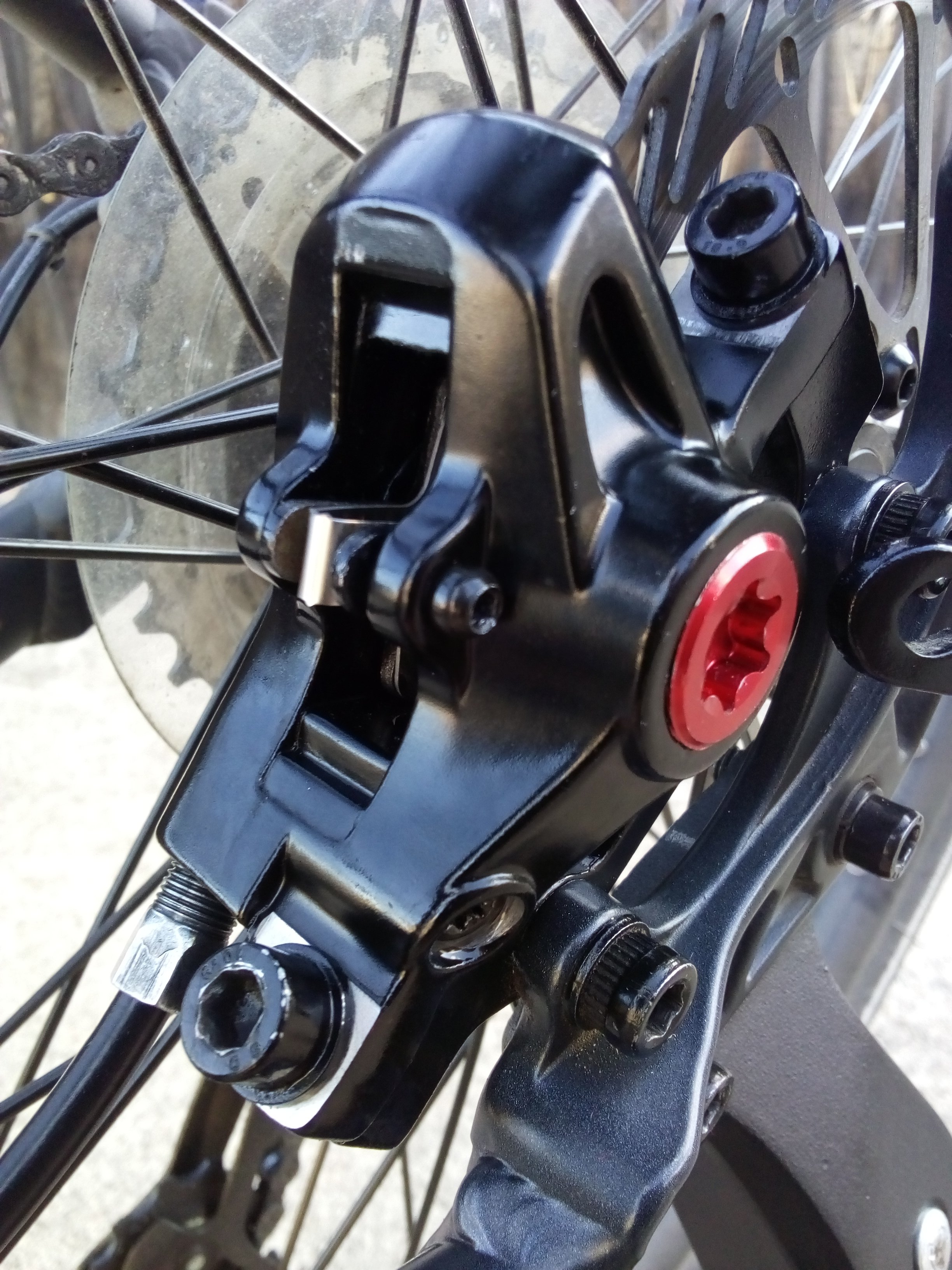

The bike has been destined to pavement riding. The rear brake caliper and lever have been ongoing issue, the front pair not far behind. The NUTT brakes are not great quality overall in materials and assembly. Air leaks continue to pose problems with lever pull getting weaker and weaker. The brake pads are not Shimano compatible using smaller type A03 rather than Shimano type S01 which has become a defacto norm on many bikes.

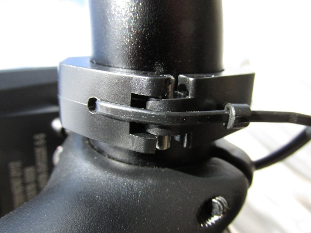

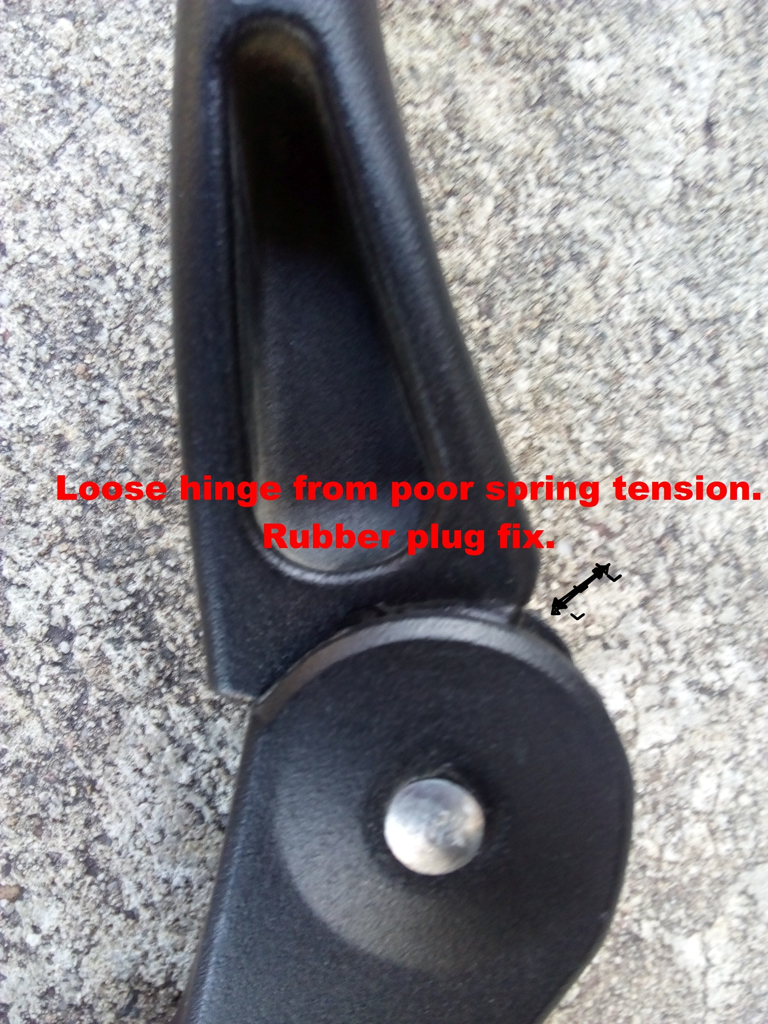

LCD D10 display started coming loose and discovered broken plastic hinge which appears a common fault reported elsewhere, maybe a weak point or over tightened during assembly. DIY repair with cable tie and two small drill holes.

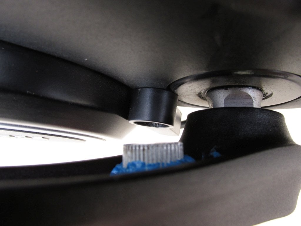

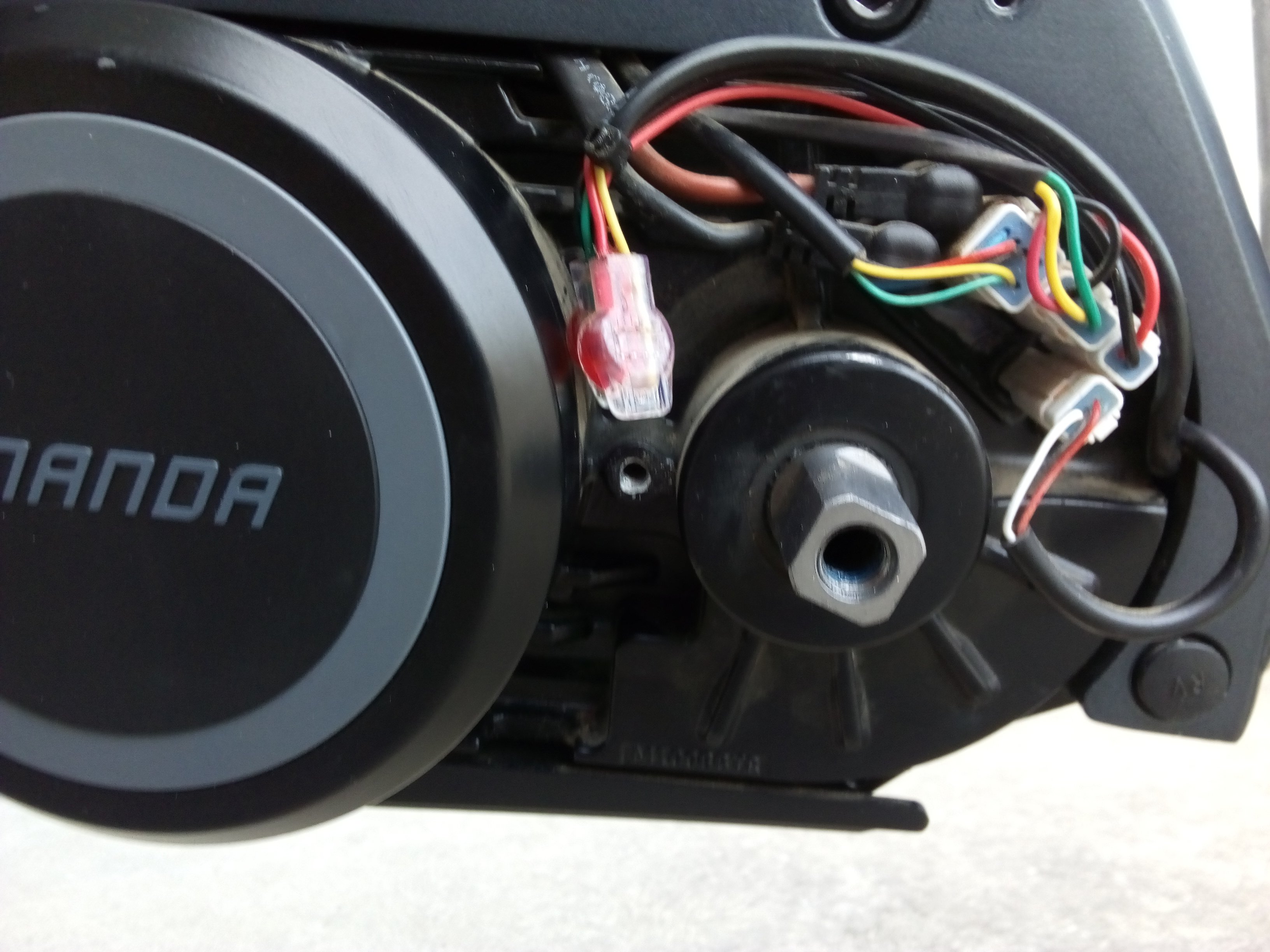

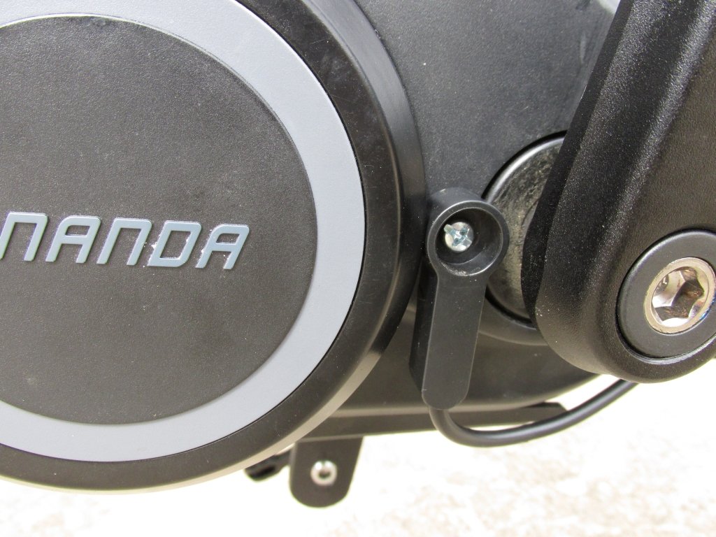

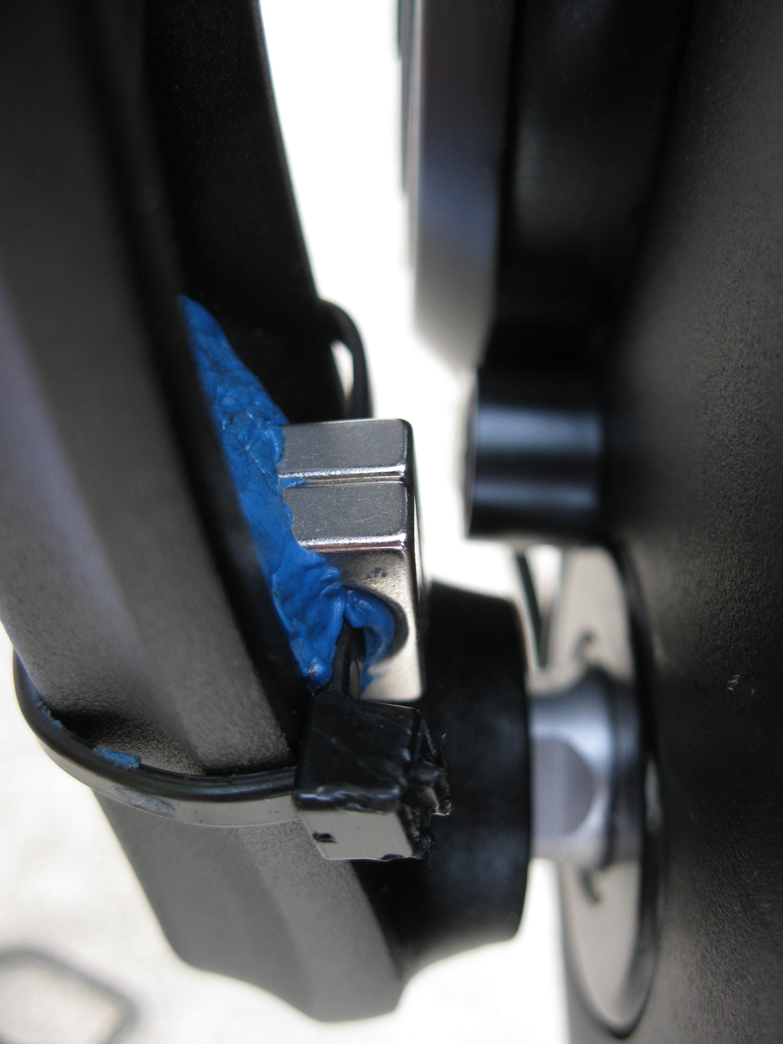

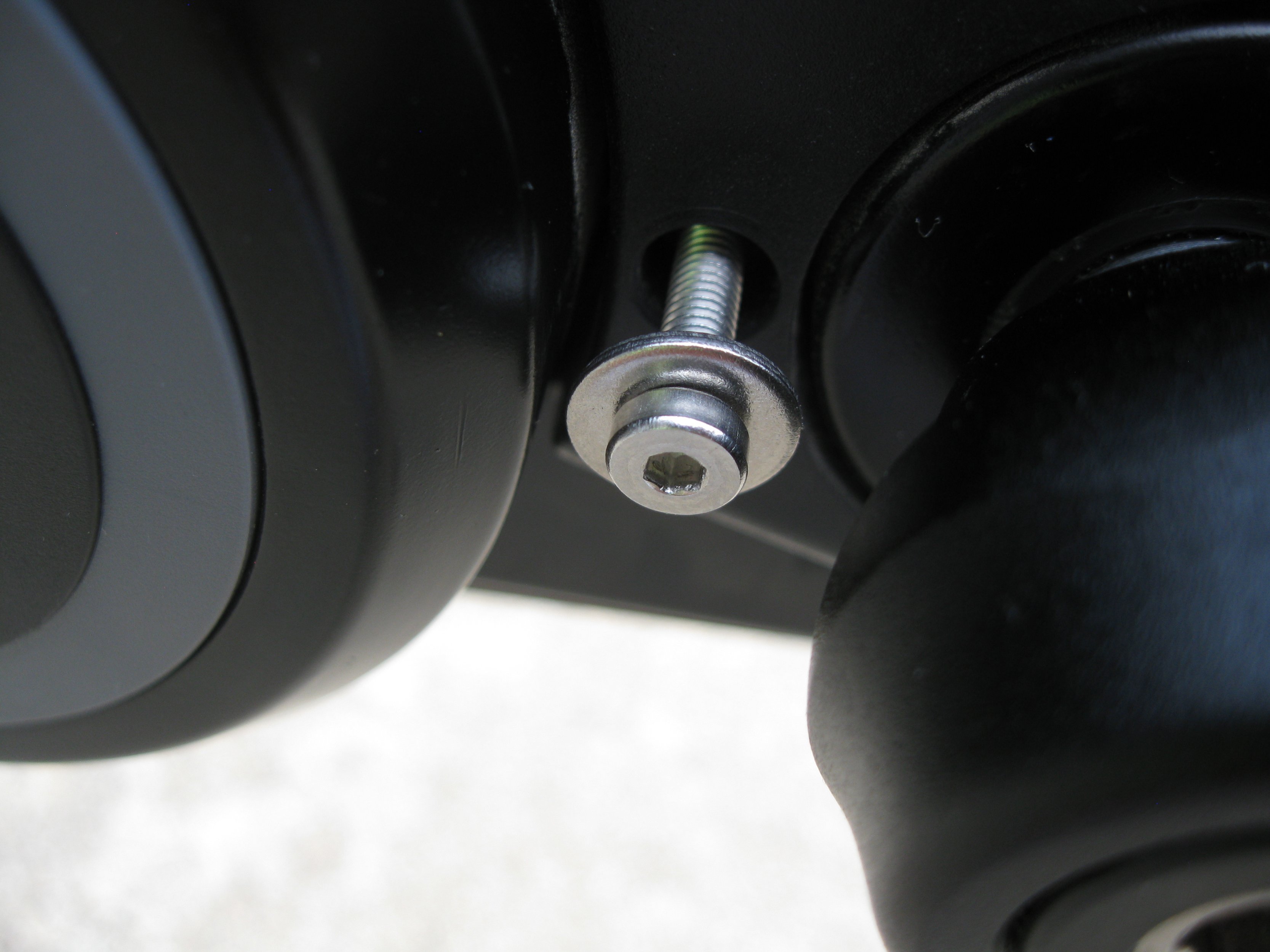

Ananda M100 speed unlock.
I voided my warranty the day I opened the box so might as well share my unlocking modification to remove the nonsense 25kph Australian limit and bring the bike up to the New Zealand 32kph limit.
Relocate the speed sensor from the rear wheel to the side of the motor. This confuses the motor firmware to think you are moving slower and the speed limit cut out threshold is not reached, letting the motor spin higher giving you more speed.
The Ananda M100 has a very convenient screw point on the left hand plastic motor cover. Remove the short M4 hex head bolt and attach the sensor using a longer 15-20mm bolt and washer. The cable run back to the motor 'port hole' is same run length.
Remove magnet from back wheel and attach to inside of left crank arm with some Blue-Tac, glue or silicone. Get the distance between magnet and sensor similar to original position. You can also add a black cable tie for extra security or use any suitable magnet that will be strong enough to activate the Hall effect poles in the sensor.
The upside is a potential speed limit approaching 60kph if you can pedal hard enough. Even in the lowest 50% 1/5 setting I easily achieve 32kph with little effort. (The M100 is stupidly powerful).
Downside is losing accurate speed and distant measurements on the LCD display which generally equates to a third of actual measurements. But the loss of these features are quickly overcome with a bicycle that becomes a far more practical transport option.

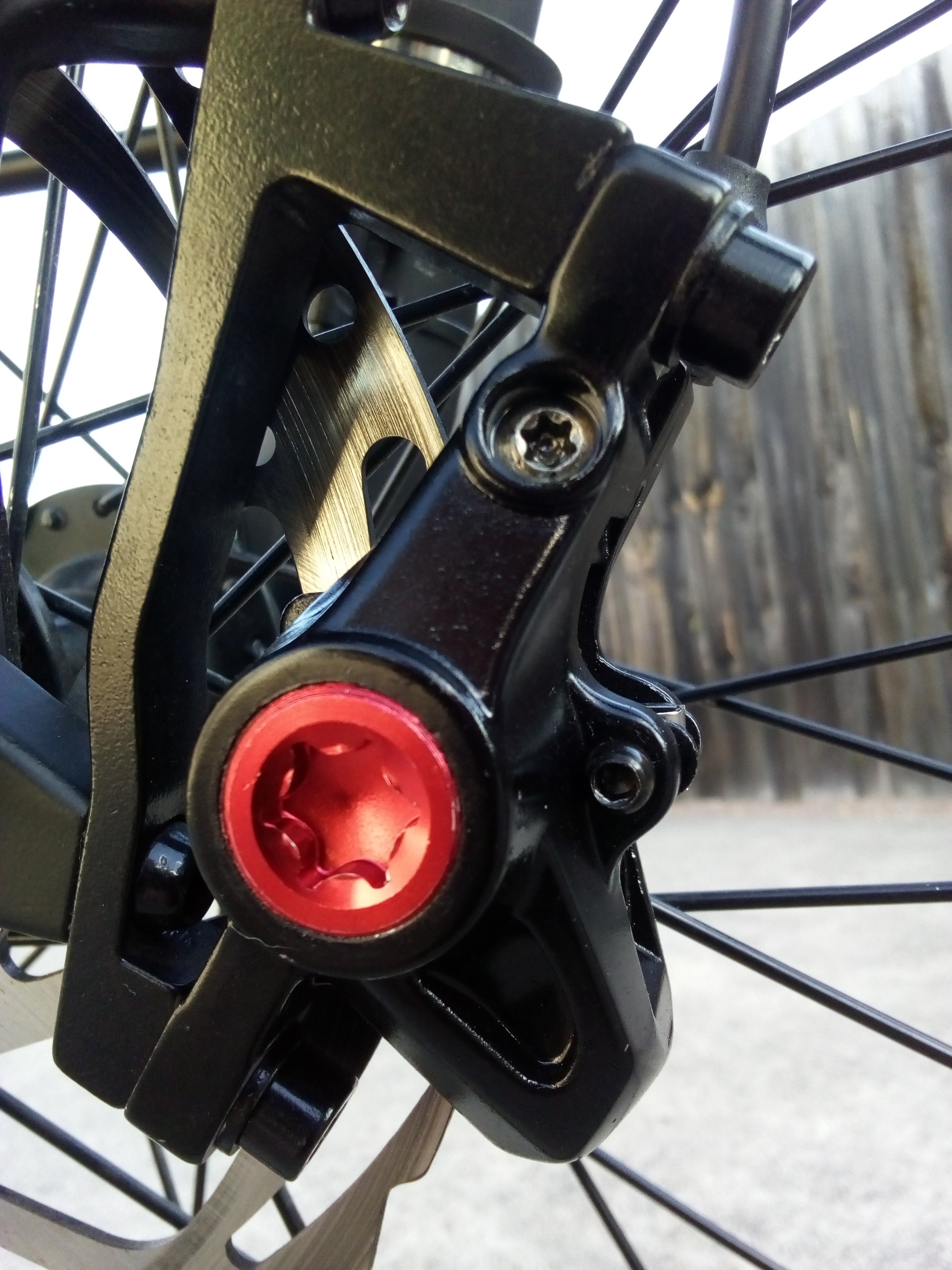

Gone Nutty - I see red.
The problematic low quality poor performance Nutt brakes are finally gone ! Replaced with Shimano compatible units from JSHOU BIKE complete with front 180mm disc for NZD51 landed. Bargain. Standard Shimano / Tektro B01s pads, lines, olives , needles and pad bolts. One piece cast caliper and nice one finger ergo alloy levers. Master cylinder has big raised bleed port. Bike now stops 'on a dime'.
eBikes are heavy and generally faster and the Nutt units spec'd by Reid unsuitable, hence why they dumped them on 2023 model for Tektro units.

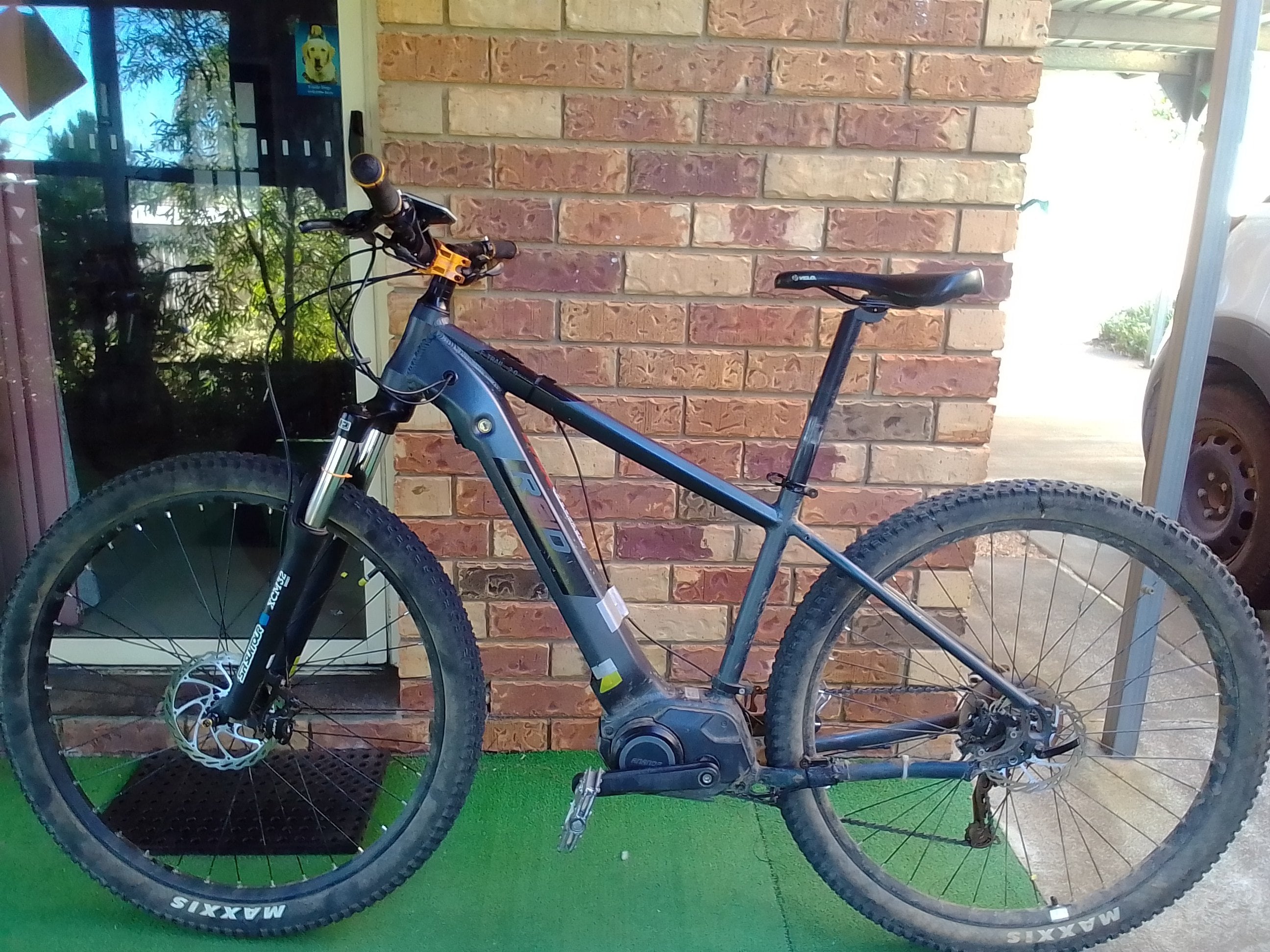

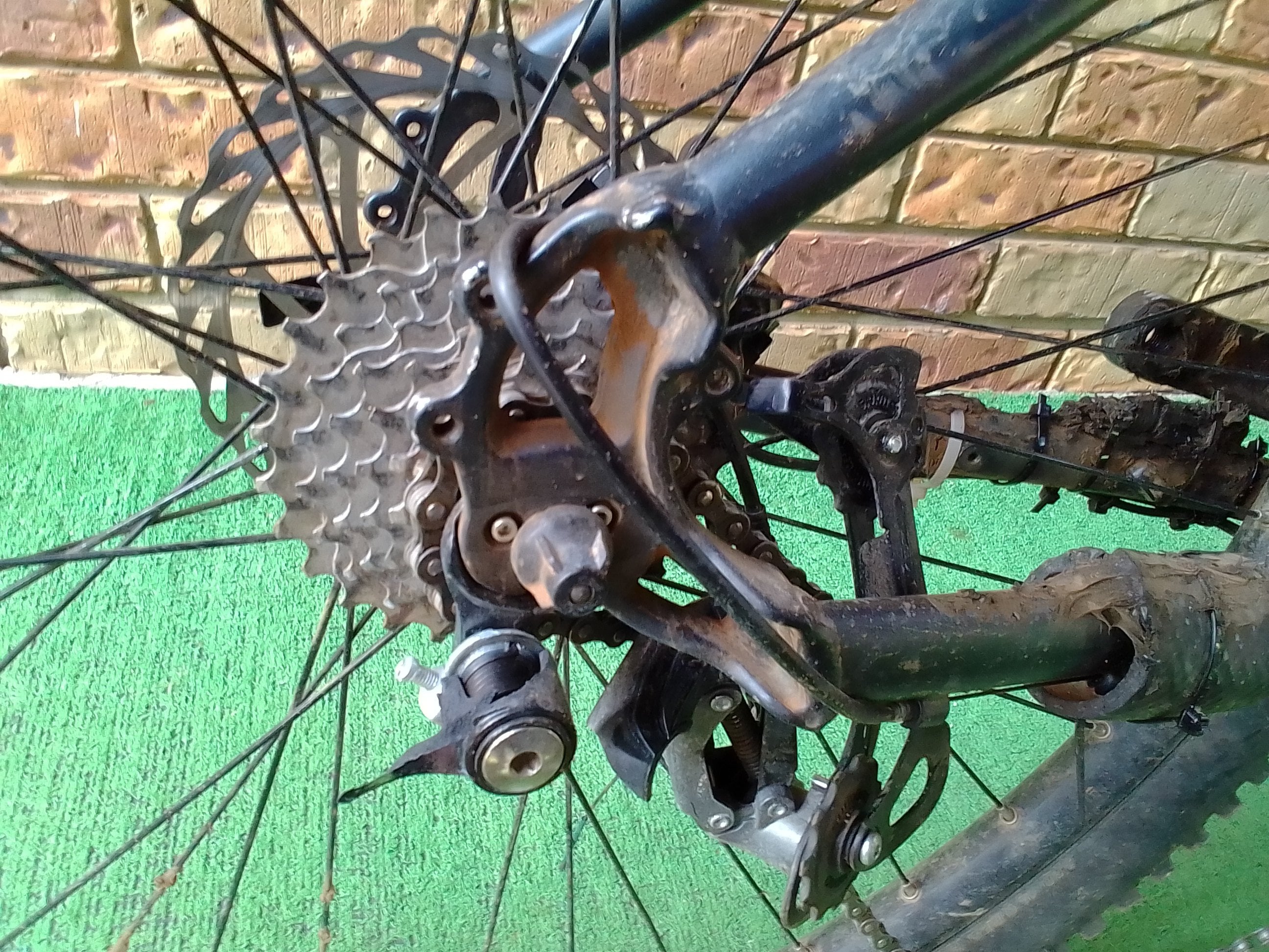

Well worn eTrail ! You need to move that speed sensor to the crank (as above) then nobody will get near you on the track ! (Hello 40kph).
Curious about the cable, wire from top tube to rear of motor, is that some mod you would like to share ?
Thats just the shifter cable , because of the kink where it exits behind the motor[straight route ], and also faster to change as it does not last very long .

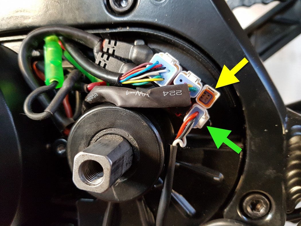

Have you accessed where the speed sensor plugs into the harness , mine is cracking up , i wonder if the motor needs pulling apart?
The speed sensor plugs directly into the M100 motor which has a bank of JST sockets which are soldered to the motherboard and then epoxy glued through a 'window' behind LHS plastic motor cover. Not a bad setup actually. Easy access for diagnostics and modifications. Only issue, if board needs replacing, removing the epoxy resin will be challenging. Speed sensor cable appears standard Giant, 3 pin JST. (Green arrow sensor, yellow arrow 2 pin 6v lights).

Awesome , thank you very much. I ordered a universal sensor from ebay[ $15] and the plug looks the same, i might be lucky and it will work.

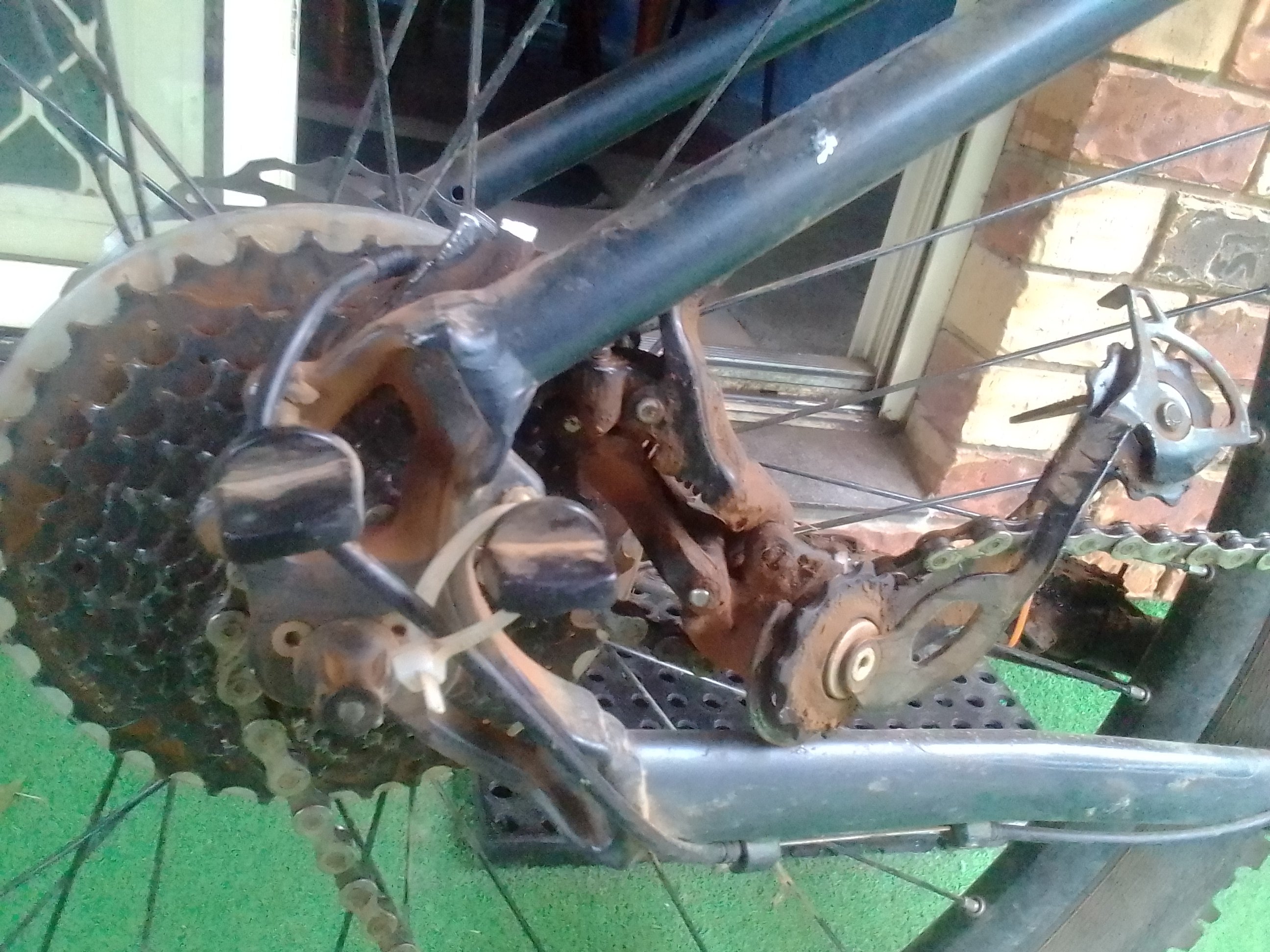

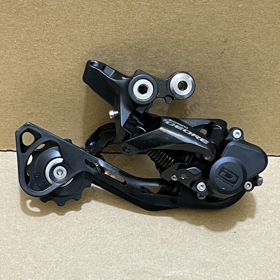

You might consider a derailleur guard to help minimise total destruction. Buy a few as they are cheaper to replace. Just ordered a near new second hand Deore RD-M6000 for $50 to replace Mr Clunky Altus.
  • Like
Reactions: ari
I v been using the Altus 7 speed because of the 7 speed chain being stronger, i snapped few of the 9 speed chains , and the 7 speed deraileurs are only $14 on ebay. All the breakages have been due to rocks, sticks and the nut behind the handlebar not putting the chain on properly after dropping it :D [chain across the cassette instead of in a one gear, as in shifter ]

I still love riding this bike over my stupidly expensive and complicated Giant ! There was enough length in the cable to re-position it on side of motor. The main problem was sticking a magnet inside the crank groove as it's curved.
I re-engineered and put sensor on swing arm and bigger magnet on the crank in line with pedal axle which is steel and sticks firm, then added some Blu-Tack for security . Works the same and a more permanent trouble free location. The Ananda M100 is stupidly powerful and I run around the streets in just 1/5 assistance.
