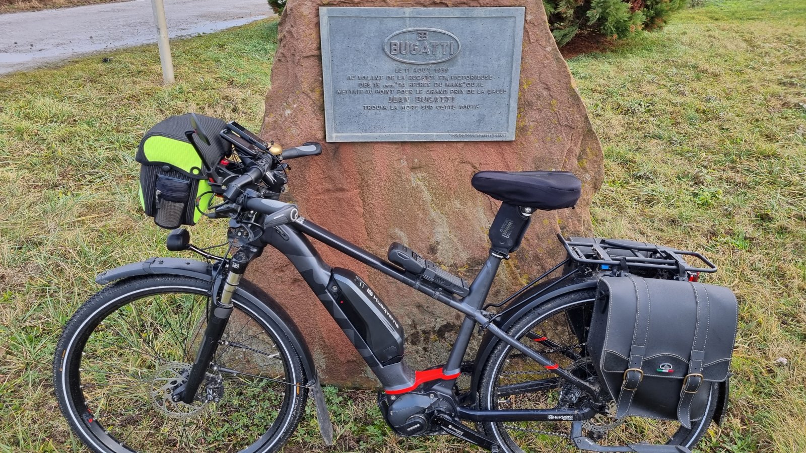

Frame and fork of my Husqvarna GT2 are well built for the money, but I had to change everything around them.
On the other hand the lacquer coating is exceptional. No any sign of fatigue through the years of riding.
And I'm not talking about the four BT-E8010 batteries (one dead after 500 km, the other are dying since the first day of use),
and about the two former E7000, and about the E8000 motor, but here it is Shimano who is guilty.
All in all, I made 23.812 kilometers since Mai 30, 2019 in FR, FIN and SE.
Today I have another problem to solve, and Husqvarna (PEXCO) and my LBS are not able to give an answer or to help.
The rear hub Formula DC-4621 has now to be renewed (32 spokes, 6 holes, QR 142 x 10, Shimano 11 freewheel)
But after weeks and weeks of searching, I couldn't find a 142 x 10 rear hub.
What to do?

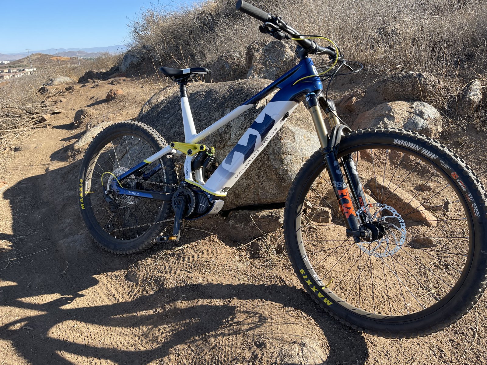

Ok after a few rides I'm really starting to like this bike! I think I have like 25 miles on it only. Of course the upgrades made it much better than stock. So far I've added a DVO Topaz rear shock, Fox 38 factory fork at 160mm travel, Maxxis Minion DHF 2.5 front and Dissector 2.6 in the rear (tubeless set up of course), and some ODI Dread Lock grips. Next up some Spanx bars just trying to figure out what I should cut them down to since they are over 800mm. Then seat and maybe some wheels. Brakes and drive train when it wears out.
Now I just need to ride some more trails and test its high speed feel and some real jumps!
