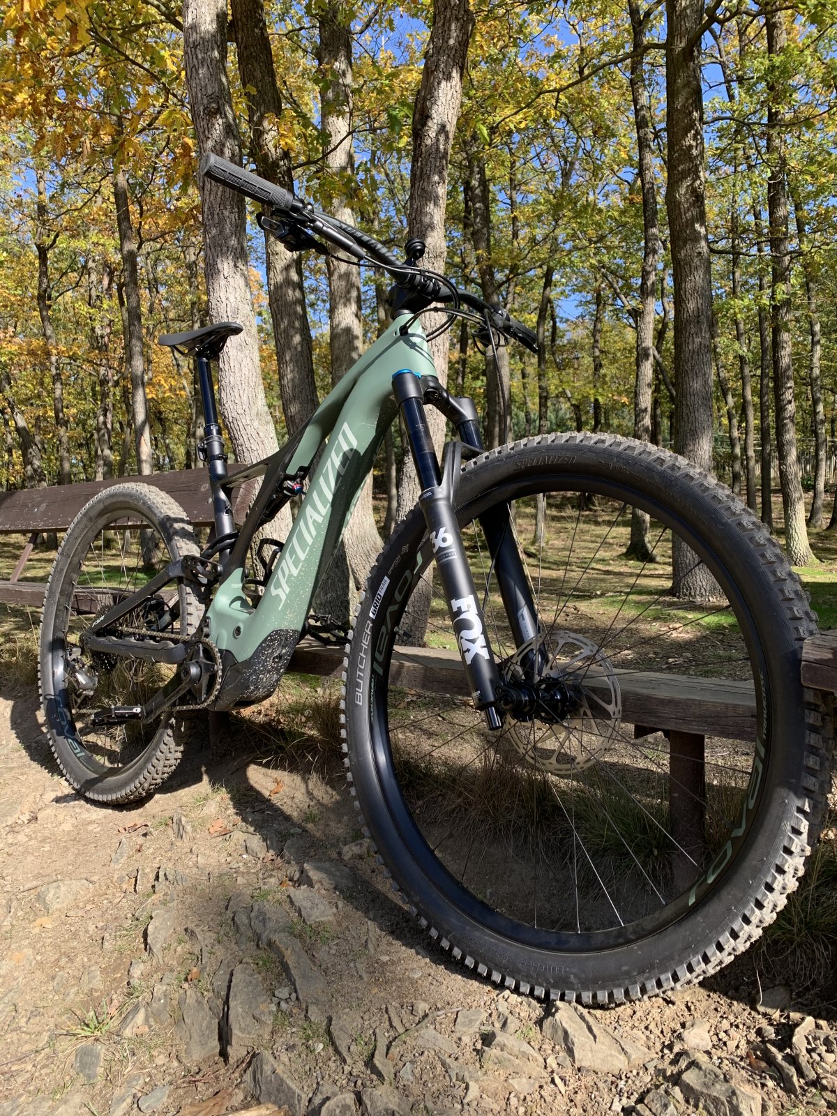

Same with my Lyric Select + fork, I am upgrading to a Fox 36.
That's a debatable upgrade. Which 36 fork? The Lyrik is stiffer than the 36 and if you upgrade the damper on the Lyrik to the 2.1 Charger it helps it immensely which will be way cheaper than a new fork.
FYI I replaced my Lyrik but with a Mezzer.....so much better than either other option

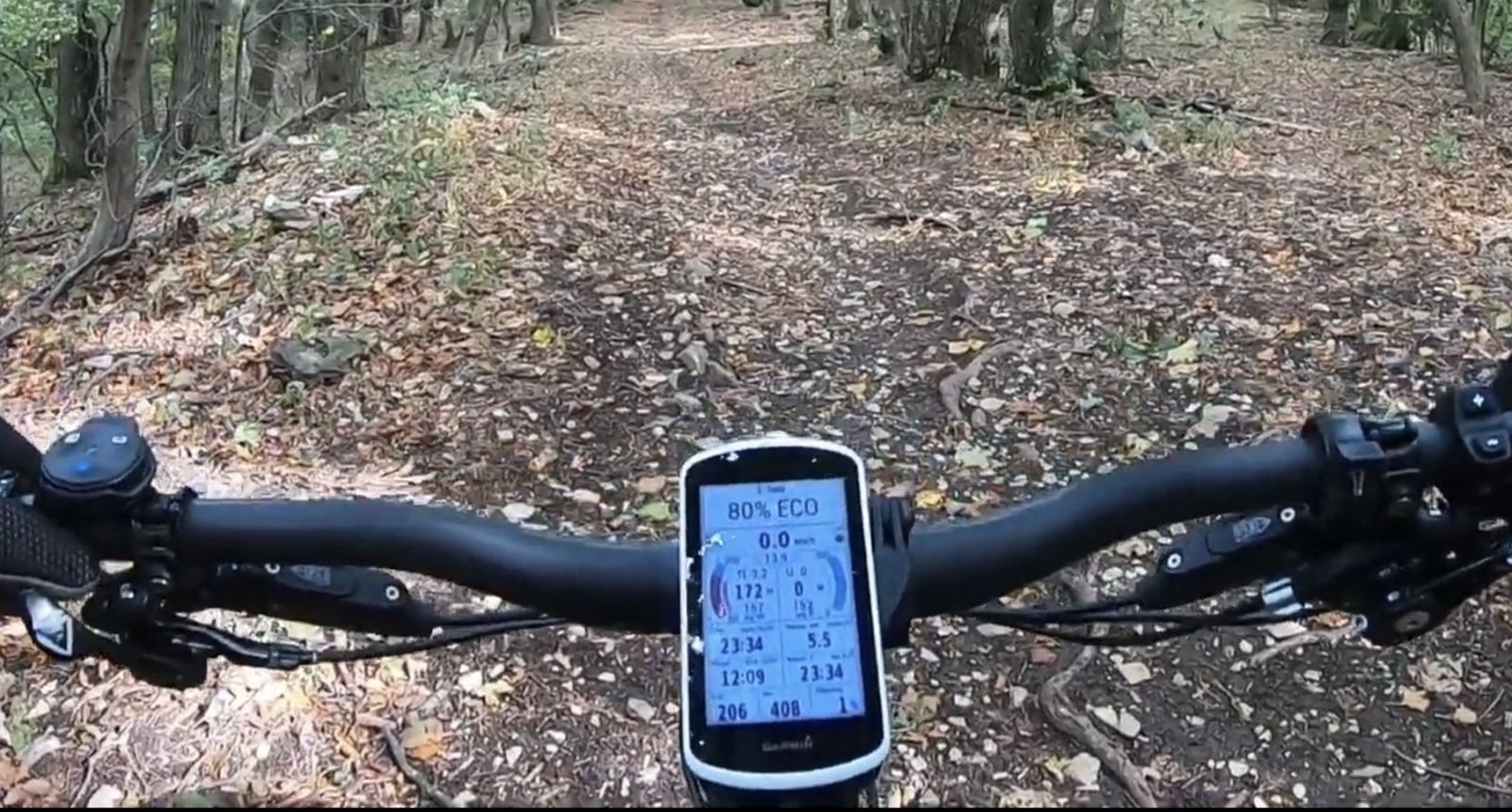

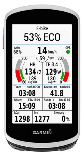

which Garmin datafields are displayed in the middle?
The entire display, except for the upper ebike field, is created with the IQ-Datafield DIY (design it yourself) by easuvorov.
DIY Data Field (public beta)
If you are interested - pm me - I‘ve created a guidance-pdf.
Interesting is there mapping capability with this installed?
Yes. I use the screen shown before, a screen with OpenMTB-map and an elevations-screen. But you can also set up more screens. I switch between the screens with the remote on the handlebar. (It‘s a Garmin Edge 1030)
Edit:
now I‘m not sure... If you mean „can I use maps inside IQ-datafield DIY?“ - then: no!

Very interesting, do you have the code string for the illustrated screen as I like the layout a lot.
Thanks
Karsten
Hi!
Please pm me your email. I‘ll send you all you need!

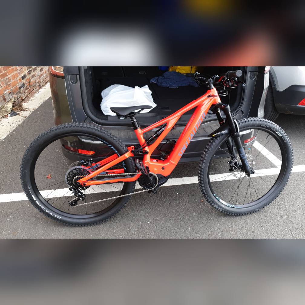

Got out on the new bike when I was home but the weather didnt want to give me a break so off out we went to a local country park when the weather slowed down for a couple of hours. So it was a easy XC park slog featuring wet roots, mud, bad camera angles and a wobbly rider.
Went home soaked and happy.
Wow to everything! I know what you mean about camera angle...chest mount gives you great maybe the best perspective but not the best spot for maintaining best horizon ie. tilt and not the best spot for a 360° camera obviously. One other thing you probably already know riding in those conditions especially - thick waterproof grease on both sides of the crankshaft bearing is a great idea (y) It is possible that 2020 models have better seals. They should have.

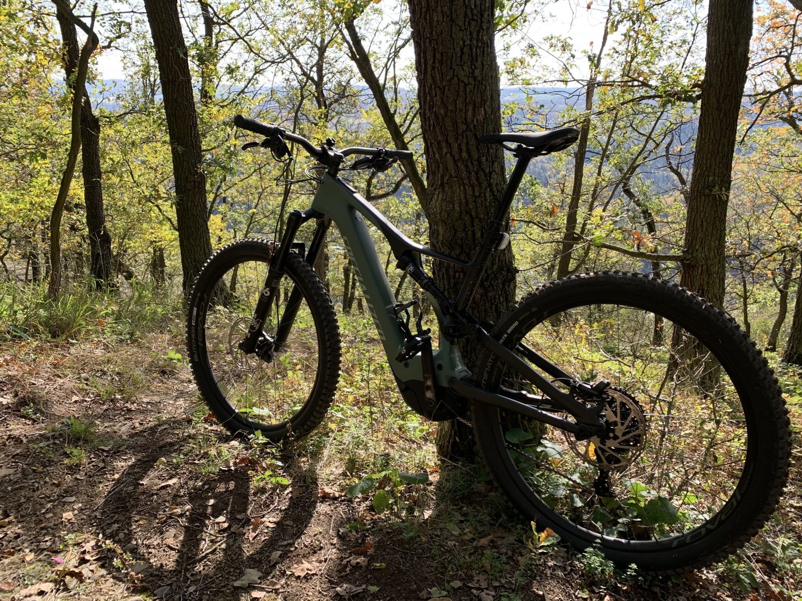

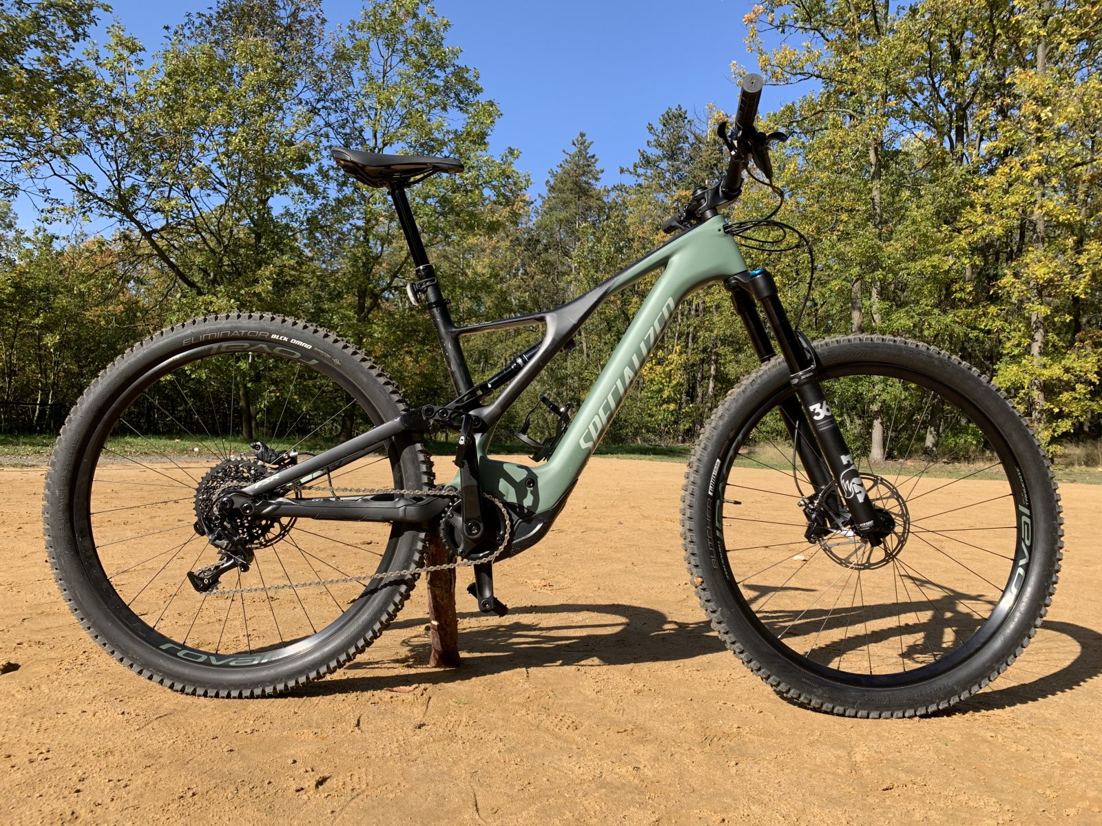

My new Turbo Levo carbon Expert 2010 has been finally dellivered. Great bike. More down the hill oriented than my previous 2018 Levo expert. Fox Fork and Suspension are great! Very light feeling. Moore like non electric bike than ever before.
thanks for these Karel..that looks soooo good , waiting on a call from my LBS to tell me mine is ready.

Fox 36 Factory. Although I dig the 2.1 charger mod, can you elaborate please. Is it a simple DIY upgrade?
I just don't have much love for Fox forks. I've had lots of warranty claims with them and I personally think they are overrated.
The 2.1 damper mod is super easy. Undo the bottom nut, tap the damper rod free, unscrew damper cap and lift the damper out. Replace with new damper. If you wanted to go all out you could put an avalanche damper in the Lyrik, that would fix most if not all of your front suspension woes. At a cost though lol

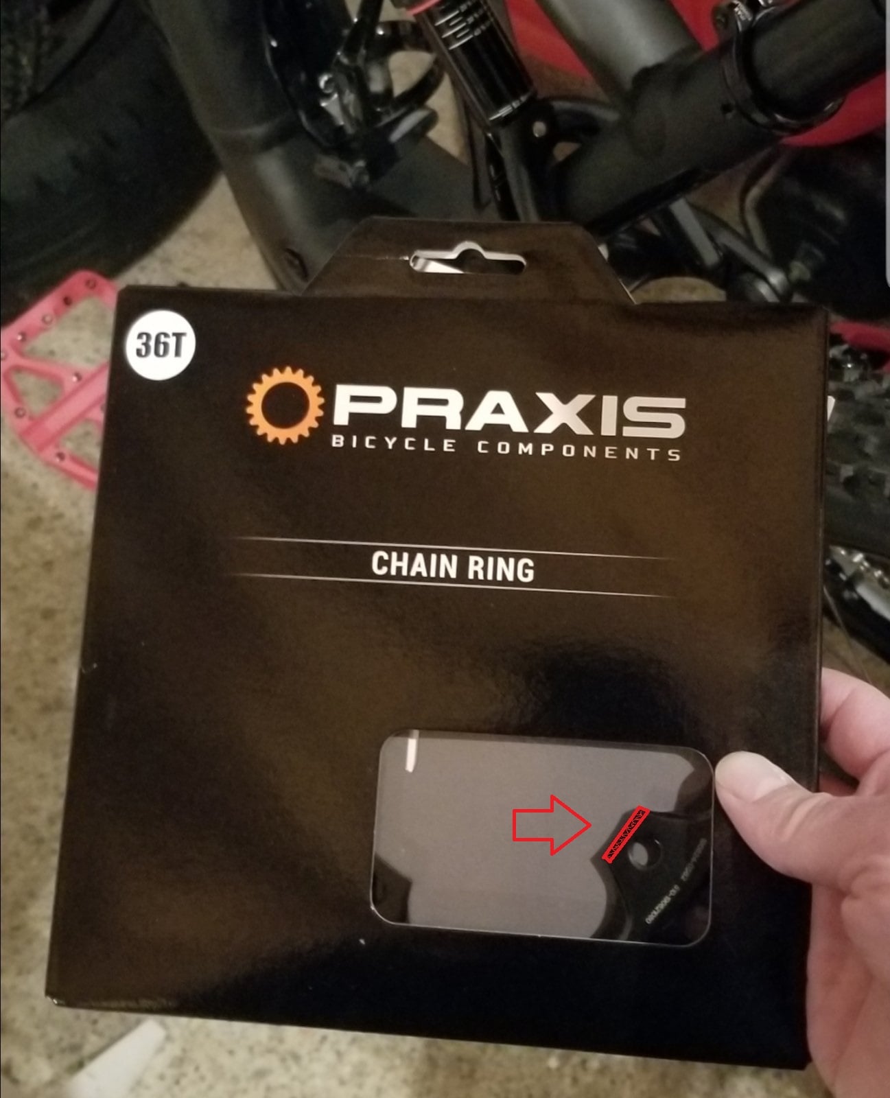

This is going on tomorrow once my chain guide adaptor comes in!
I tried to fit the exact same chainring and found that the attachment lugs will need a few millimetres grinding off the inner edge to allow it to sit correctly on the spider.
I was unable to actually do the grinding because the Praxxis ring was for another bike.
It looked as if the original chain guide would be OK but can't be 100% sure until I actually get the Praxxis chainring fitted.
