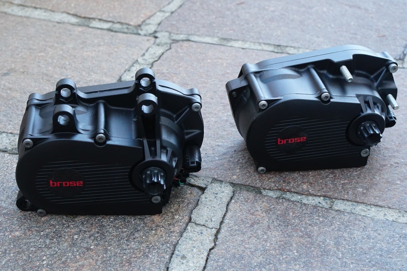

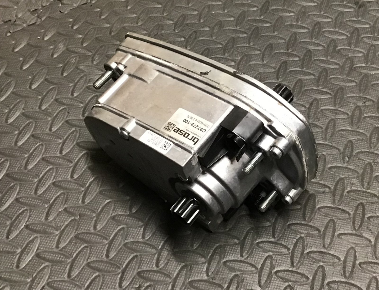

I wonder if an adapter plate could be made?
Found the links and images from @Kiwi in Wales and @Peko . The Mag S layout looks completely different to the 1.3 :-( Looks like you're stuck with your 1.3 ...

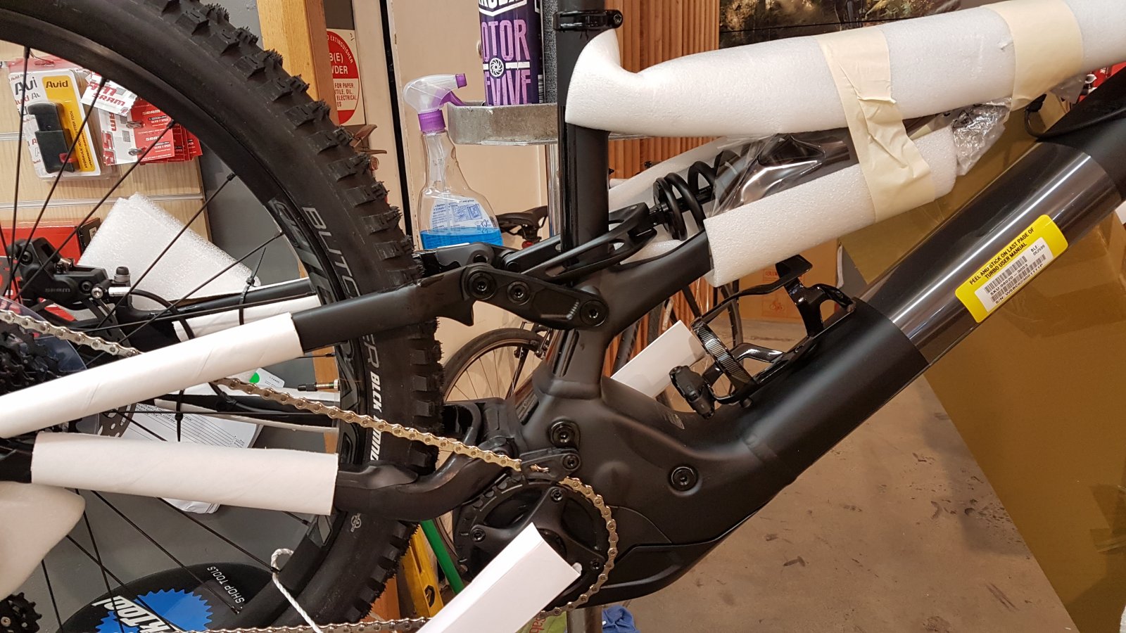

So does anyone notice how the shock attaches to the yoke ?
Could open up immediate shock changes to those who wish.
View attachment 19440View attachment 19441
I know a guy who would be up to the challenge to make an adaptor to make this work. He’s always making one off components and work arounds for bikes on his cnc milling machines. It’s what his business does.
Unfortunately I do not have the dollars to throw at him to do this. ?‍♂️
Check out some of the one off stuff he machines on his Facebook page. HighGearRacing
Specialized did away with the proprietry shock mounts in 2019, should be your typical eyelet.
it's 230 x 62.5 which isn't exactly a common stroke, knowing specialized a 65mm stroke will work without tyre contact and you could in theory be nearing 190mm rear travel.

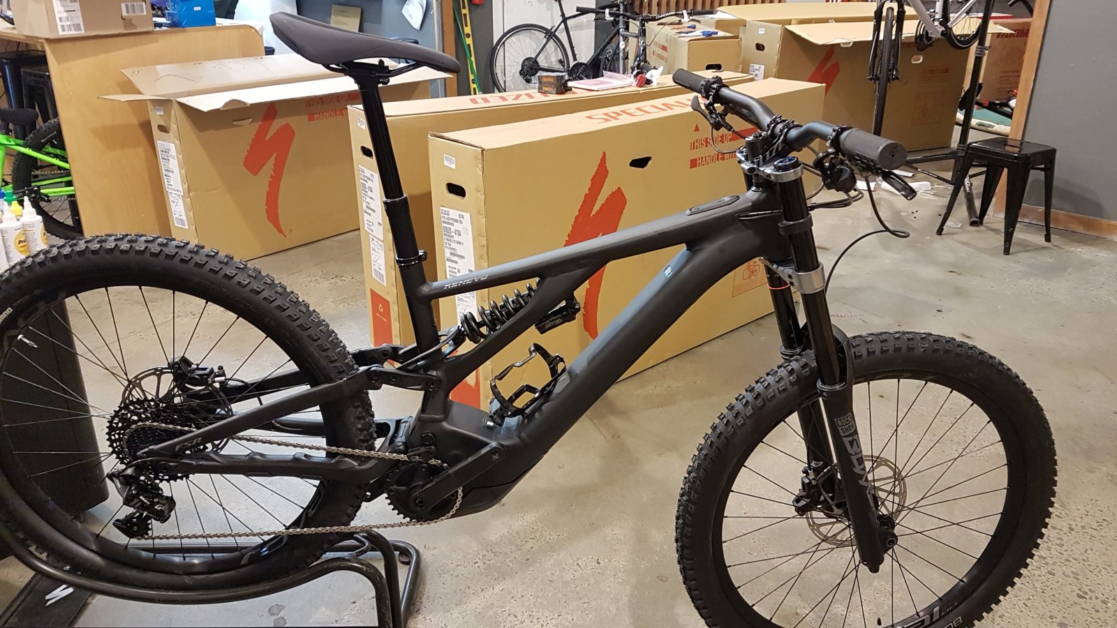

I've seen the S4, sat on it and ridden it around the shop.
There will always be knockers, no ones actually ridden it yet but already judging it.
Don't assume the dimension figures equate to what you'd expect as it's the combined geometry that brings it all together.
In reality it's not as big as the figures suggest, in fact it seemed a lot smaller......
The top tube is about 30-35mm (at a guess) longer than my Large '18 Levo, but feels the same reach wise.
The seat angle means that at full extension of the dropper you are further forward over the bars - so assuming it will be better at climbing and general pedalling than it's predecessor and when the seat is down the reach feels perfect......I actually like it, seems quite clever to me.
