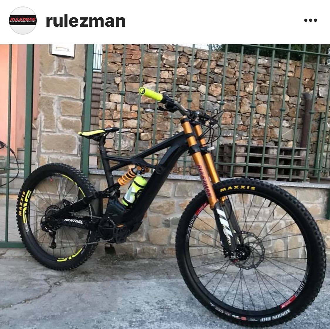

Going to have to swing a leg over one of the comps, tempted to build up the dove grey one with 700wh battery, Red lyric Ultimates, and a Super Deluxe Ultimate with the red spring for pimping points.
As much as I love a DH fork, I think overkill and probably a pita for my local trails.

Actually thinking of doing something similar. I have two spare 700wh batteries already and I have a new Manitou Mezzer that I haven’t put on anything yet. On the back I might order a Cane Creek DB coil. My current Kenevo is black and I don’t really want the dual crown fork, so the expert is out for me. We won’t see the bike in our shop till November, so I have some time to plan this out.
I would leave the Marzocchi shock on and change to a lyric however would be interested in your setup ! Don’t the cane creek shocks have way too many dials ?

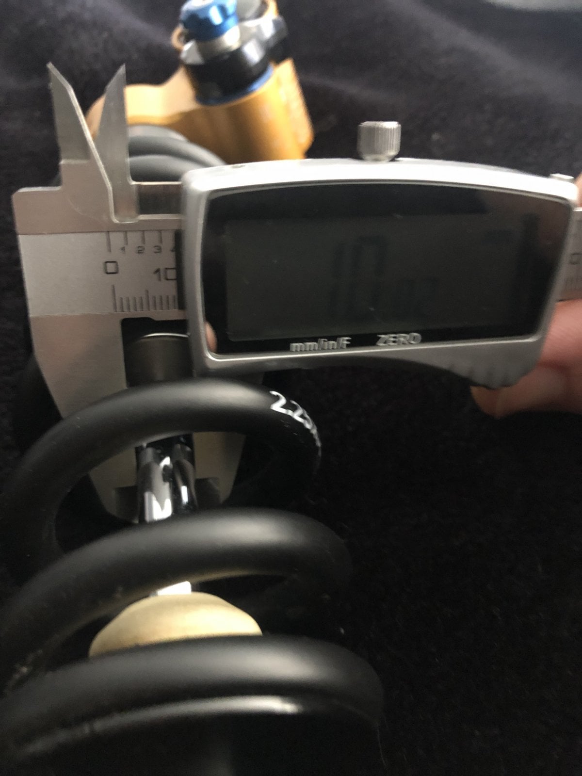

The Cane Creek is a Twin Tube Shock with a 9.5mm Shock shaft. Because of the clevis Yoke design on the Specialized FSR system, the shock is subjected to lateral forces not found on other suspension designs. Since Öhlins, Fox and RockShox use 8mm shafts on their shocks, the 9.5mm Cane Creek Shock shaft well give me extra piece of mind when I inevitably end up hucking to flat.
Yes there’s a bunch of knobs on there, luckily I know what all of them do. Plus Cane Creek are made here in the US so I can order a custom spec Shock.
This winter I will building a dedicated suspension lab in our shop with an automated shock dyno so I’ll be able to measure changes accurately and show my clients graphs of suspension curves.
This bought a smile to my face. I've been a user of CC products for a long time, I was one of the first to put a DB IL Coil on a new gen stumpy, then stumpy evo, I snapped a bunch of them in short. In collaboration with CC I was one of the guinea pig/testers for the new shaft and eyelet design. As of June this year, the IL coil is "stumpy/levo compatible" It was a cool thing to be a part of considering I'm all the way over in Australia, but I think in the end the result is worth it. The side loading issues should be a thing of the past.
There is a DB Air CS Upgrade coming too, think X2 killer ;)

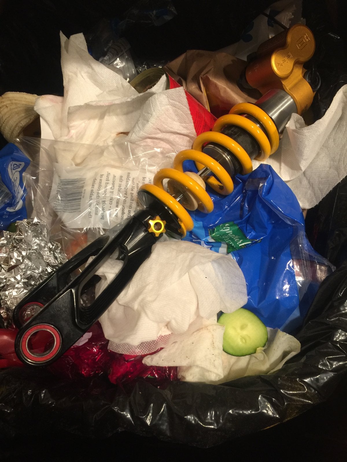

Hahah I’m guessing you don’t like Ohlins. Can I ask why?
I personally am not great at telling the difference between all the brands but I have ridden Fox, RockShox and obviously Ohlins and I find them all great to ride.
You are obviously a cane creek fanboi and I know you Americans are all about American made but it helps to give genuine reasons as to why you think they are so great.

I think the Cane Creek In-line was a piece of shit and I don’t find their fork too impressive either.
Why don’t I like Öhlins? I do like Öhlins. Almost every motorcycle I have owned for the past 30 years has had some Öhlins product on it.
But when it comes to products made for bicycles I have had nothing but problems with their products. Which almost lead me to believe that Öhlins bicycle products were a licensing agreement between Öhlins Sweden and some Taiwanese suspension manufacturing company.
I am a top 50 Specialized dealer so I dealt with my fair share of Öhlins warranty claims.
The quality was really inconsistent on the first Specialized Bikes with Öhlins. Everything from leaks, blown shocks to catastrophic failures.
Then there was the inconsistency in tuning the shocks. Two identical shocks on two identical bikes with identical air pressure and set up would yield completely different suspension tunes and feels. Knobs that never seemed to do anything and knobs that would set the suspension up one way to feel completely different 10 minutes later. I was glad when Specialized got rid of most of the Öhlins spec in their bikes.
If you’re not that great at telling the difference, consider yourself blessed because you’re going to save a lot of money not shelling out for Kashima coated marketing terms.
As for the condescending “You Americans” remark, well I could give a fuck where anything is made, just so long as it’s made well. My comment was that because the Cane Creek is made in America and not Asia, I can order a custom shock from them directly. Can I order a custom Rock Shox or a Fox from their Asian factory? No
As for the genuine reasons as to why I am going to go with a Cane Creek DB Coil,

I was merely asking your reasons for such hate as you put up a photo of one in the bin.
I do like that Kenevo though, even with its golden forks.
Thank you for your spirited yet informative post.

Yes before Öhlins entered the bicycle market the Twin Tube design was licensed to Cane Creek. Fit and finish of Cane Creek is superior to Öhlins. Then there’s the performance
