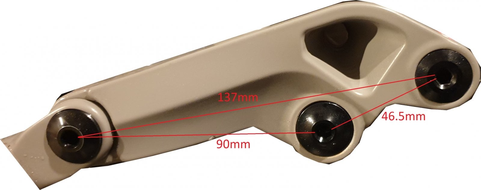

I've taken the escarpe with the new shock for a ride and all is good. Managed to bottom out the shock and no issues (same as when I first tested the shock without air). Just need a bit more pressure or some tokens in the shock now!
I've attached an image with the measurements between the bolts (taken with calipers on the inside edge of the hole) in case it's useful for anyone else.
