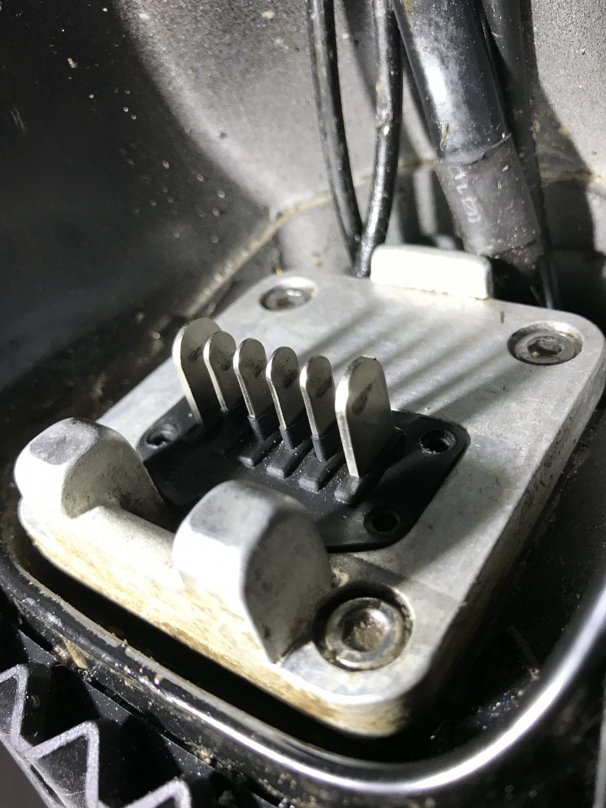

Hi there stu... Just showed this thread and your video to a friend of mine who has had exactly the same issue with his 2020 reign. His is currently in the shop (5 weeks now) waiting for parts from giant UK to remedy the issue.
From what he said there's an issue with some bikes where the battery is not 100% tight in place which can lead to them not contacting the terminals properly which gives this problem.
Again from what he's said, Giant UK have said that it needs a shim of some sort to sit on one end of the battery which should force the battery to contact the frame terminals properly.
Hello mate.
Thanks for the reply, I had the shim issue with last years bike actually. it sits under the contact plate in the image below and raises it about 1mm. I’ve got the Giant instruction sheet for it somewhere. 5weeks! Could do it in under 5 minutes. :(
I’ve measured the contact on this one and it’s fine as far as I am concerned.
In fact, you can see the contact points on mine.
You can however see how We’re they 1mm lower it would be on the bevelled edge and therefore unreliable.

Stu is correct, but to be more specific, the shim goes under the black piece in the photo. I originally made a silicone shim and put it under the larger metal piece. That was before I saw a shim and only read about it. It worked but still momentarily lost power on rare occasions. The Giant shim under the black piece has performed perfectly.
