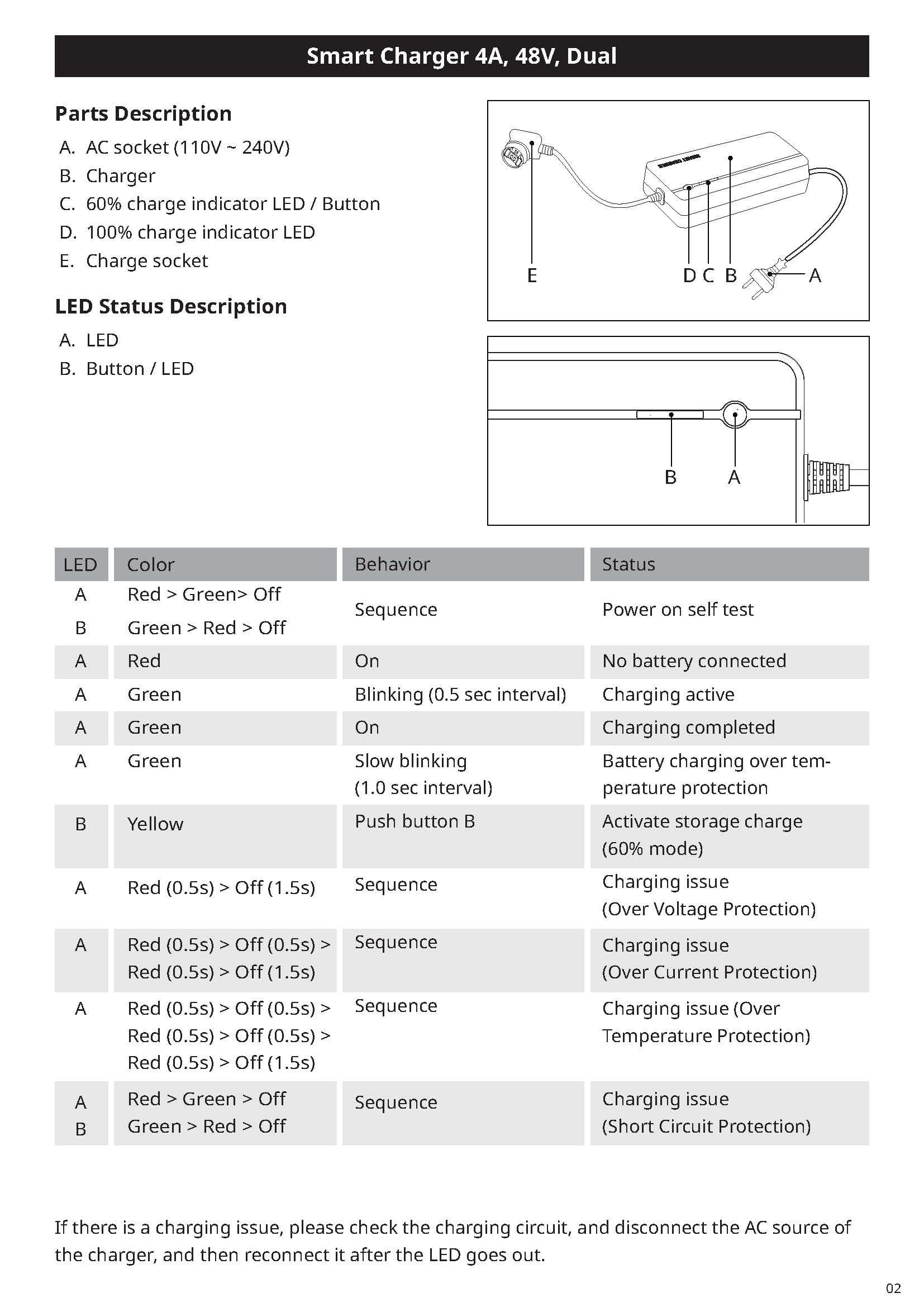

BMS units don't 'shut down' they fail. Have you tried charging the battery off the bike using the adapter ? The charger LED sequence can shed some light on problem (attached).
Replacing BMS is a chore, and you can use any off the shelf unit which is cheaper, as long as 36v is presented to the circuit the bike will operate. Suggest you DON'T update any firmware/s.
Another member here has BMS repair instructions. If you decide to replace the battery, harvest all the parts to eBay, cells, case, battery clip are worth money and remove the cover. Don't give it back to Giant dealer for 'recycling'.
