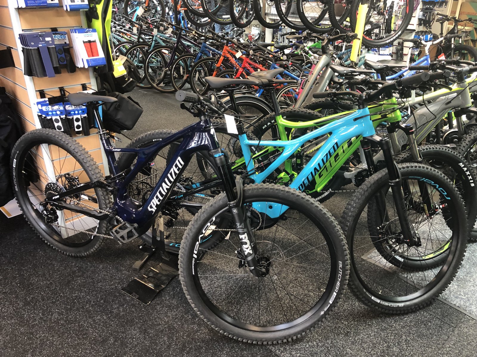

Rung Berkshire cycles today to enquire on any medium Levo 19
Really wanted Expert carbon in monster green / black but would consider anything
Just so happens one had just landed
Did me a cracking deal without even asking.
Picking it up tomorrow
Just a bit excited !!!
