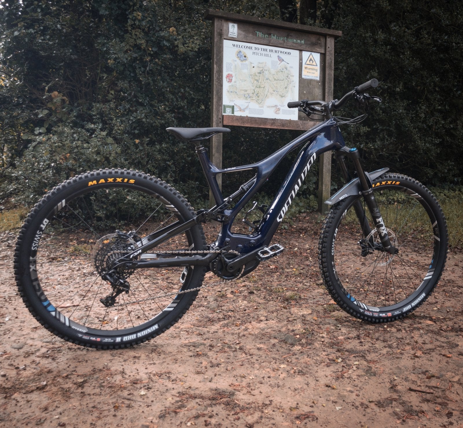

First proper ride today.

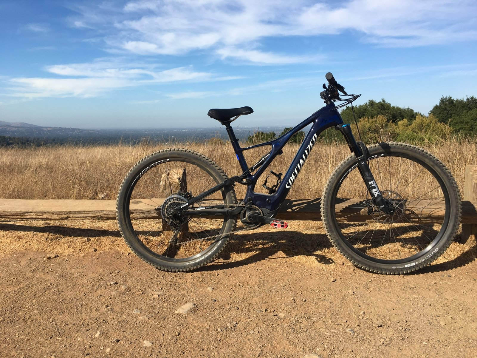

My new 2019 Turbo Levo Comp Carbon at the top of our local hill in Los Gatos, CA- ridden this loop many times but first time up on my new Levo one happy rider
