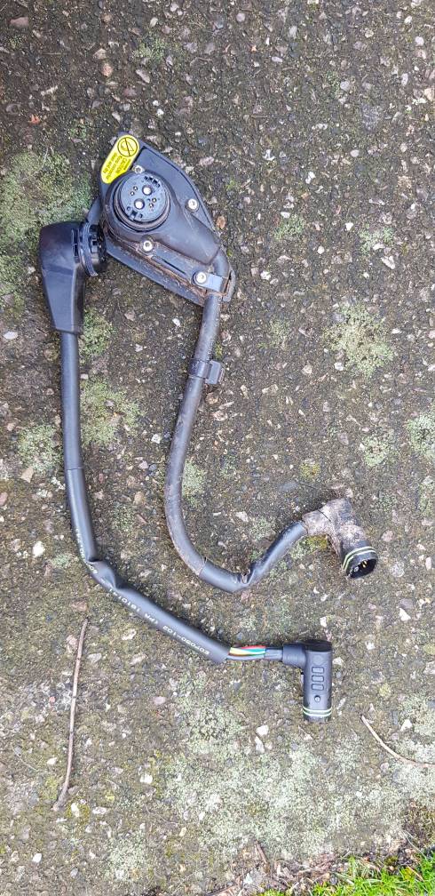

Prevention is better than cure. Proven electrical rules on cable radius create high resistance at choke points leading to short, heat and possible damage to canbus lead transfer. The sensor wires within the harness are also affected.
No electrical engineer would fit a cable that kinks like that.
Correct its not very good practice with longevity in mind.
Well the despite the kink, crack and "gunk" on the power lead, a swap changed nothing. So I don't think it's just the kink in the lead to blame on the faults. I don't really see the point in this unless it's proven to fix/prevent something.

When I look at the below picture, I don't understand why the exit from the part plugged in is not on the other side (left in picture) then the cable would be half the length and be straight without kink. Or is that too obvious,
When I look at the below picture, I don't understand why the exit from the part plugged in is not on the other side (left in picture) then the cable would be half the length and be straight without kink. Or is that too obvious, View attachment 11518
Absolutely agree, my guess is its just the same cable from the 2018 bikes

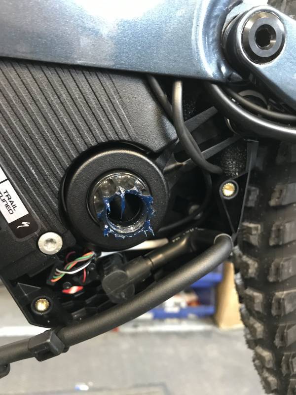

The bike shop phoned me today. Apparently the problem is that the plug that goes into the motor is cracked (which I think I have just seen reported by someone on another thread today) This has allowed moisture/water in and the bike does not switch on as it detects a short and protects itself. I got the distinct impression this was not the first time they have encountered this issue. A new wiring harness is required and will be requested from Specialised. Apparently the plug in question has been modified. Lots of other post have suggested the cable is the problem, and I know Specialised have said they have not had a problem with the cable in regards to kinking - maybe this plug is the issue?
That's good to know, because it's probably what mine needs.
Yes my cable had a crack in it. The replacement one looked identical though.
Specialized were quick to get in touch and arrange a new cable, which I fit myself. But since that didn't fix it it's all gone quiet. They're not getting to me and the shop not returning my calls.
