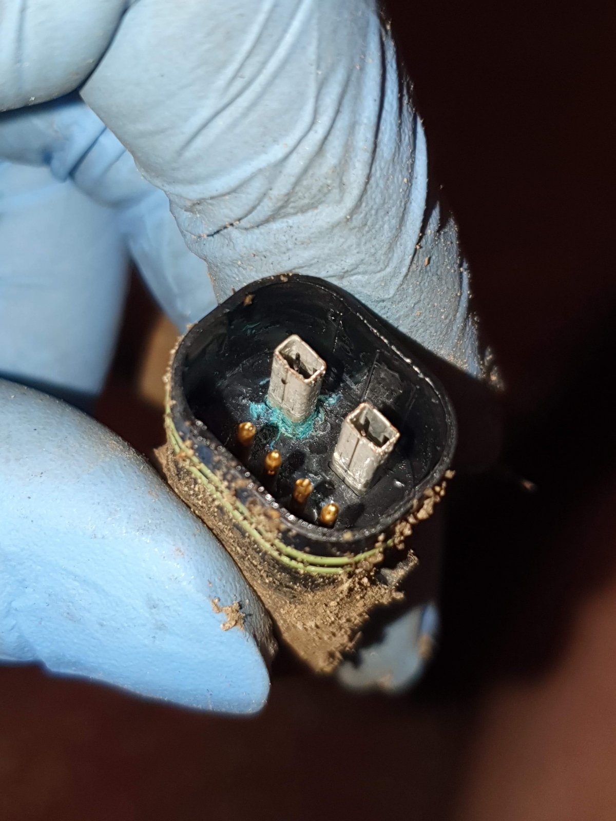

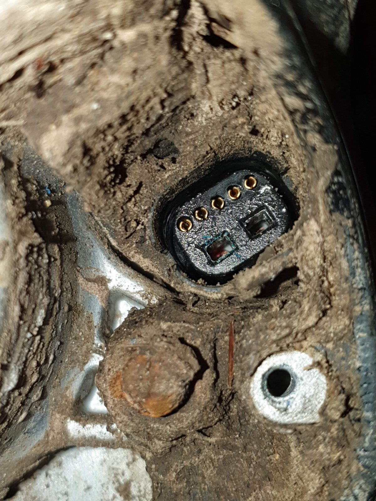

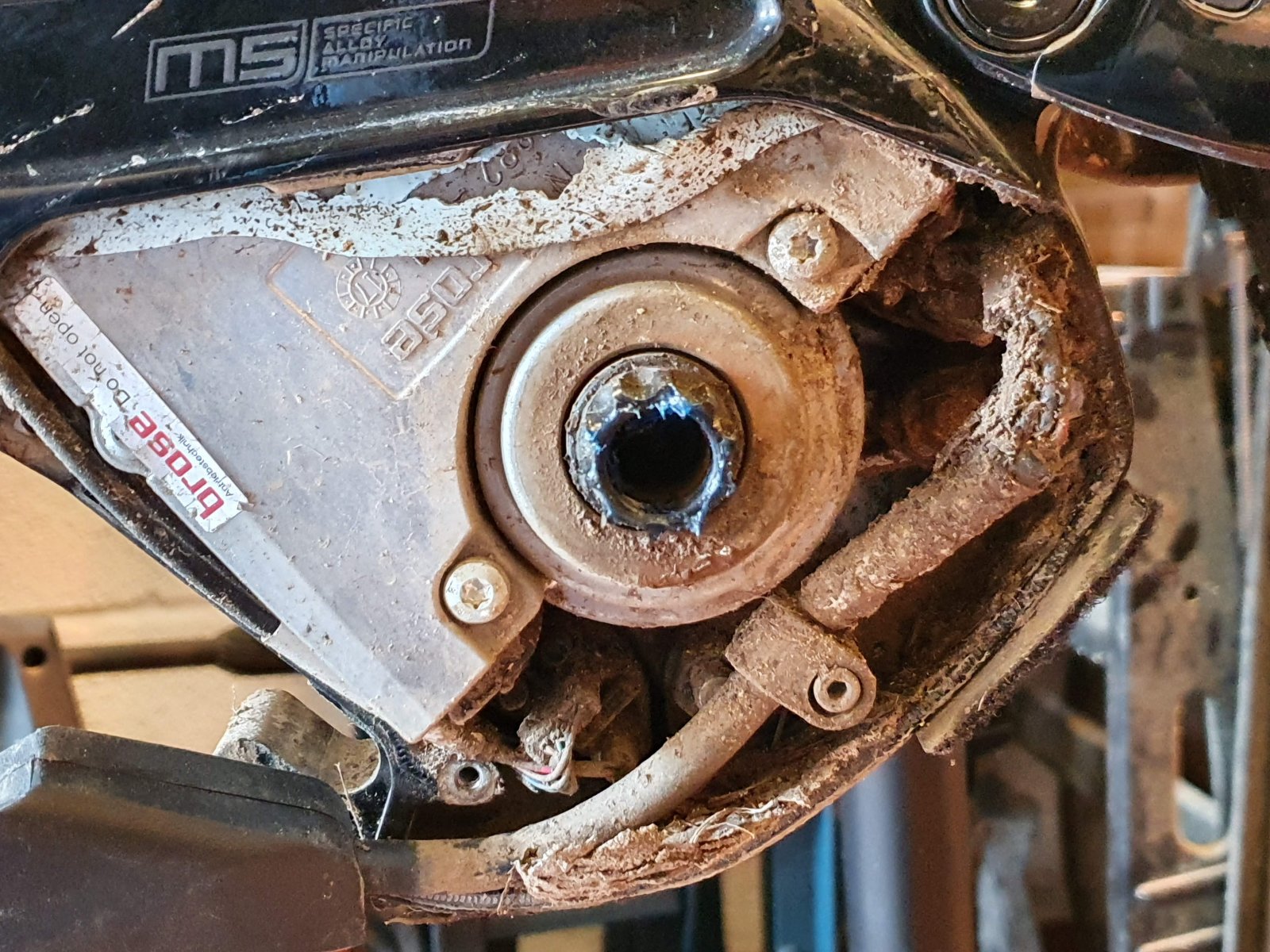

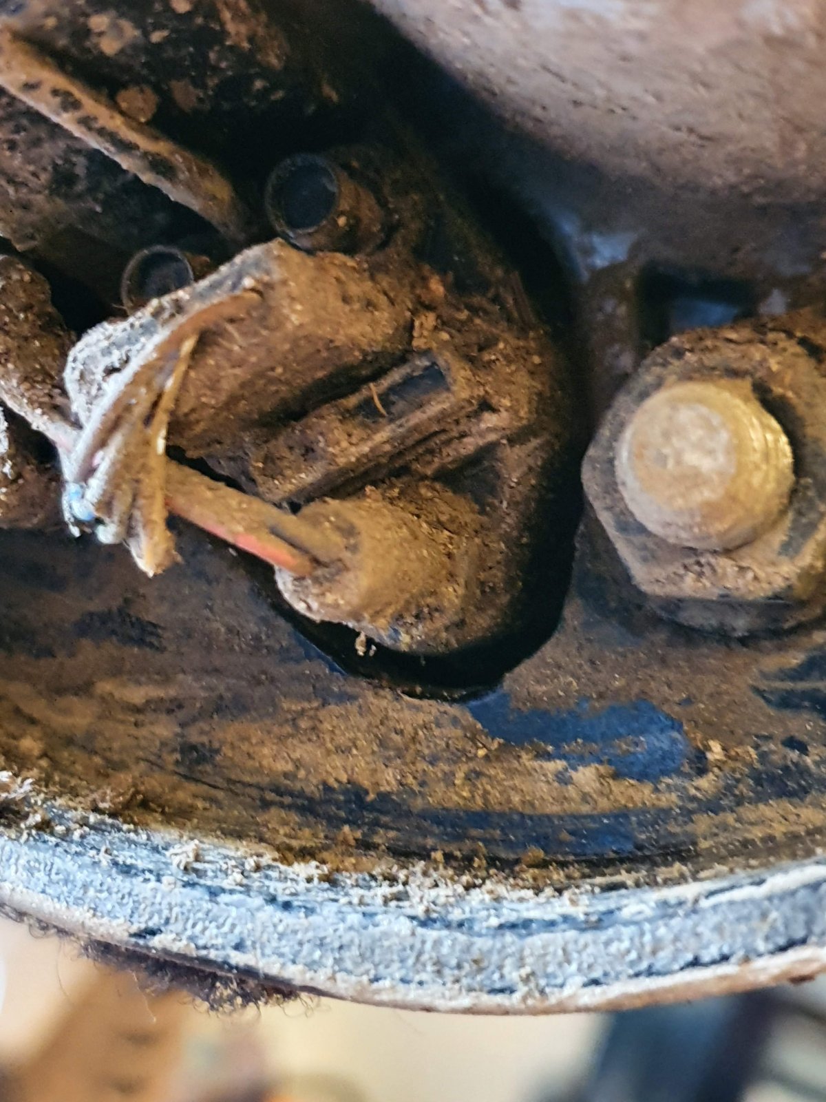

Ricky
Jul 29, 2018
22
27
Wiltshire
Well, I took it all apart, and there was some fairly significant corrosion. All of the mud had made it very damp. I've cleaned it all up, and used contact cleaner along with dialectric grease when putting it all back together. Fortunately, it's all workig now with no problems. I think I'll be taking better care of it now!
