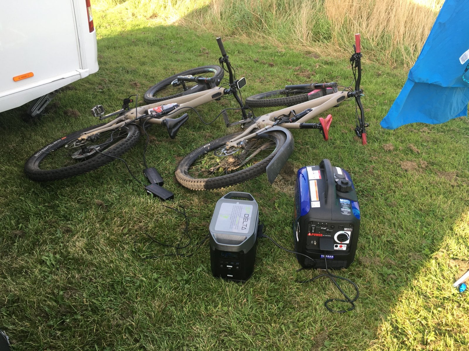

2x levo with 1200w Ecoflow Delta and a 1600w Yamaha gense—not shown is 220w solar panels for the delta
we use this in the caravan when off grid it will run microwave the Jura bean to coffee machine it
Solar panels work only really well on a good sunny day - yes you get some watts on overcast days (usual for UK) and my panels are very efficient and so on a good day it’s 180watts(you never get the full capacity) - cloudy try 20watts so solar on its own won’t cook it as a battery recharge
The battery packs Delta Jackery etc are restricted on car charging to around 120-150w outputs so not the best use of the can/van/truck unless you are moving
The Delta will happily charge 2 bikes in the same time as if plugged to mains but when off grid (OG) once those 1200w in the Delta are gone and it’s a filthy day with more riding to coming - despatch the Yamaha and that’s where the Deltas party trick appears
0-80% charge in a hour when charging off mains (or the Yamaha) or 90mins to get to 100% on Delta
Yes it’s not cheap but these battery packs used as a support change life on and off the bikes and keeps my wife post bike in the style she’s accustomed - still working on her for a Unimog expedition truck however
