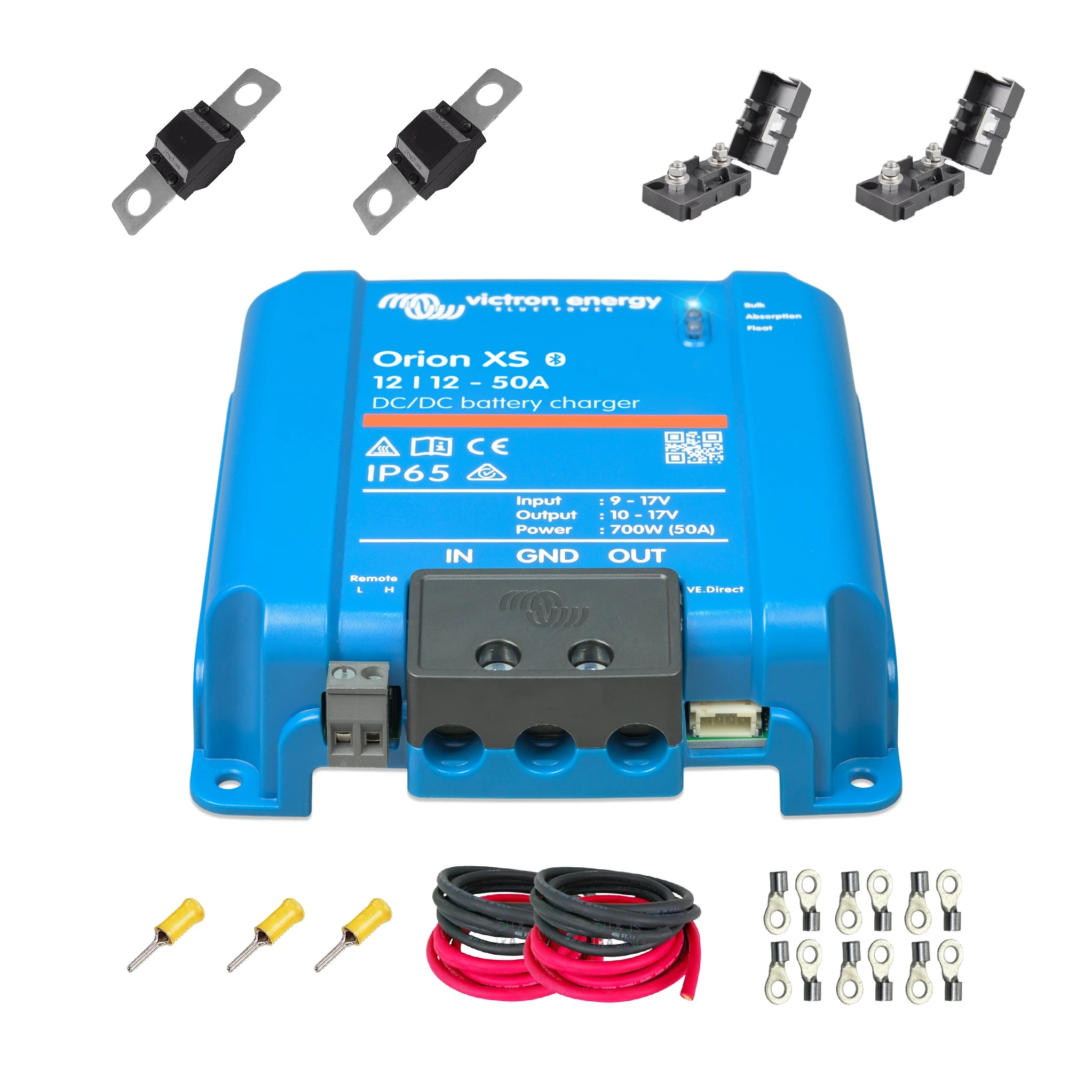

well, if you're interested this is my current shopping list. that all fits under the passenger seats of my transit custom.
DC-DC charger - works for smart alternator:
battery options:
3.6kw setup - 2 x 12V 150AH POWEROAD BASE LITHIUM LIFEPO4 BATTERY - Alpha Batteries
4.8kw setup - 2 x 12V 200AH POWEROAD BASE LITHIUM LIFEPO4 BATTERY - Alpha Batteries
they claim more wh values on these batteries but im not sure why TBH
plus the inverter and DC distribution of your choice.
its very rare that I would need power away from the van and there are always extension leads..
plus because i use the van for work and often work in remote places without electricity, I can charge my tools and run extensions if needed etc..

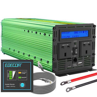

So roughly £1k for 1920Wh with lithium battery and the DC to DC charger.
Which inverter? When I was looking they were quite a bit of cash.
Right now the 2KW Poweroak / Bluetti is £1699, once added up might not be far off that cost?

this is what I was looking to get:
its really only properly economical if you double up on the batteries and double your charging capacity, this is what I plan to do so I can charge 2 x 700wh batteries twice without having to charge the leisure batteries. if you were looking to only have one battery then yes, the powerbank is a better buy considering the flexibility.

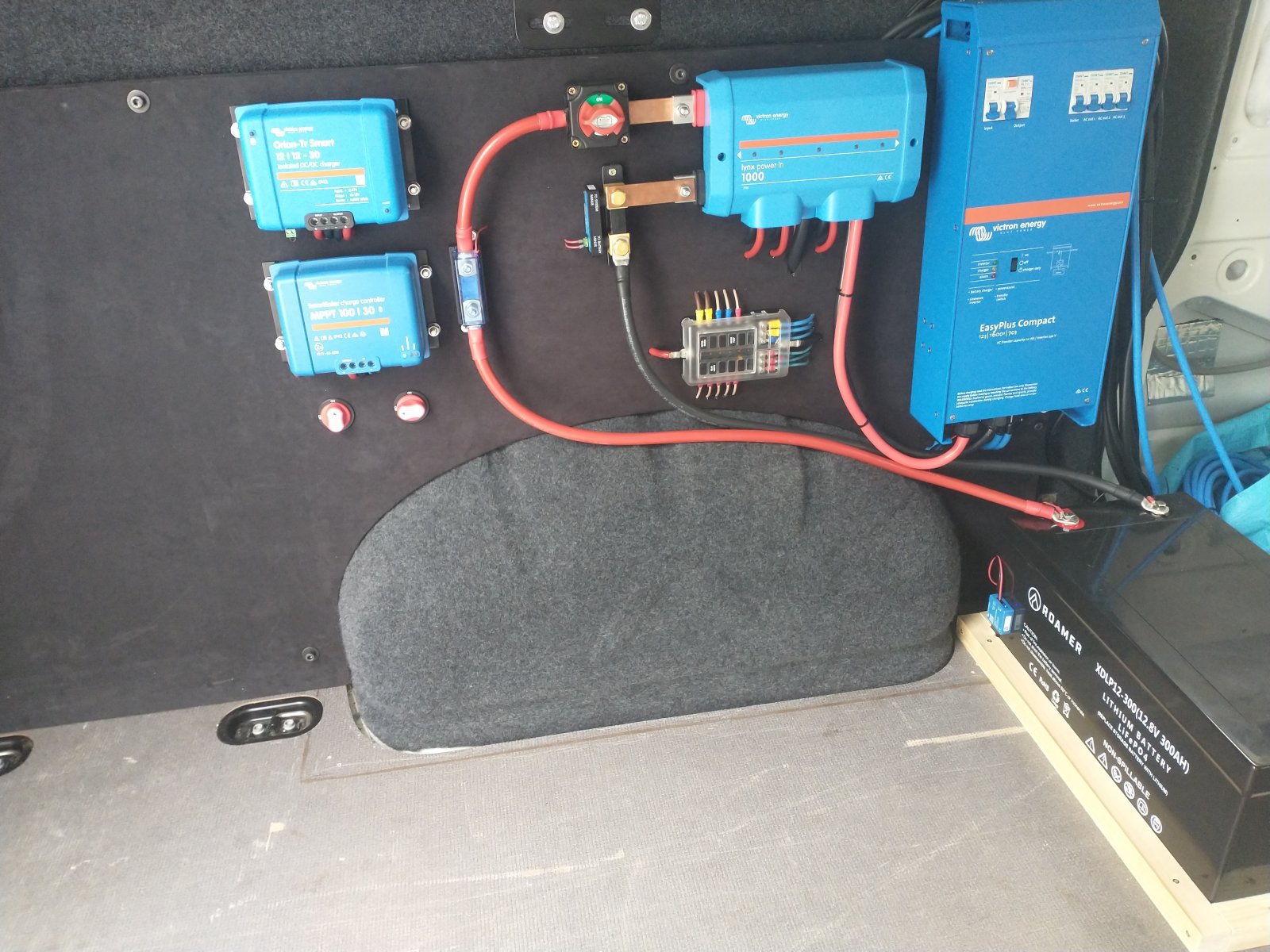

If you DIY it, and it's simple enough. From then on you can add to it as your requirements change.
For a small van I'd go with 100ah lithium which is around the equivalent to 2x 100ah agm batteries, a lot lighter but probably 3x price @ £1000ish
Victron inverter , probably 500-800 although I have a 1200. £300 ish
There's the 240v side sorted.
12 v fuse board for usb etc. £50
Then you need to decide how you want to charge the battery.
I'd go dc-dc charger with mppt solar input, then your battery is charged both ways. £300
If you don't want to fix solar to the van just use Anderson plugs to give a quick connection to a portable panel. Probably £100
Budget for fuses, cables & breakers £100.

I like the idea of these but what put me off was the fairly low Wh ratings for charging ebikes if you are going to be away for more than a weekend and had multiple bikes/batteries. I thought you were a bit limited with where you could keep the solar panel safely too.
I've gone down the leisure battery route with solar panel on the van roof and dc:dc charger.
300Ah LiFePO4, 330w solar panel, 30A dc:dc in a VW crafter
