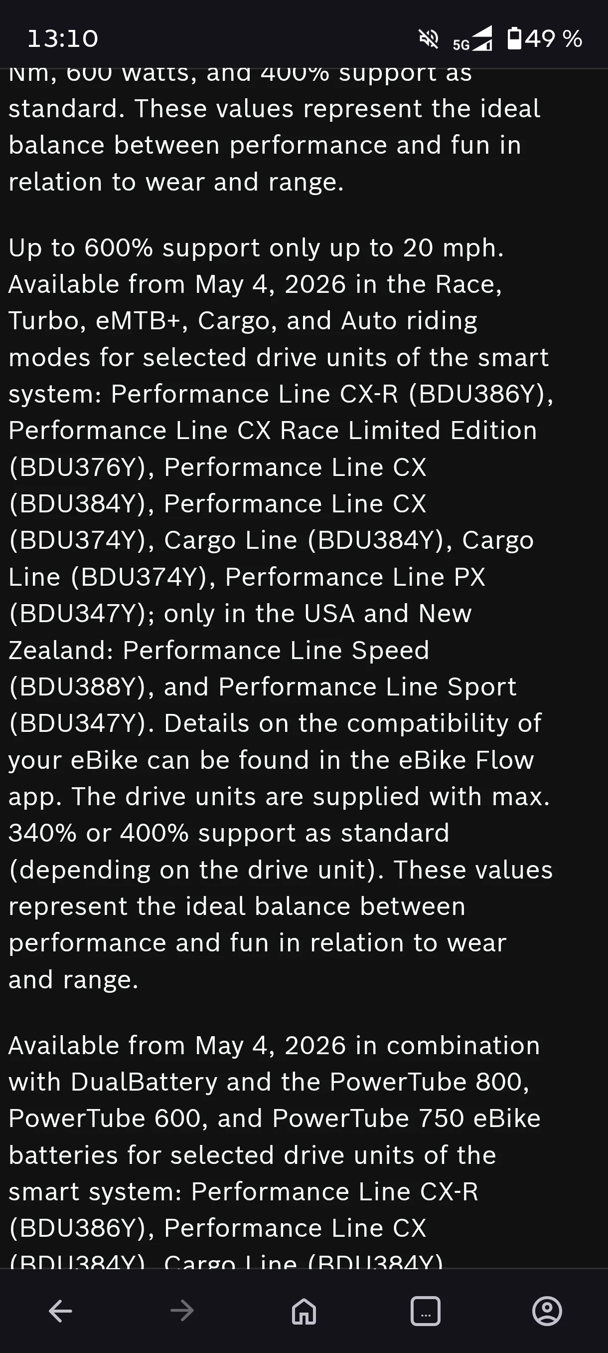

Question for everyone with the US Sofware... Is the support at 600% now available up to 20 mp/h, or like in the EU version, only up to 15 kp/h?
?? So just to be clear... are you saying that on the US software the bike still pulls hard with full support all the way up to 20 mph, or are you saying you don’t really notice the new 600% support at all?
I'm saying i'm not seeing the second part of the update.
600% support corresponds to +5 assistance (in EMBT+ and Turbo, at least), and is already available in the “first part” of the 2.0 performance update.
The 120Nm option is only available after you complete the “second part” of the update (after 24h, through log off/ login in the Flow app, or through other alternatives such as cache/ app deleting and reinstalling…)
As far as I can tell on my Gen 4 with the US firmware (I don't have it on my Gen 5) when I tested in Turbo with 600% assist there was a very noticeable drop off in assistance at 15 kmh, my guess is it went back to default for the remaining assist up to 32kmh (20mph). It looks like as per the info from Bosch the 600% is only good till 15kmh and assume the same for real US located bikes.
Okay...Thx.
What confuses me now is that Bosch’s own information seems to say something different. According to their official text, the US version should provide “up to 600% support up to 20 mph”, while the EU version is limited to 15 km/h?🕵️
Okay...Thx.
it's a typo. In some other places Bosch mentions 9.5 mph
