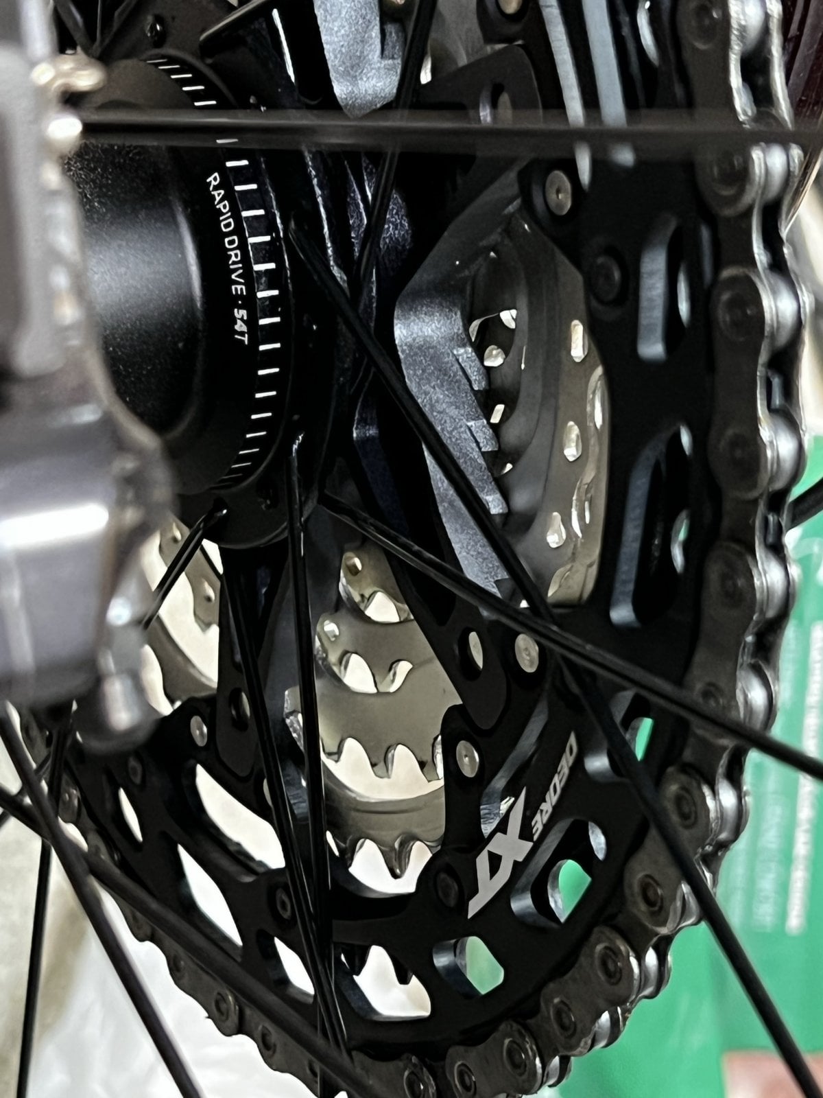

I’m eager to try this upgrade, because why not! I was surprised to find out that my 22 Rail 9.8XT also has “Rapid Drive 54”. Guess it was a 9.9 upgrade?
Are all the part numbers listed in the linked YT video above compatible with my bike?

May pay to double check that as the 2022 rail 7, 9, 9.8 and 9.9 all come with rapid drive 108.

Sad news. My 22 Rail 9.8XT does in fact have the rapid drive 54 hub. The Trek websites (CA and US) were updated to show that this model comes with the 54T.
If I just purchase the part numbers listed in the YT video above, will it fit my model?
